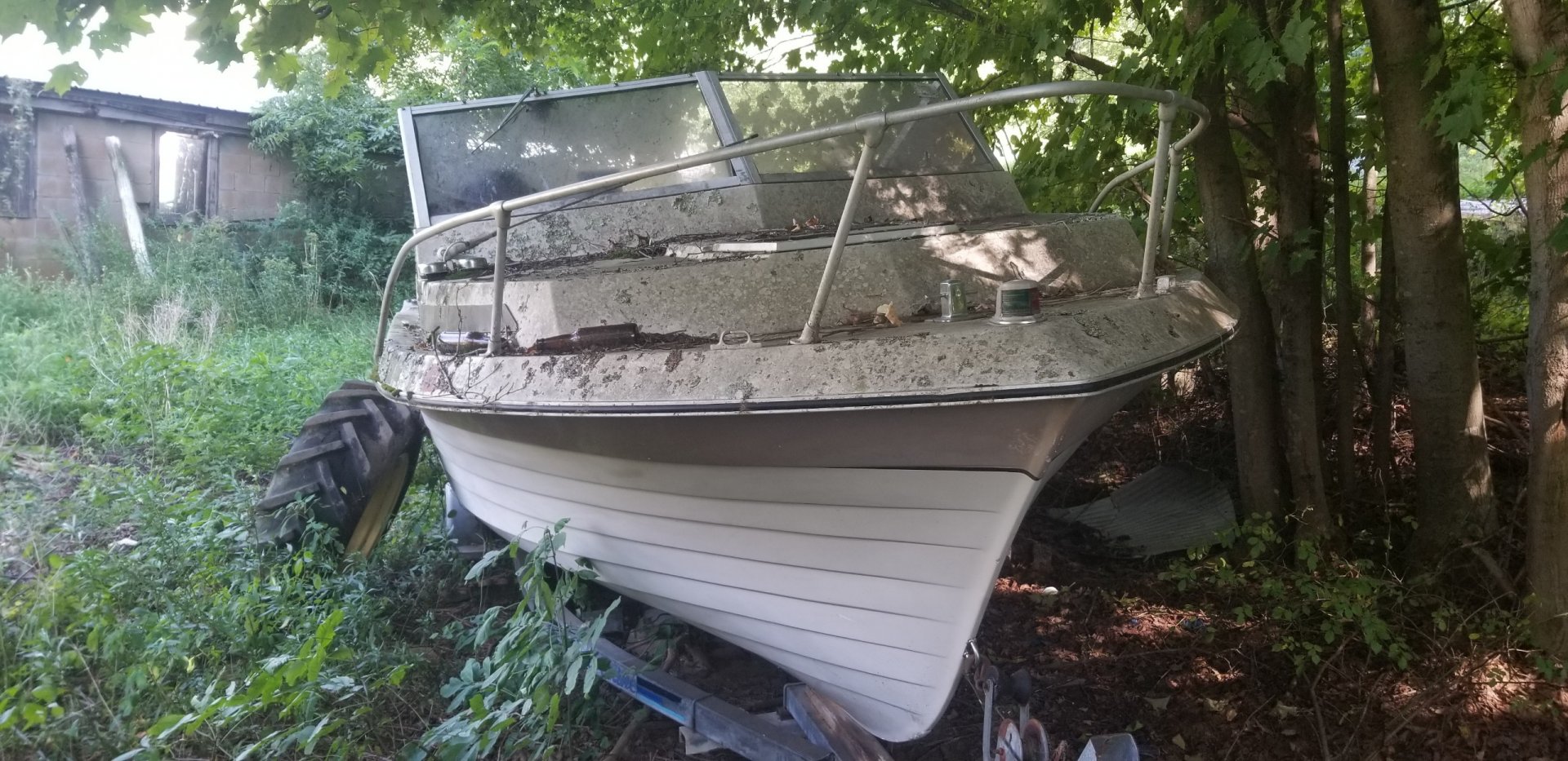

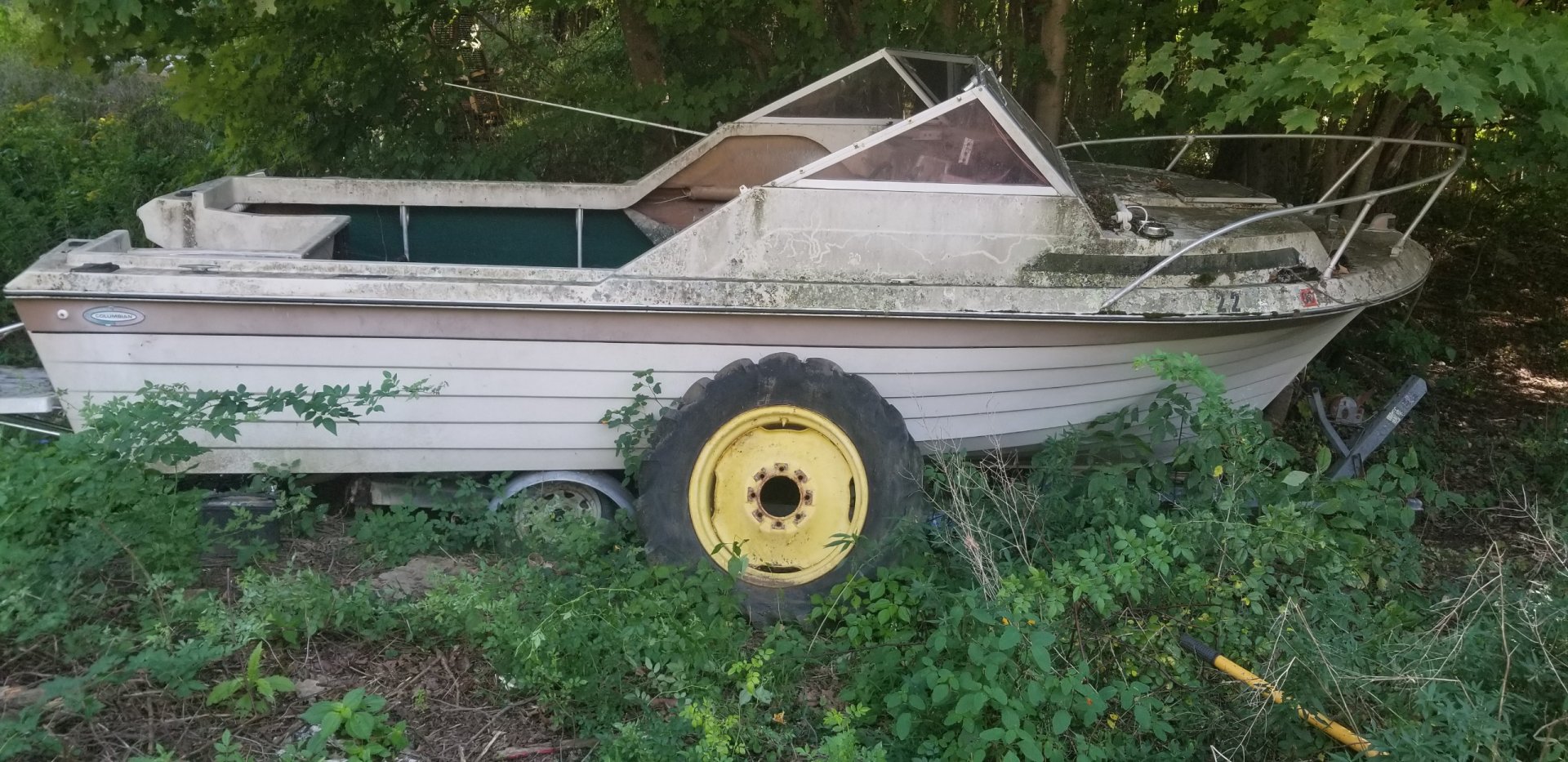

    Columbian was a small boat builder based in Meriden CT. This boat is a 1977 Columian 2000c. The previous owner told me that Columbian licensed the hull mold from Grady White. I have no idea if that is true or not. But it does have a strong resemblance to many Grady White lapstrake models of that era. I have been unable to find any info or photos of any Columbians other than the Fury and a tri hull model. If anyone has any info I would greatly appreciate it. Especially any photos of this models interior.
    Obviously this will be a full restoration. I do not have photos of the stringers at this time. The boat is on my friends farm so I am not able to take any at the moment.

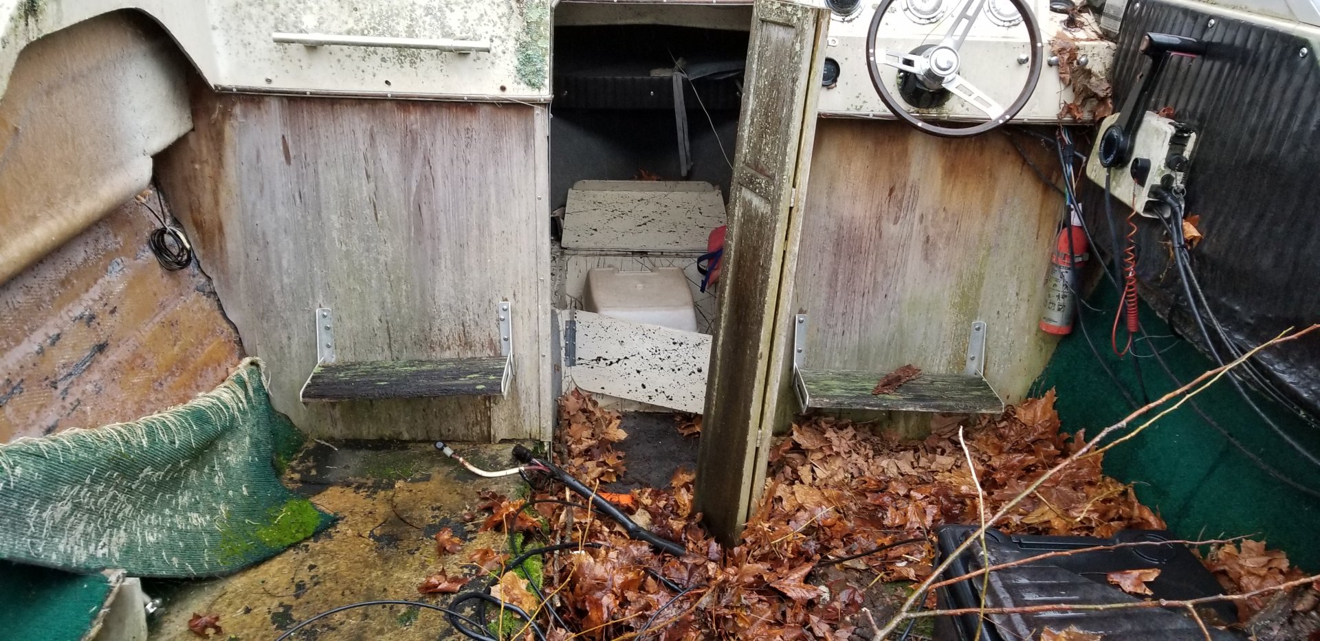

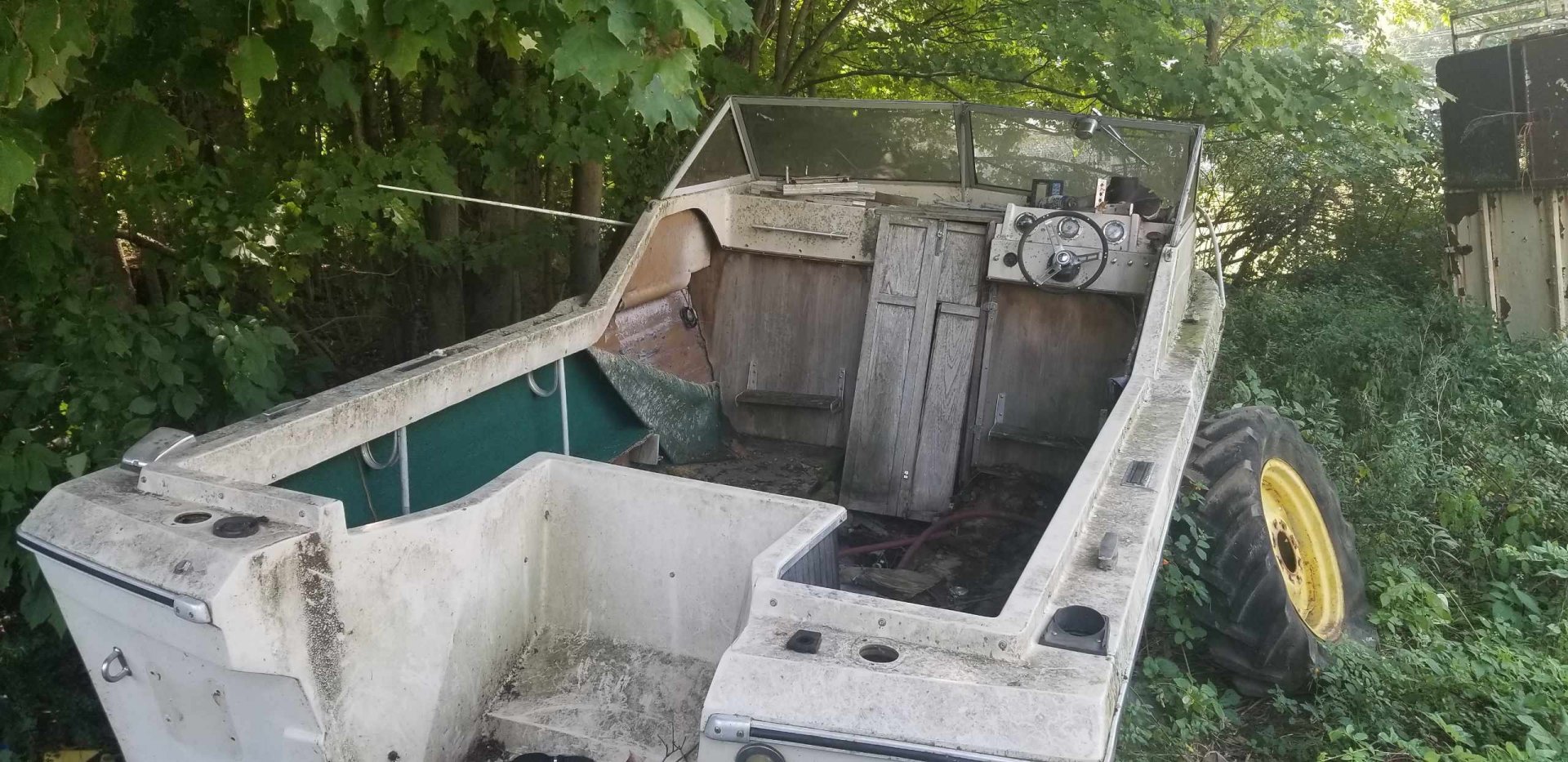

    Thank you for posting these photos James - I see what you mean re how you will doing a full restoration, but it should be well worth it, as she does look like she was a very nice boat originally. The simulated lapstrake 'planking' in the topsides have a benfit in that they make the hull much stiffer compared to a non lapstrake hull.
    It looks like you will have to replace the bulkheads at the forward end of the cockpit as well - and take up the cockpit sole to get to the stringers?
    I presume that the sole is fibreglass over plywood - what sort of condition is it in?

    The Bulk head will be replaced. The stringers stop at the bulkhead. Everything from the bulkhead back is completely rotted. The deck was removed by the previous owner more than 8 years ago that is when i purchased it for the trailer it was on. Everything in the cabin has remained dry and therefore not rotted. I will have to look at the construction a bit more to see if any repairs are needed there.
