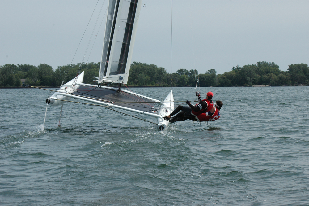

    Just so we're clear on this, we did do the veal heel Doug.
    here is Rohan on the yacht himself with either me or Rob crewing for him

    Magnus that looks like "windward heel" to me-not veal heel. In any analysis of how veal heal works on a monofoiler it is clear that one of the major advantages is that the CG of the hull and everything else shifts markedly to weather-at up to 30 degrees of windward heel. That didn't happen on Rocker as best I can tell.
    A further look at it shows that the weather shift in CG can result in a 30-40% increase in RM-I don't think that happened on Rocker, did it? *
    Measured off your picture it looks like the weather heel was 9-10 degrees maximum. Considering a Moth does "veal heel" at up to 30 degrees I'm thinking what you show is a variation on weather heel.
    Another critical point in describing veel heel is that the CG is markedly to weather of the immersed lifting foil-not the case here-since the windward foils are to weather of the CG!*
    * 9-24-11--See Magnus Clarke's reply ahead. He says that the windward wands were disconnected so that those foils were not providing any force up or down. Therefore, with the leeward foils doing all he lifting the CG would definitely be to weather of the center of lift. But is that veal heel? A "normal" cat has the exact same relationship when the lee hull is doing the lifting. So RM in the case as described by Magnus would not exceed the "normal" RM of the boat except by the degree to which the CG is moved to weather(as a result of 10 degrees of weather heel) of the position it would have on a "normal" cat with the lee hull doing the lifting. And maximum RM would be far less than that possible with both wands functioning as designed. Veal heel? Its still sort of a grey area as applied to Rocker, in my opinion....

    As for the Veal Heel thing, you can characterize it how you wish, I leave that to you. As for me, having sailed with Rohan on the Rocker, I persoannly kind of thought about that as being a veal Heel, in as much as Rohan was on the boat, we were sailing as heeled to weather as we could get the boat. And to be clear, the weather wands were disengaed for that particular test, so no the weather foil was not making the boat stand upright, we were flying on the lee foil alone and dragging everything else around with us.
    So actually the CG of the boat was well to windward of the center of lift of the boat, and yes it dod improve the performance of the boat to windward and according to Rohan himself, it may well have perfromed well, eventually, had we continued to work at it.
    Since then I have done the math on the CG of the boat, inclusive of vectors pointed skyward etc as the boat rolls to weather and my CURRENT conclusion is... a C-cat, heeling to weather, trying to fully foil, does no better than an archemedian set up. the limits in my tests are length of foils, after 6' long they cannot be made strong enough without being quite huge, fat etc. As such in my most recent experiements, the boat can only heel 10 degrees to windward or so and still fly, so a CG adavantage is gained, but there is too big a trade off having to have the lee hull so high in the air, so the roll forces applied to the boat tend to neutralize any benefit gained by heeling the boat to weather. Thus it comes out as a bit of a wash so far.
