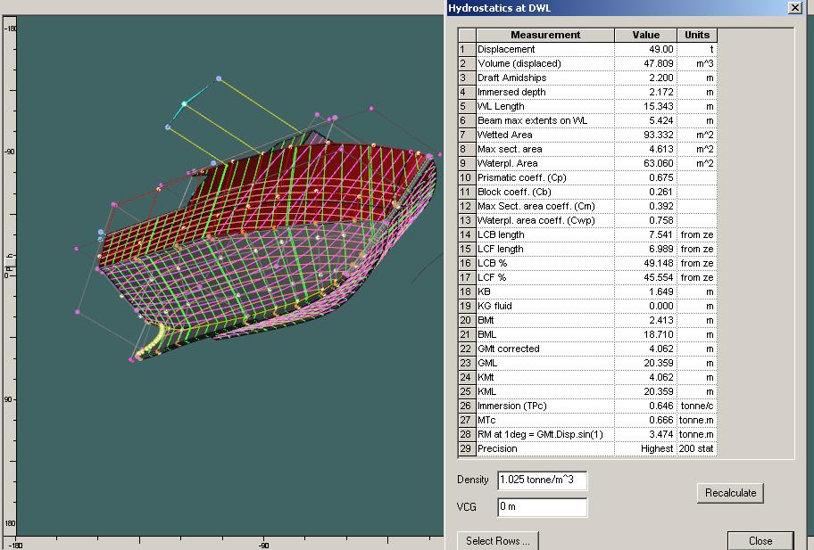

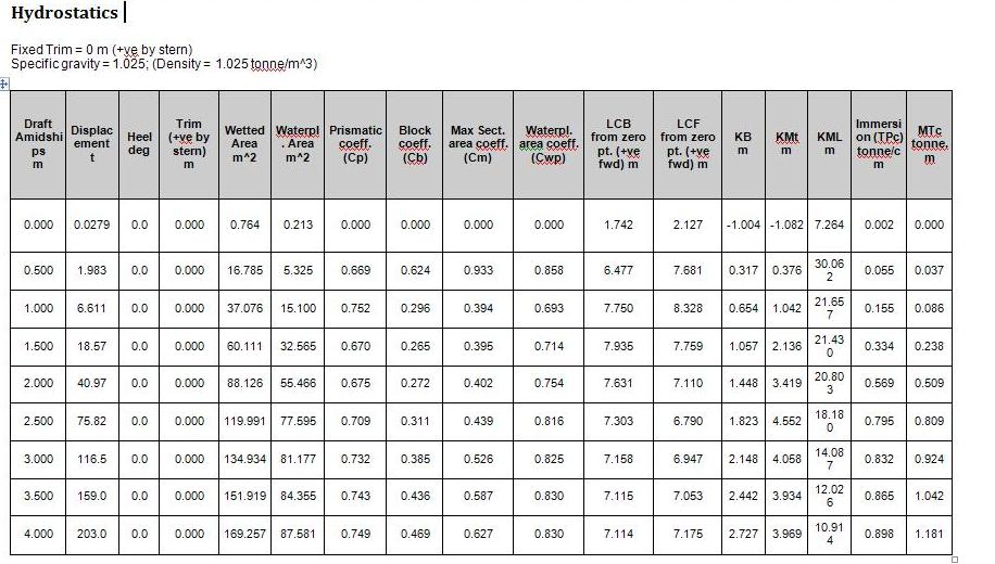

    Hi,
    I was able to open your model in Maxsurf as well as Hydromax. By default it shows the design waterline at 2.2 meters in your model. Whereas the results given by you earlier are for a draft of 0.5 m.
    I have not modified anything you model. I am attaching here the results from Maxsurf and Hydromax.
    It appears the baseline for the model is set at the lowest point of the model (i.e. skeg) and not the lowest point of hull. So when you specify a draft of about 0.5 from baseline, that's the hydrostatics you will get. For example have a look at the Cb value at 0.5 draft (0.624) and at 1.0 m draft (0.296).
    Also, for Maxsurf, as far as possible try to use the minimum number of surfaces. That will reduce the headaches. Model only what is required for the purpose of "what Maxsurf does".

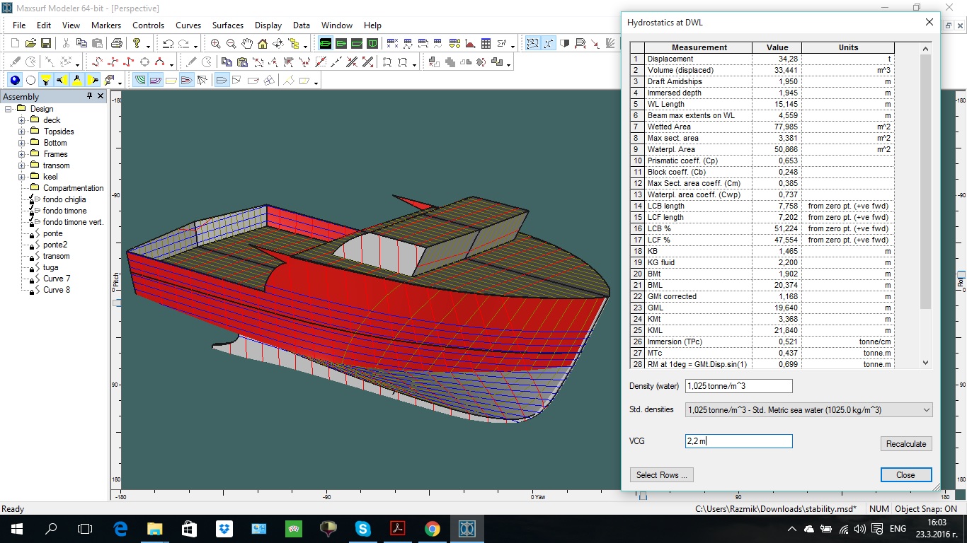

    Hi sn1987,
    You should know with an absolute accuracy what you want to receive at the end of designing.
    Length of your model Loa=17,453m. Total displacement about 9t so that is impossible to be.
    Model which you was made, precisely responds on calculations made devudegoa for specified DWL-that is at draft=2,2m and displacement=48,82t.
    But if the boat will be from plastic, I think that total displacement is necessary to be less 49t. Approximately 34,28t at a draft =1,95 m. At VCG=2,2m it is received GMt=1,168m.
    I do not see eny problems in the skeg!

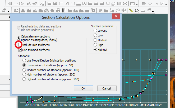

    Hello guys,
    I think to have found the problem :D After I tryed many times, I changed one option in "Section Calculation Option at maxsurf stability start. In particular I uncheked the option Include skin thickness in Calculate new section sub menu and everything work now. Anyway it is more clear in the attached snapshot.
    Instead about the material construction of the boat I would to build it in plywood's mahogany and epoxy. The boat is a fishing vessel and I 'm at the early stage of the design, then the real draft is unknown at the time. It should be approximately 2 m but I don't know.
