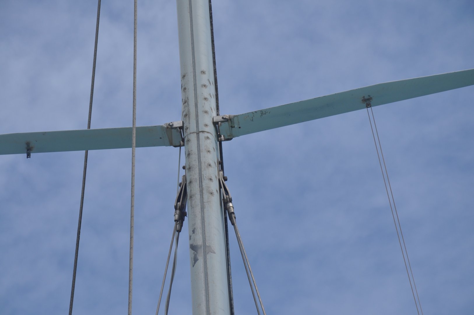

    Just in case like me you are interested in two pieces of mast
    This is 1980 boat with 47 ft mast joined at 40 ft
