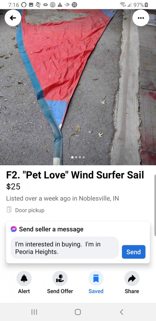

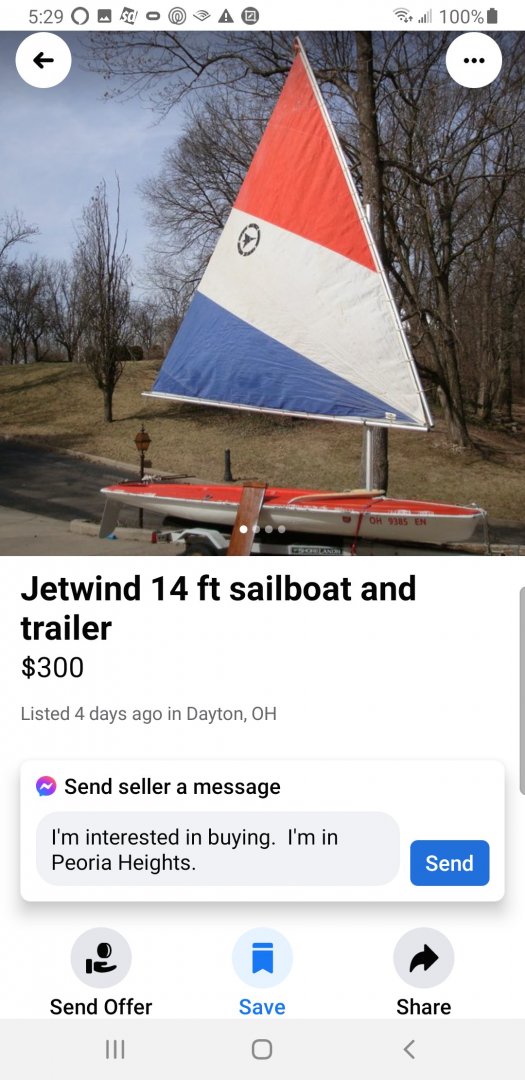

As i get my feet wet. :) I'll be able to improve the design. Probably buying used will be cheapest/best.
Saw this small sail for $25. Was gonna buy but guy outta town.
Have to get clearance for two bikes & sail. & like to potentially use as a dinghy if i get a bigger sailboat.

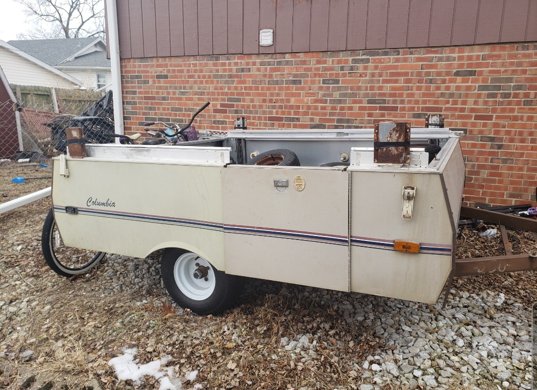

Here's kind of my original brainstorming thread:
Boat camper topper to haul behind prius https://www.boatdesign.net/threads/boat-camper-topper-to-haul-behind-prius.66685/
Trying to get captain license.
Trying to use boat for roof for camper. I'd have to invert a monohull to get space to sleep in. A catamaran hoping will fit on top of camper i already have. & be able to use the boat as a roof. & use catamaran deck to transport bikes.
Altho just got home from traveling & prius 12 volt battery dead. So adding to my to do list. Have to repack the bearings on trailer. & install light kit/turn signals. Boating season coming quickly!
