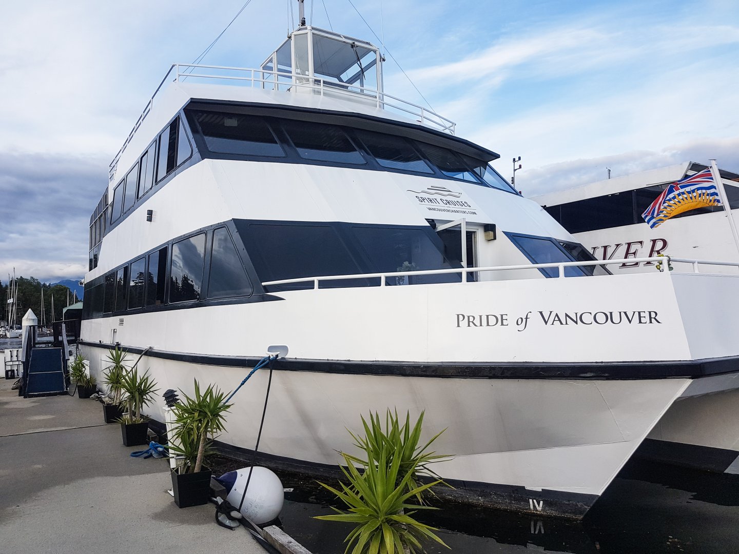

    A photo of the Cat mentioned. Does various types of cruises (dinner, wedding, etc) in Vancouver.
