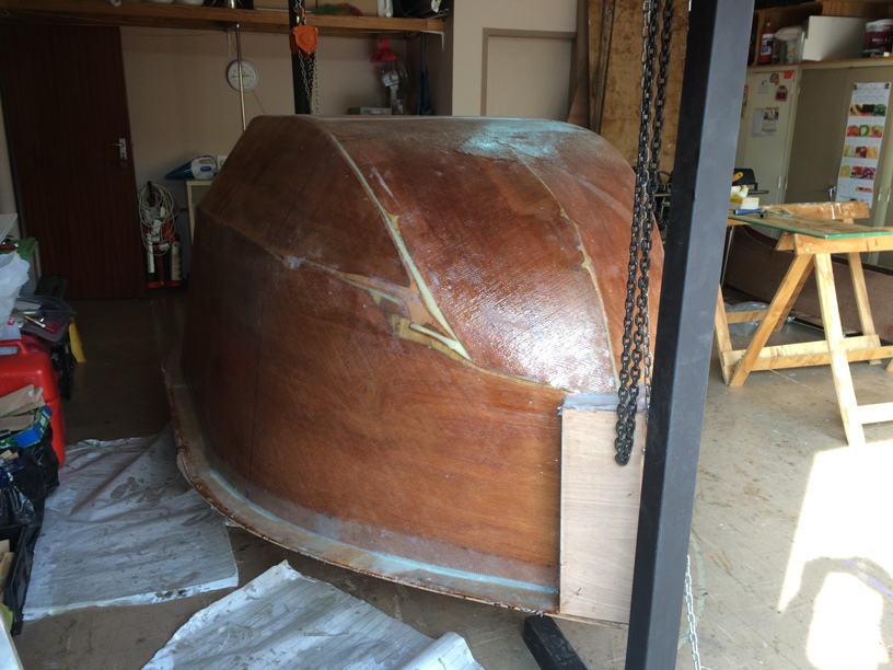

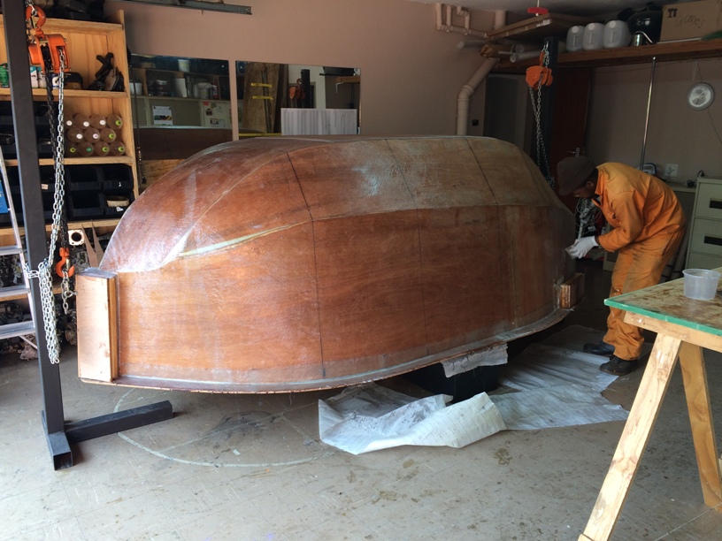

    Well finally a warmer day, our temperatures have been below 4 deg celcius and epoxy takes forever to cure. So an nice warm day today and there the outside of the inside hull ;) is glassed.
    Now its full steam ahead with the "roof" :)
