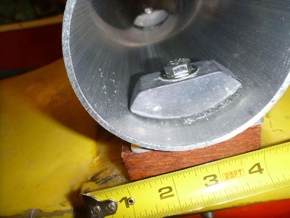

    Flados, aye...but I keep running into little things I forgot about. Like stripped gudgeon screw, or setting hulls level to place aka, as 16 will float lower...
    Here are two more pics...the casting in the aka tube and separated hulls...not even, and have to even to attach beam...little surprises...

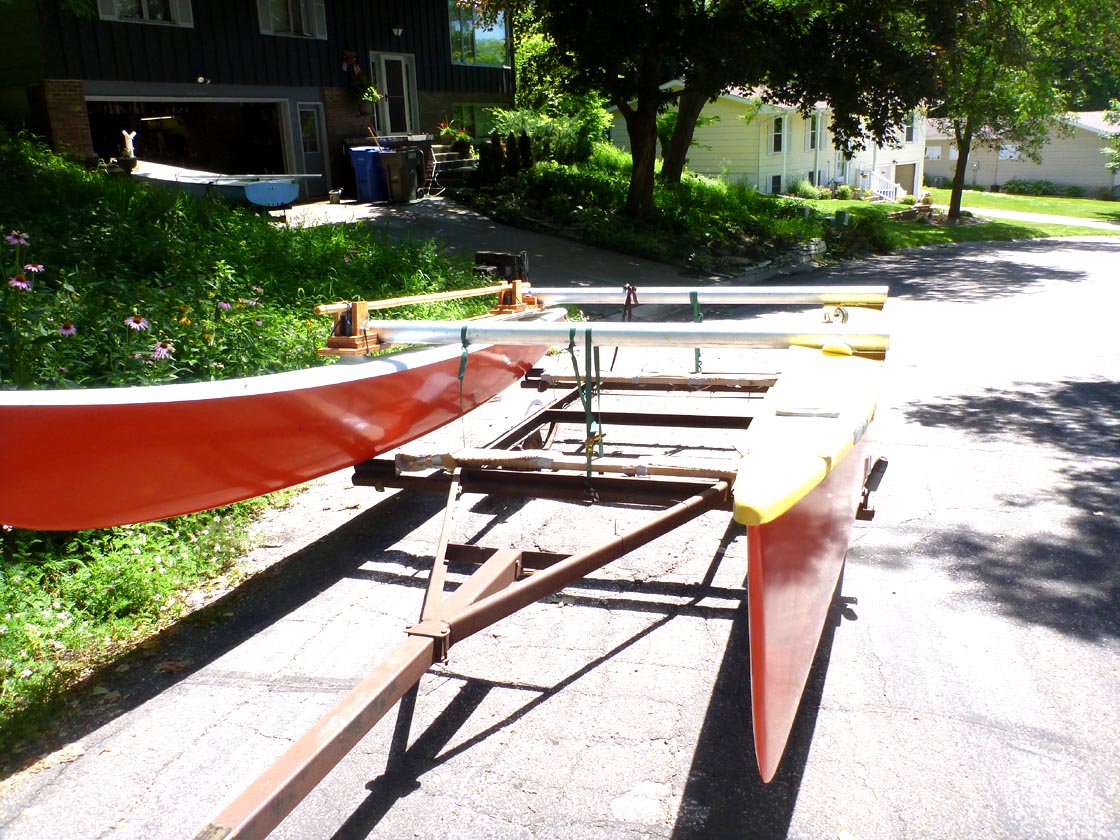

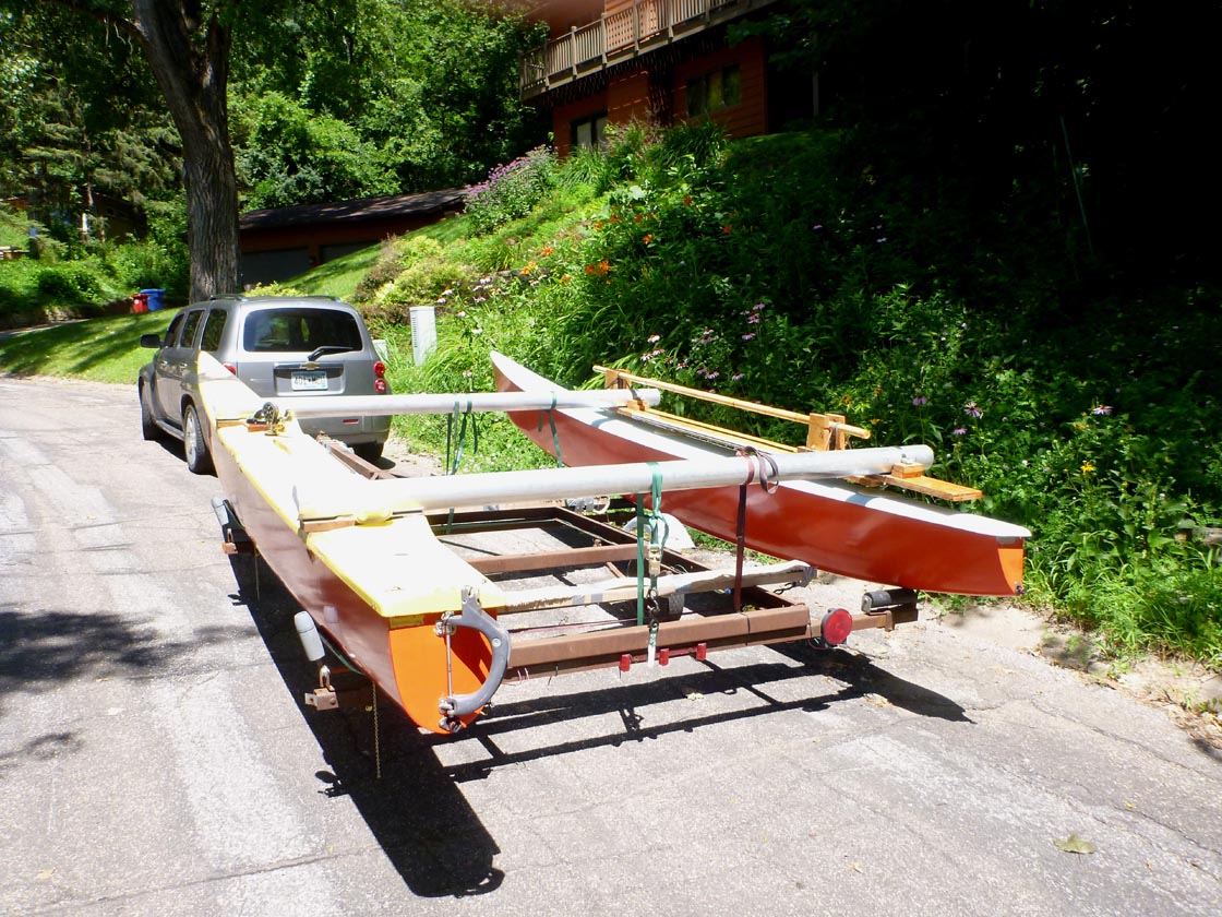

    BobBill Senior Member
    "New Malibu Outrigger"
    FWIW. In for penny, in for a pound.
    Finally out of garage, outside. Have to craft outboard support, starboard rail and do spars, but will go wet today, after visit to welder and big box for some hike boards...also adding tramp for underneath which is coming from UT shortly.
    But, as it is most is redoing mistakes...but adventure continues. More pics but this is basic info...hull was reinforced with carbon and mast step redone in T6, which I might have noted and stubby has stay and 2-4 shrouds. If craft functions as a "5ksb" as planned, jib off a bowsprit in spring, maybe foam outrigger, depends.
    BTW, the mast step pic (last) looks odd cause I forgot to wipe off wax floor wax release agent and did not tell welder...my bad.

  12. BobBill
    Joined: Oct 2009
    Posts: 823
    Likes: 19, Points: 18, Legacy Rep: 157
    Good point and thought of it when folks here suggested I use stays...
    and I will admit I am sort of punting...dealing with what I have...and save blocks and most hardware and the T6 tubes, all is recycled (en vogue-word for "old used stuff.")
    I know the rig must be balanced...what is not shown, cause not yet crafted, are the two port hiking-back extensions...planned to fit into beams and connect by 10 -foot mahogany piece I salvaged from old Chris Craft. I should show it cause it is a ready, stiffened and looks nice.
    The extensions are (at least planned) to be removed to comply with 8' wide road restrictions...one to outside of the extensions and one to outer port edge of main hull, if that makes sense. Will know if nesting tube idea will work, tomorrow...along with outboard set up (light 2HP Johnson) off end of hike boards.
    All is total experiment. Even thought of going with foils, but not a foil fan and way-spendy...this is under $3K, 5ksb project, so far. I keep fixing my goofs and praying the effort does as planned...4ksb minimum...with beer.

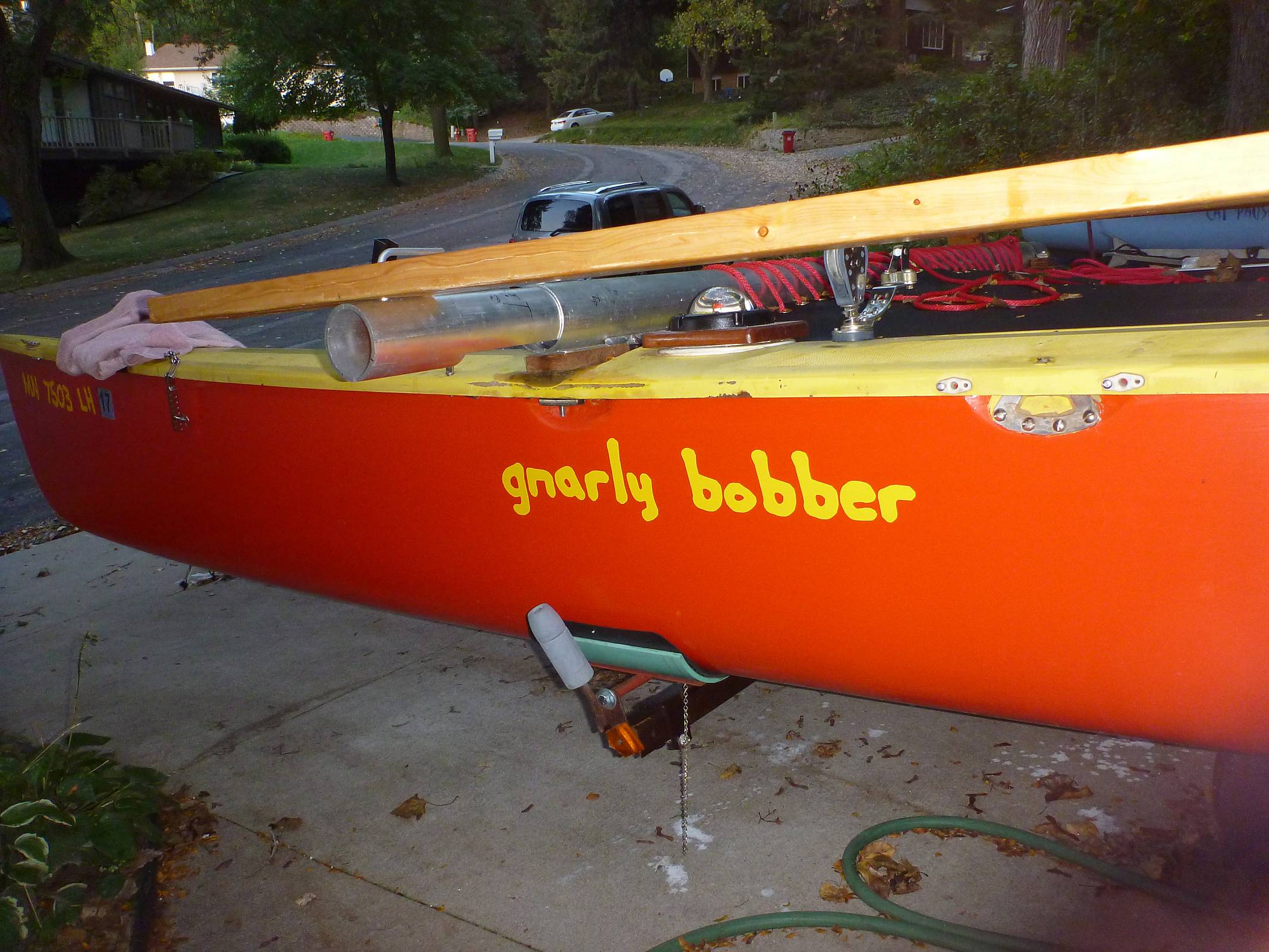

    Peter...thanks and yes, but I did not sail it...too windy every day I wanted to go...was afraid I'd break a spar right off the bat and waited. I know all is not perfect and expect a few tweaks will be needed, but 20 knot winds were too much for initial runs...at least to this swab.
    I was holding off posting some pics to be sure things worked...
    Then I had to go to SF and drove. That was three weeks gone, and the weather shut me down.
    I did however float the rig and moved around the lake under electric power with motor on it. Was a pleasant feeling to see stuff worked as planned. Pics of stuff below.
    Had planned to take the rig to Florida but got too complicated...
    But all is well and I now will add a bowsprit to handle jib or reacher...I have the carbon spars, set and ready for warmer weather.
    Pics are in laptop, will post in few minutes...not much left to do really, save some sail work and the spar, unless something happens in storage.
    I might alter a few things, but basically, boat is finished...licensed and awaiting longer days.
    The project sort of takes on a life of its own, as I think most do, and my quick-rig plan became complicated. Little things build up. Maybe overkill.
    I can still lift the boat from either end, and it weighs about 300 or so all up and solid. But rigging on trailer to sail is half hour to 45 minutes, but too late, which is implied by last pic of planned rig.
    Motor mount needed due to harbor rules here and there and changed to electric for less mess, smell etc. I have a pic somewhere of mounted motor and will post, and when I had it out, left camera in car...duh!
    I am still messing with mast step and adding the shrouds complicated set-up but shooting for simple still.
    Oh yeah, pic 3 is motor mount from side, pic 4 shows with tramp on and each rail. The back rest sits on T-6 3.x 1/4" wall T-6 tube inserted into 4" OD x.125"wall aka/beams, and removable to be legal width on road...installed the boat's beam is 11 feet and the plank is held in place by the bent push-in rods you see atop the plank. Port side is simple mahogany rail salvaged from old cruiser, screwed in place.
    Large bolts you see are AL. I tapped the aka to accept hand tightened.
    I had to forego plan to be able to paddle rig easily with tramp installed...it could work with only orig planks and no tramp, but using tramp and some other stuff as spray shield if choppy.
    Runs decent with single rudder, but have yet to tack under sail and have second rudder if that is problem. Thus far, decent going under power using rudder to steer, not motor.
