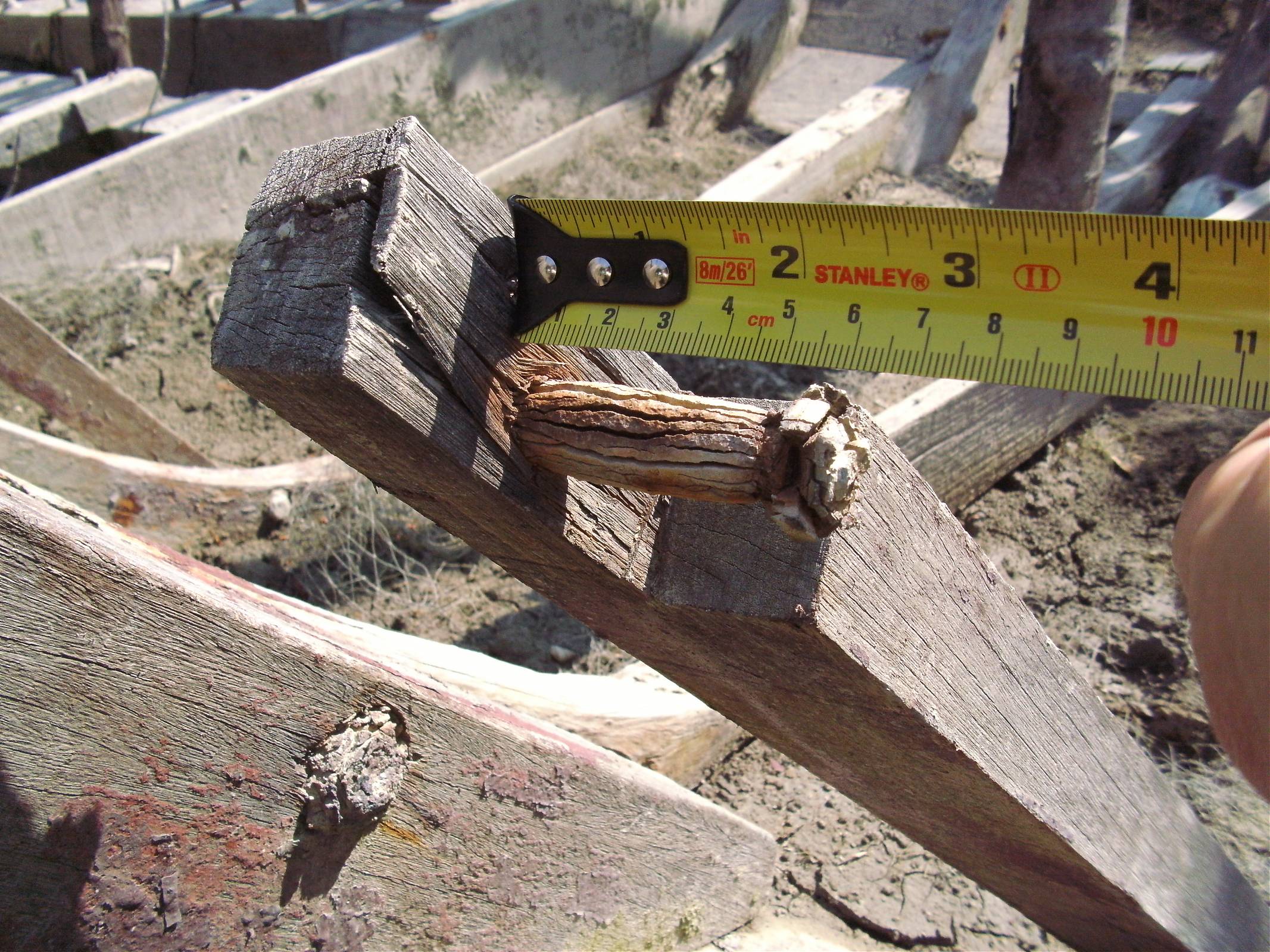

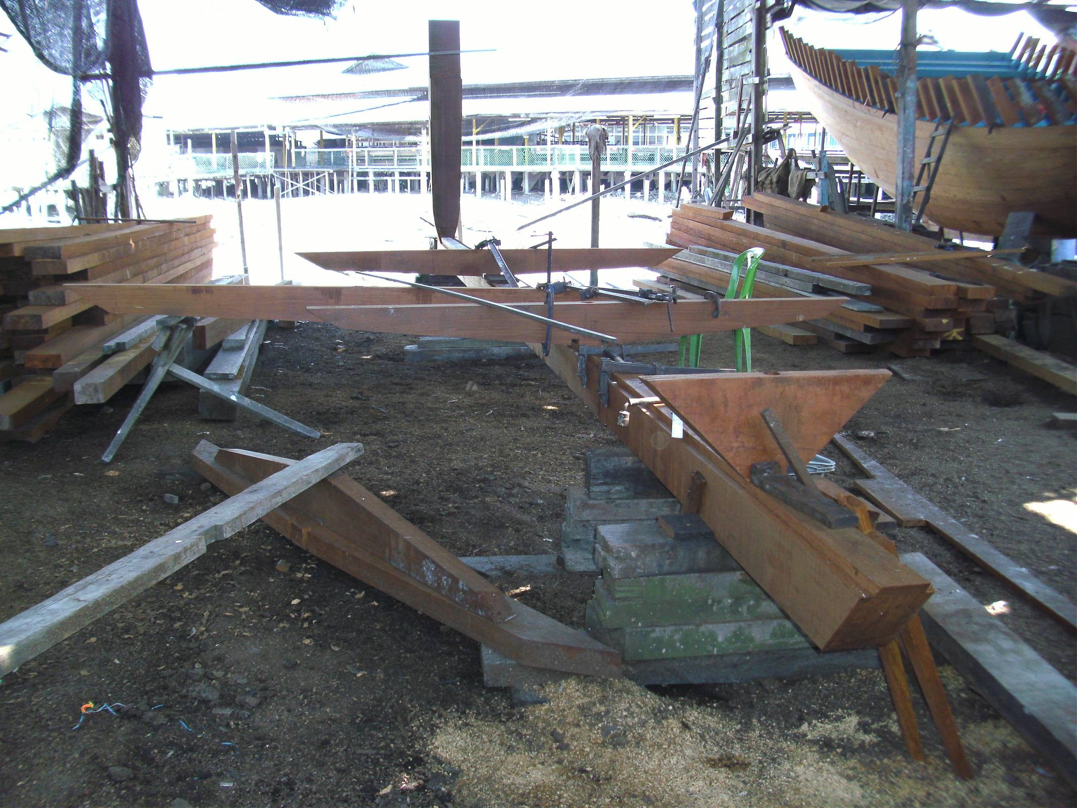

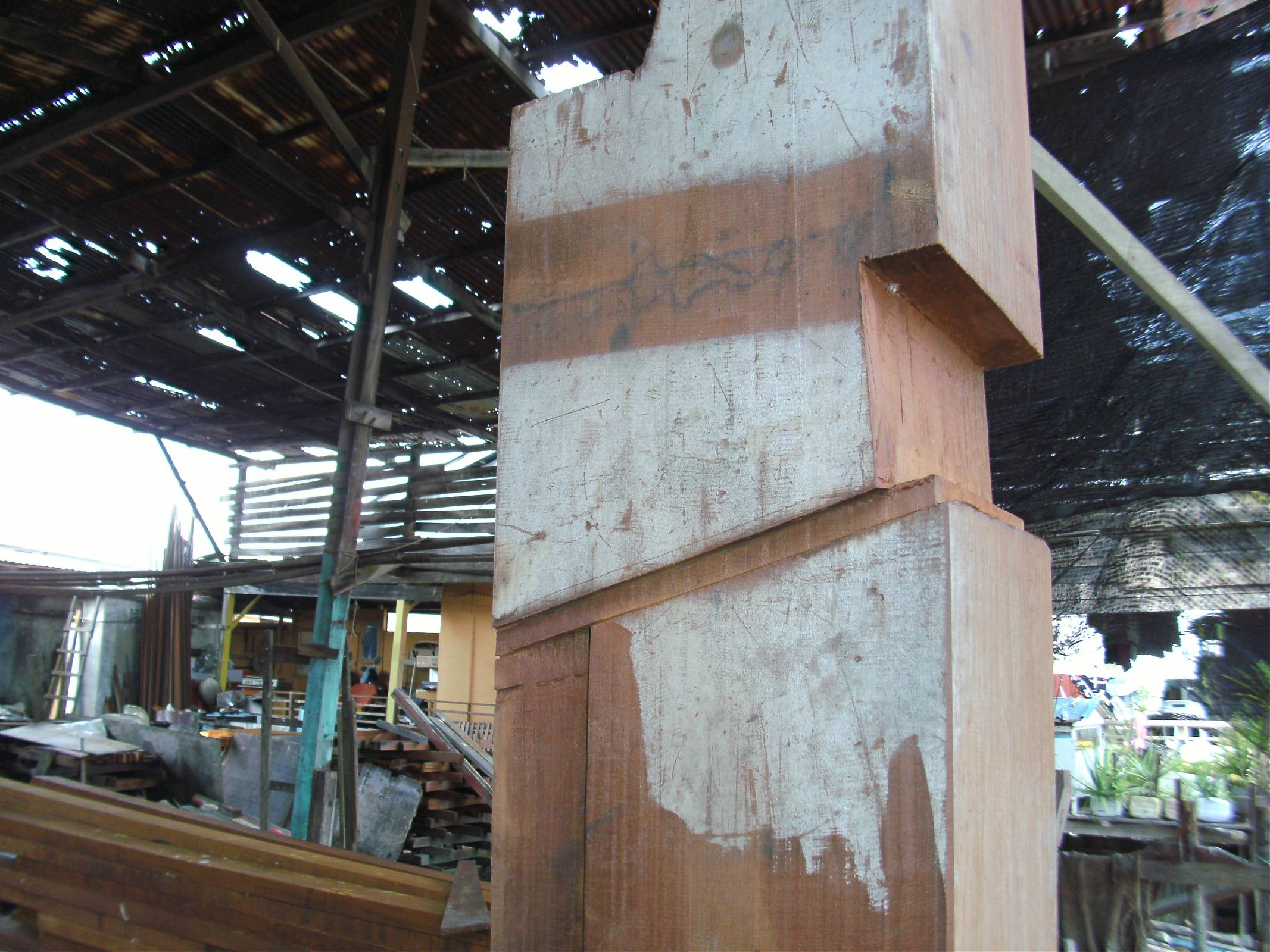

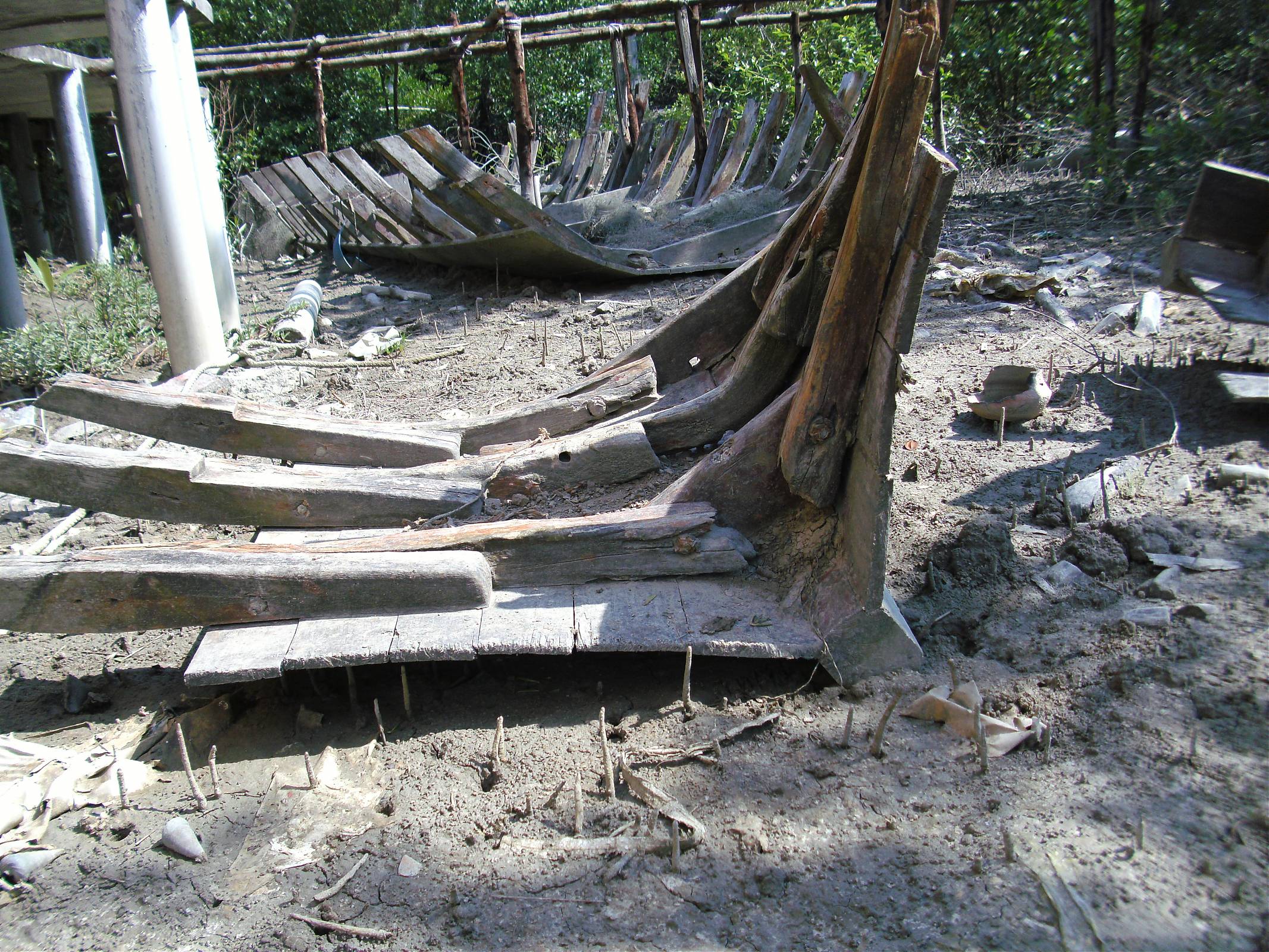

    That looks permanent magwas.
    I mean temporary joints that I could unlock it later for ease of transport and storage. Any ideas?
