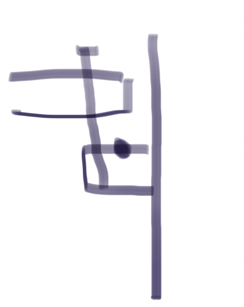

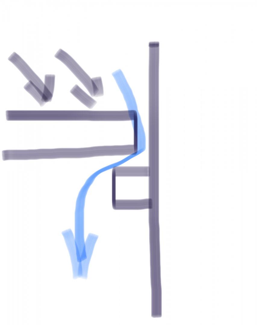

    Any magic on how to keep water out of this seam?
    water is blue
    Panel is kept off for understanding

    Obviously, I can caulk above the seam, but the part is removable, so repeated caulking would get ugly.
  3. fallguy
    Joined: Dec 2016
    Posts: 8,565
    Likes: 1,979, Points: 123, Legacy Rep: 10
    Location: usa
    fallguy Boat Builder
    Maybe surgical tubing will be less likely to leak if water has a path. Still probably need a removable caulking. FB573C55-FCB2-416E-BEB2-EAC76C1F2C83.png
  4. Rumars
    Joined: Mar 2013
    Posts: 2,102
    Likes: 1,340, Points: 113, Legacy Rep: 39
    Location: Germany
    Rumars Senior Member
    Butyl tape is removal is infrequent, proper gasket otherwise.
    Will Gilmore likes this.
    Joined: Dec 2016
    Posts: 8,565
    Location: usa
    I was gonna rubber silence the vertical face above the cleat, but butyl on the face and top seams best.
    I do dislike using it. But it makes sense here. Thanks for the kick in the seat.
  6. Rumars
    Joined: Mar 2013
    Posts: 2,102
    Location: Germany
    Simple usually works until complicated is needed. If it does not work you can always change to a rubber gasket. If the gap between removable panel and cleat side is big, I would be tempted to use a rectangular rubber profile wedged in there to close the gap.
  7. fallguy
    Joined: Dec 2016
    Posts: 8,565
    Location: usa
    I have to use silencing. Most everywhere I am using cloth backed neoprene based on advice from boatsmithfl (David Halliday). But generally; those are not waterproof seams. Places like the cockpit/hull intersection can take rain.
    A bit trickier trying to plan butyl and neoprene, or some combination.
    I wishe there was a sealant I could deactivate with a magic wand!
