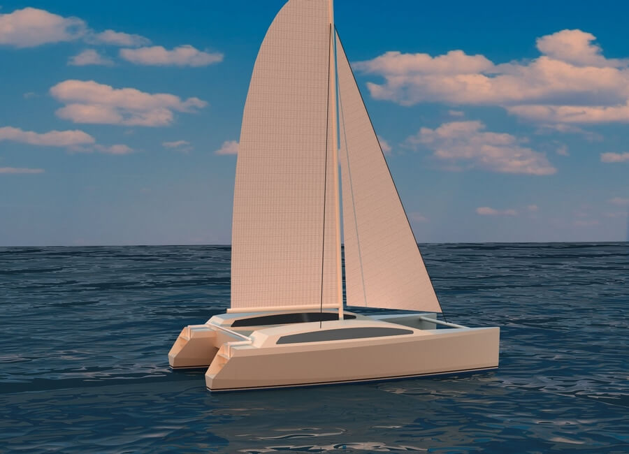

    Catamaran boat design wit Cat 24 - 7,65m the full length of 4,55m width of a sailing boat. All manufacturing drawings is ready, the moment you want, you are able to manufacture. Manufacturing methods, such as plywood on epoxy resin with lamination method will be applied. Especially in the manufacturing itself is suitable for those who want to do a project. You can easily make your own catamaran boat. the project is suitable to build a boat with the plywood panel.

    Hi Umut,
    What means of leeway resistance does the Cat 24 have ?
    Are the rudders retractable or foldable for draft limitation ?
    Are there any Cat 24 built yet ?
    Godspeed !

    Hi Angelique,
    The boat will be a simple structure that can appeal to amateur users. So rudder isn't retractable or foldable.
    The boat is semi planing. If you can use up to 15kn leeway resistance is low.
    We haven't produced a boat yet.

    Hi Umut, thanks for the info !
    Maybe give her some simple LAR keels at the same depth of the rudders, she'll be a bit slower then because of the added wetted surface, but it'll also enhance her windward ability a lot I think. And she'll be able to dry out level on the LAR keels, without the stern raised by fully standing on the rudders, which in the rendered set up looks to me like making drying out impossible at all for constructive reasons.

    A 24' ply/epoxy cat rigged as shown will cost a minimum of $35K and around 12 months work. A big investment to make on the strength of seeing a few computer pictures from someone unknown on the internet.
    Nice pictures though.
    The statement about not needing keels/boards because the boat is expected to plane at 15 knots is a bit of a giveaway.

    Overall Length: 7.65 m = 25' 1 3/16" = 25.1' - *
    Hull Length: 7.55 m = 24' 9 1/4" = 24.77' - *
    Length of Water Line: 7.52 m = 24' 8 1/16" = 24.67'
    Maybe better call it Cat 25 . . . . ?
    * In the renders I don't see anything sticking out of the stem or stern, so what's the 9 cm (3 35/64") that the Overall Length is longer than the Hull Length ?
