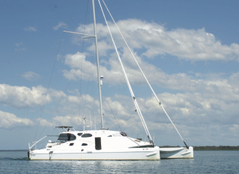

I had a cat with a lowering mast, you can see pics here.
One of these days perhaps I am going to play with a 40' cat again and build an 'A' frame mast for it.... who knows what the future will bring...

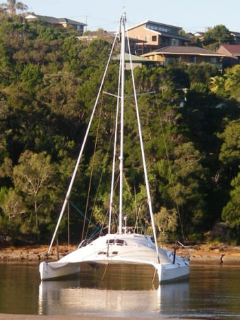

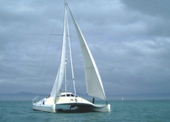

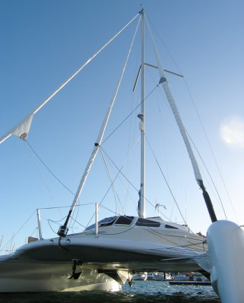

John Hitch had (or still has), a very successful catamaran, a main-less rig with multiple fore stays. 'Fraid I don't have a pic , tho' I'm sure someone else has?.:cool:

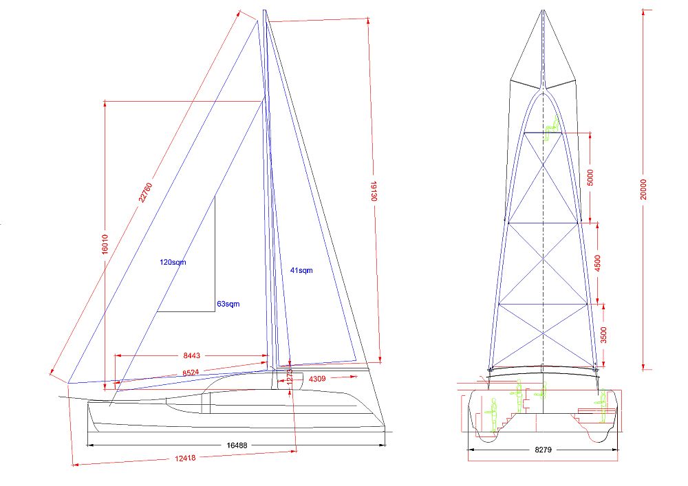

Lets design a 42' cat "A" Frame mast
Hello all interested in main-less "A" Frames,
after nearly 9 years of discussions, we have all gained a fair bit of knowledge, so I think it is time to get down and design this mast!!
Before I go any further, I invite anybody interested in developing this idea to contribute, especially designers, sailmakers, engineers, composite experts etc.
I kindly ask to all of you who think this is not a good idea, to refrain from telling me that it will not work, that it will be too heavy, that it will not point high, that the Marconi rig is better and that since it has not been adopted by mainstream designers and sailors it is not a good rig, etc etc. I have heard it all before and to tell you the truth, I am sick of it.
Now, the scope of this design is:
  1. have three permanently hung sails on three furlers (Parasailor or other spi, optional)
  2. mast on hinges so it can be lowered (forward)
  3. first sail on a prodder (horizontal A frame with net to walk on and hinges to pull up)
Some variables could be:
  1. first two sails with parallel luffs? This complicates the mast as we induces bending forces. Is this complication and the extra strength required worth the benefits?
  2. wishbone pre-bend or straight masts? With pre-bend, we can make the mast thinner as it will resist compression and buckling forces better.
  • I see the first sail as a sail for light winds, say up to 15kn.
  • The second sail as the driving force, sail to be used up to 30kn as it is, furling after that. If we put the mast aft enough, it could be self tacking.
  • The third sail is the smallest and its tack will be on a strop attached to the two mast hinges, so it will not have to be disengaged when lowering the mast.
Lets start with naming the three sails, then size them and, of course, lets consider the centre of effort, then we'll think about the mast.....

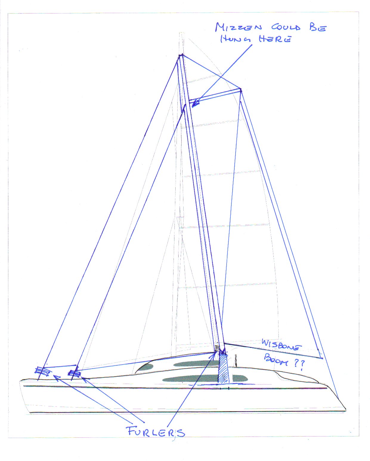

Some ideas:
No1 - Alibi had a good idea for the self tacking jib: an arched cross beam that had also held the mizzen furler as well as turning the mast into a triangular section.
No2 - An idea to increase tension on the forestay via an aft strut as proposed by Brian Eiland.
No3 - Procyon had solid cross members to stiffen the mast.

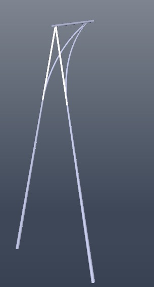

No4 - My idea of the pre-bent mast. Please ignore measurements on drawings, I made them for a 17m cat I had in mind a few years ago.
No5 - Nice rig. Do we need a mizzen?
No6 - Is this the same as No5 before shortening??

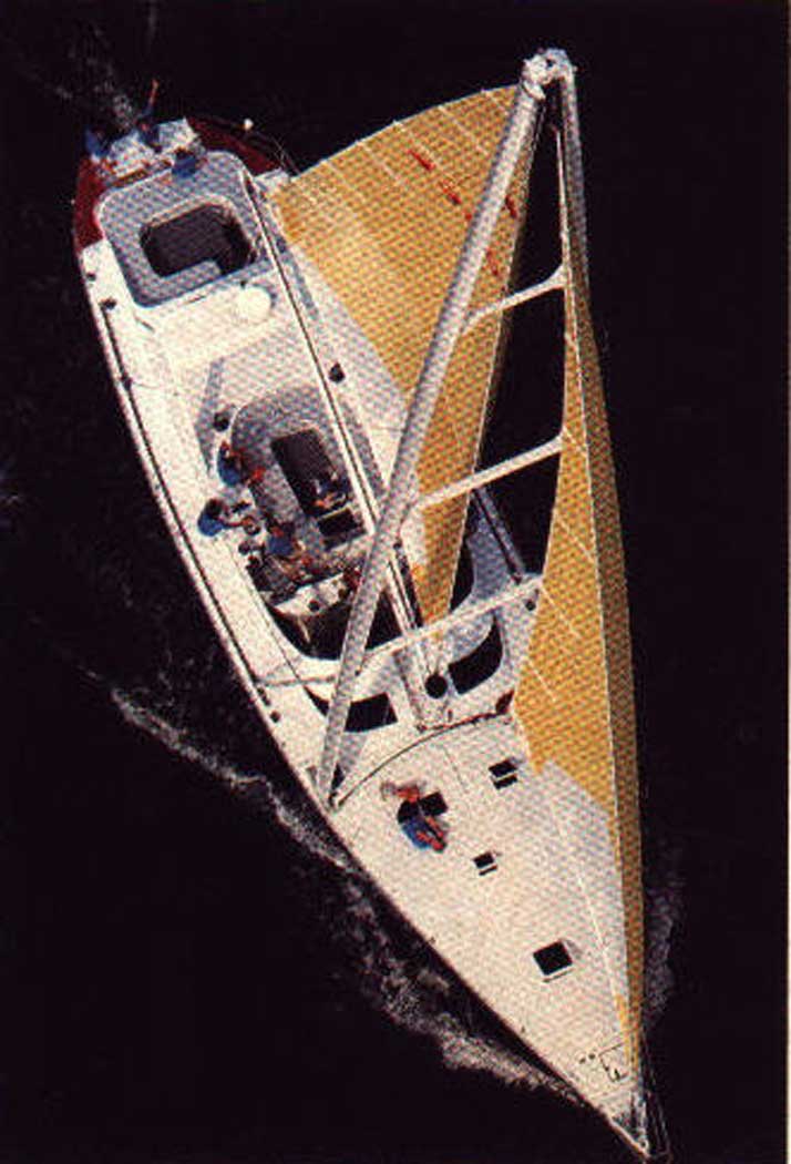

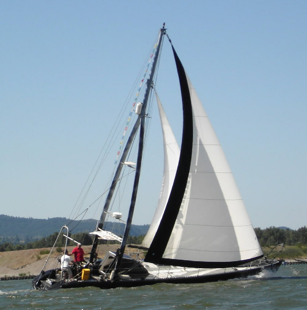

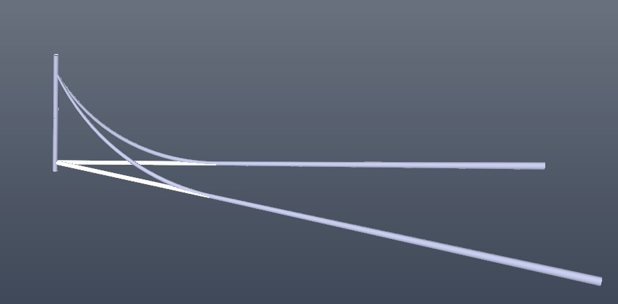

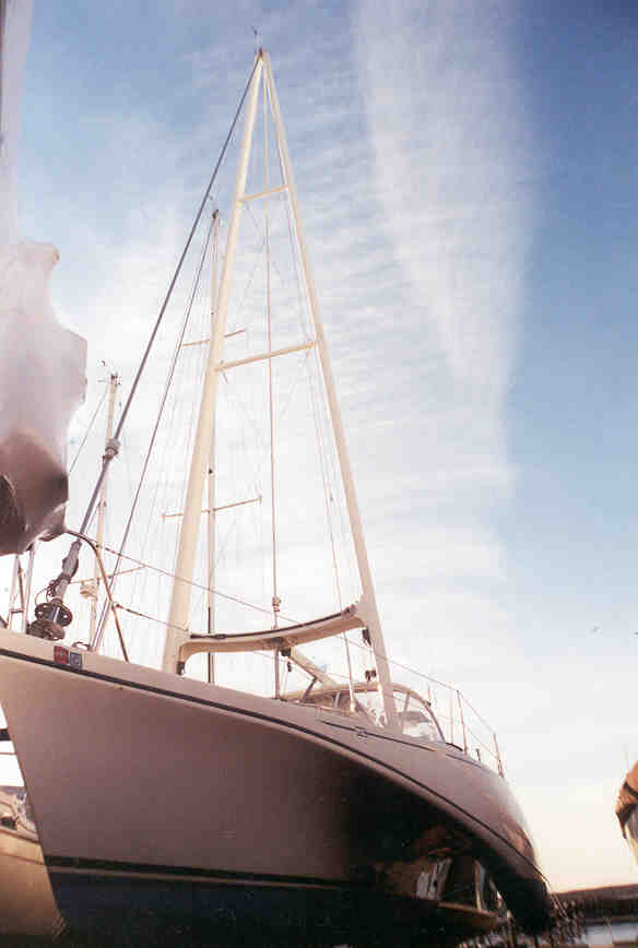

something in CF
the legs swivel around the top horizontal member to make installation easier
the assembly can pivot forward if bridges are a problem

Jeff (waikikin), I always liked your sense of humor.... perhaps we could keep Scorpion, Honeybee and Honeybee as nicknames, but to have a technical discussion with several new persons coming on board later on, we should stick more to conventional names, perhaps Screecher, Genoa and Mizzen. However this Screecher of mine would be very much used downwind, perhaps goose-winged with the Genoa or with a twin sail on the same furler foil, so the name doesn't quite fit.
jfraymond, I like WASP, if we end up with bent, pre-stressed masts.
UpOnStands, I considered an horizontal member, but the torsion forces induced by the mizzen would be hard to predict, also there would be bending of the masts at the junction of the supporting struts hence the masts would need to be beefed up, engineering costs would increase....
Brian, while I have participated on the Wishbone sailing Rig thread and learned a lot from it, I have not asked the group to actually start designing this mast, I thought since I started this thread, it would be more appropriate to do it here.
Thank you for showing us the post by admiralslater, very interesting, would you PM him and see if he'd like to join us or do you prefer if I do that?
I have considered two A frame masts, ketch like, the idea was to spread the sails horizontally rather than vertically.
But then I thought that a long prodder and an aft mast, can carry a lot of sail for light winds and the three furlers be able to reduce sail in a jiff.
However this idea of having them hinged at the same spot has a lot of merit:
  • the aft mast can give a lot of tension to the forestay
  • masts can be shorter (intracostal...)
  • the 'upside down' mizzen is a 4th sail probably very useful in light winds.
Now we need help from a good sailmaker (are you reading MB?) ....
