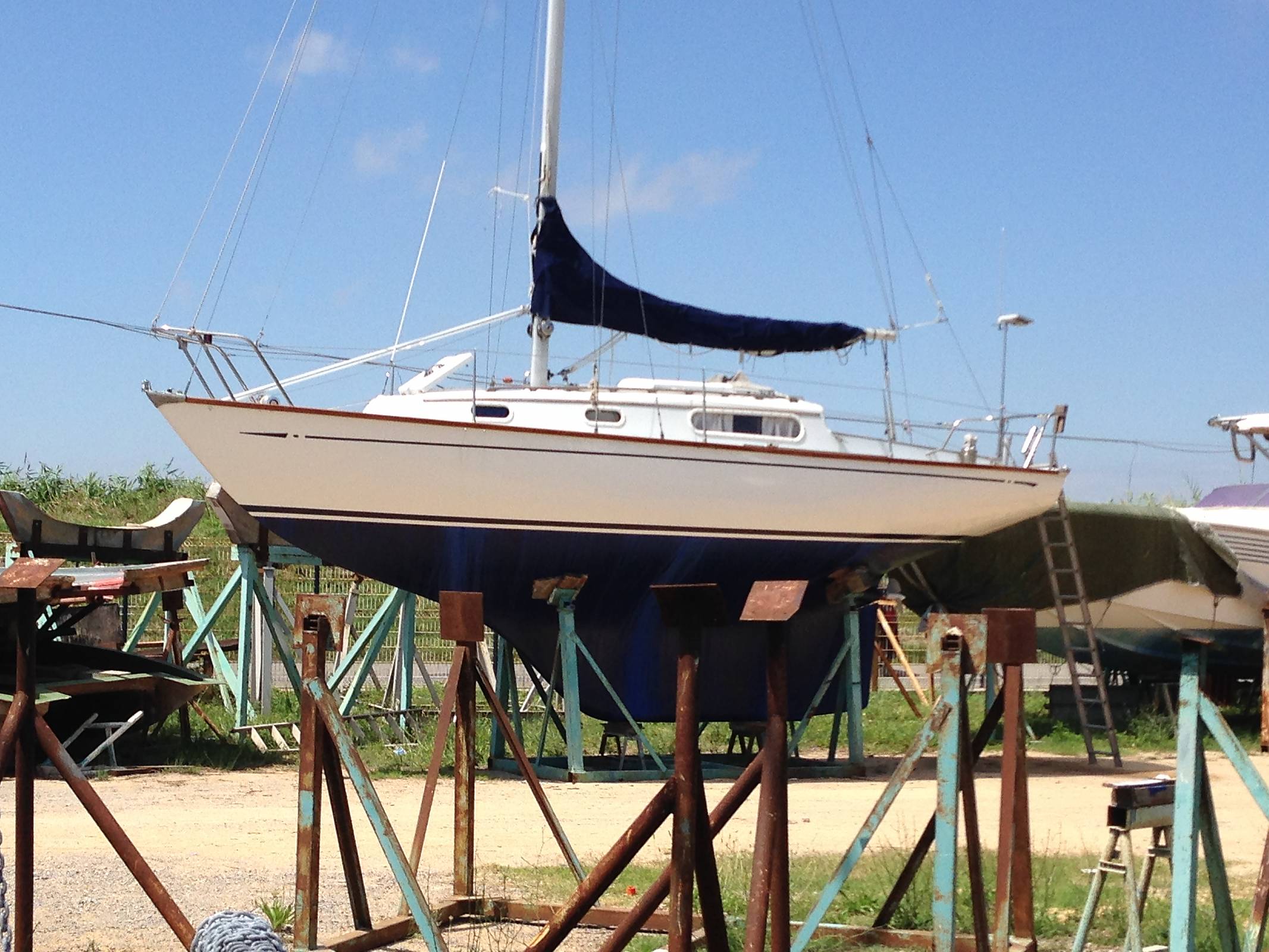

    I've a 1966 Illingoworth designed sloop that has a coachroof that is too high for my taste. Cutting it and sobstuting with a new one means a lot of work as I should also change shrouds, cutting bulkheads, so I must find another - more practical - solution.
    Any idea?:confused:

    Beautiful boat. What is the reason you want to lower the cabin? Is it for performance? I am not a fan of boats with too much freeboard or full standing headroom, but this boat seems perfect as is. What am I missing?

    Theoretically, if it was for racing, you could strip it out down below, lengthen the cockpit, and turn the cabin into more of a cuddy. Also lower the boom to make the mainsail larger and more efficient. Is that what you mean? What is the boat used for?

    Looks Good to me, I like a boat that has a good balance between freeboard and coach roof height. This is always a challenge with smaller boats and still attain headroom. Many design tricks of the trade are used to attain this including something as simple as the paint scheme. In my view the designer has done a better job than most on yours --

    I am not getting this. If I understand correctly, you want to lower the coachroof of that boat without cutting it? :confused: Can you deflate it?

    Michele, you might consider painting the sides and front, just not all the way to the top.
    Leave the roof and the upper parts of the sides white.
    That may visually achieve the effect you want.
    Best thing: you can play around in Photoshop to see if it works and spend no money until you think you know it will.

    Aesthetic changes to lower the visual impact of the cabin side would be to paint the cabin side a dark color, with a lighter (white) roof and hull sides. It'll be the cheapest way to go.
    You could add a bulwark, instead of a toe rail and paint it a dark color, again using this visual trick to lower its impact.
    The "eyebrow" trim around the edge of the roof will also serve to lower the roof line, if painted a dark color, as will staining the grab rails dark.

    As PAR said, a cleverly applied paint job would very much change the boats appearance. Can't imagine why you want to reduce the cabin height.

    What do you think if I apply on the coachroof sides those 3M boatwrap with a wood effect?

    It will look like an early 1970's Buick station wagon, with the same treatment. A vinyl wrap is an fairly short lived option, that's not too costly, though I'd think you can be by much cheaper with a DIY paint job.
