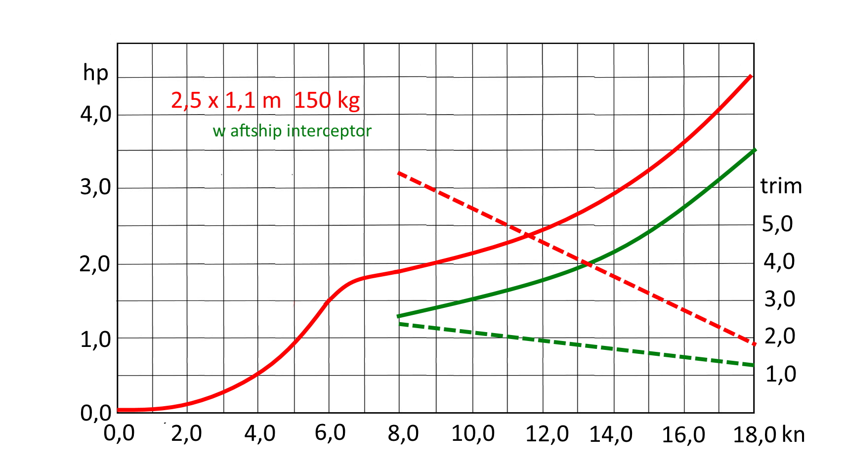

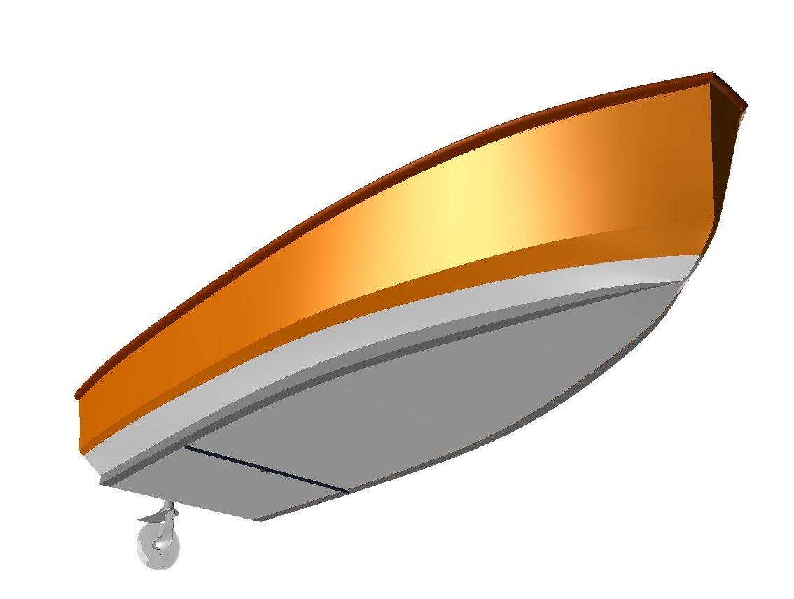

    Here comes a proposal for a 2.5 meter planing power boat.
    The calculations are based on a total weight of 150 kilos. The bottom width is 0.8 meters, neither more nor less. The efficiency of the driveline is assumed to be 65%.
    The aftship interceptor penetrates from 19 to 5 millimeters. Dry transom at 4.5 knots.
    JS

    Is there a power callout?
