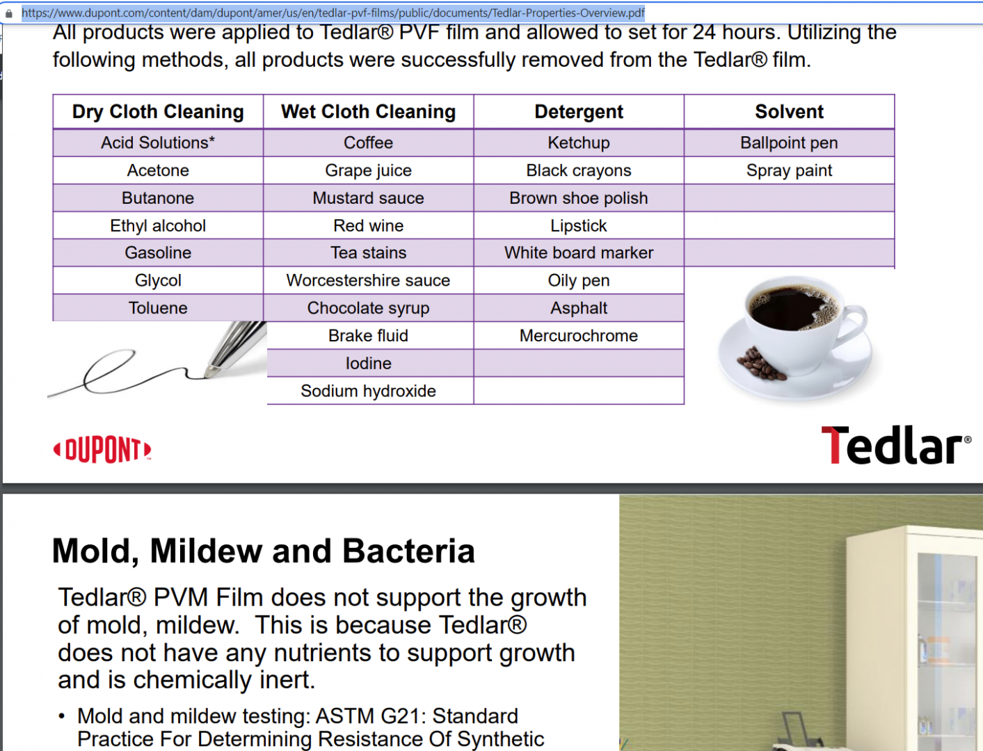

    Thank you Mr Watson for the heads up about this material - it certainly has very impressive properties.
    It is probably relatively expensive (compared to other materials commonly used as linings on boats), but it certainly does appear to be ideally suited for use in a marine environment.

    The RV industry has used it for a very long time, like everything else though, it has its place. It hasn't really caught on for marine applications, probably due to it being a bit fragile, sort like a vinyl wrap.

    Fragile ? That's not the impression I got from their brochure. Have you actually seen any in the "flesh" ?

    It is a thin film on the surface that isn't easy to repair, so damaged panels are commonly marked as seconds. It has been used on large commercial trucks and trailers, motor home side walls, house boats, etc for more than two decades. It has good UV and general weathering characteristics, so people have made great efforts to encorporate it into composites.
    The cost and hassle limit its use for cost sensitive products though.

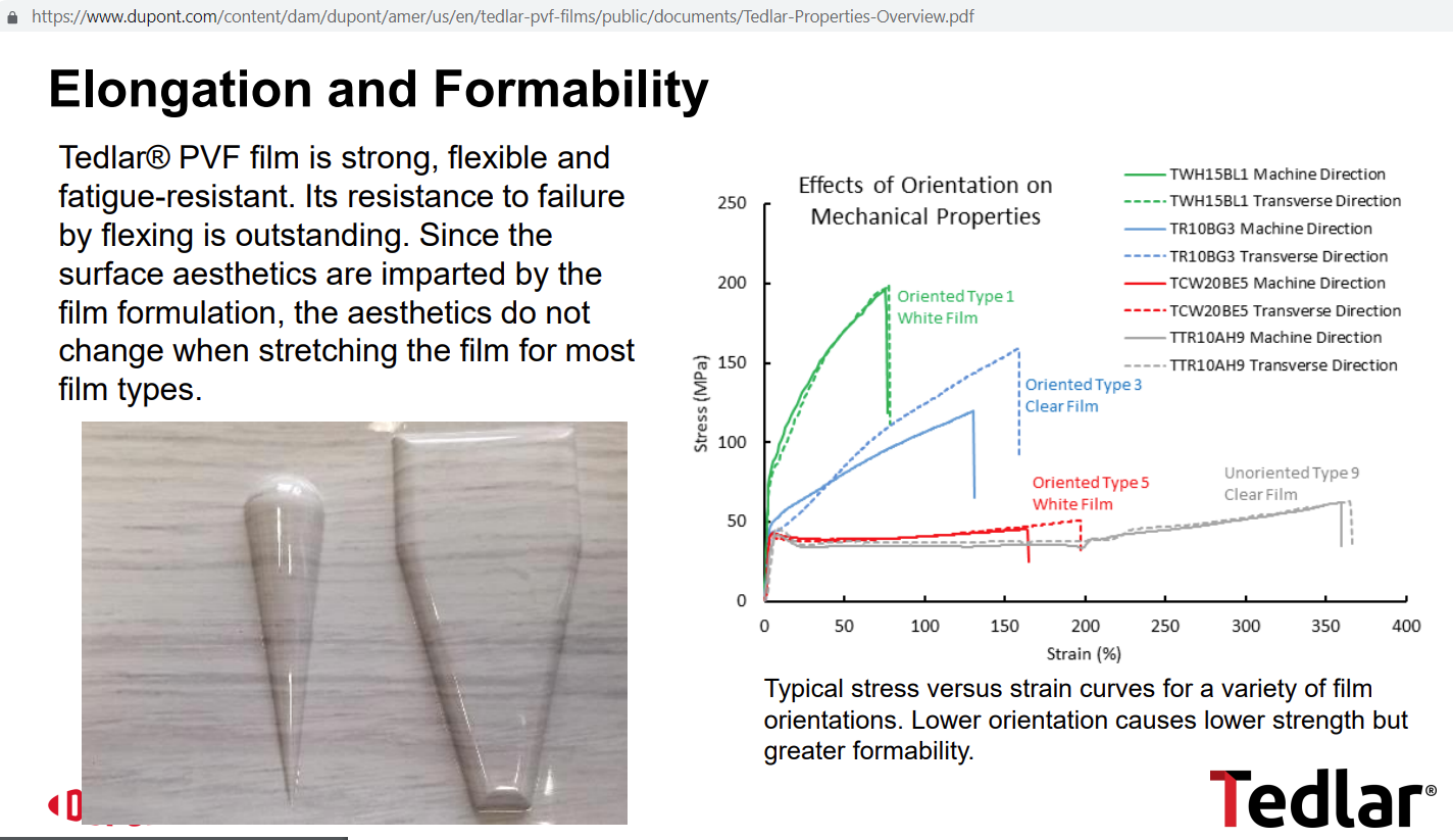

    But Fragile ??
    Up to 150 MPascal pressure ?

    Scratch it and see what happens.
    Plus it exactly duplicates the substrate it's placed over, so a surface texture helps to hide defects.
