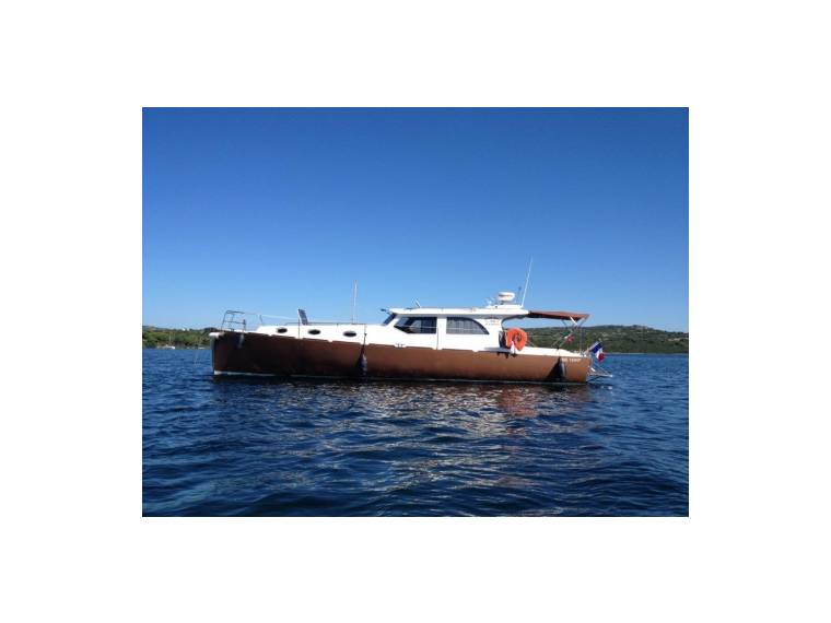

    I like the direction you are going in. In November I started looking in to designing and building a coastal cruiser for my family of 5. Something for me to build in the next couple of years but still very early days. I too am interested in a LDL type vessel, around 40ft, 100hp, 12 knot cruise (a little faster) , lots of open internal space, lines reminiscent of yesteryear cruisers. The difference for me is I need to sleep at least 6 and if the boat were trailer-able then the cost of annual ownership would more than half. Here are a few ideas I have come across that may interest you.
    I am sure you know LDL's need to be very light and thin for the design to work. Although I love the concept I am having lots of trouble fighting with the limited beam, narrow bow entry, shallow aft sections and the idea of a comfortable cruiser that is light, thin and round bilge. All that spells for me is a constant 'rollathon' even in sheltered areas. Irens and other designers ensure a very low center of gravity, active stabilizers and Seakeeper gyros to try and stop this. Its really a monohull sailboat with no keel! The reality is dawning on me that an LDL that anyone would want to sleep in might need to be 60ft+. I am not sure if under 40ft will really work. Which begs the question of: Does it really need to be an LDL? Then I saw this:
    This guy has a heavy old wooden boat that he repowered it with a 40hp diesel which does 9 knots at 2000 rpm! Or so he says.
    Outboards. Awesome for shallow draft but outboards are designed to go relatively fast. I don't know if you can get the propeller/gearbox correctly sized for maximum efficiency. So a gas powered outboard on 9 knot boat is probably going to burn 1.5 - 2 x the fuel of a correctly sized inboard diesel with conventional shaft. Just a thought but I know your shallow draft needs an outboard so .... moving on.

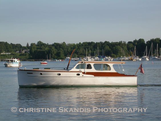

    This Matthews 38 from 1946 has a great layout that completely open the Pilot House to the Aft Deck. I love it as it reminds me of a studio apartment with endless options especially for foldable furniture.

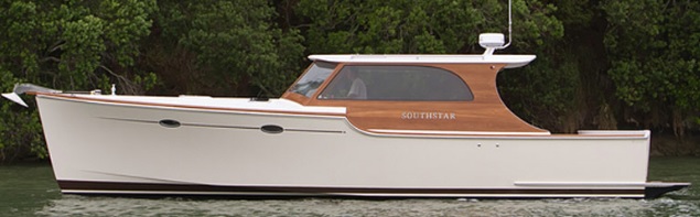

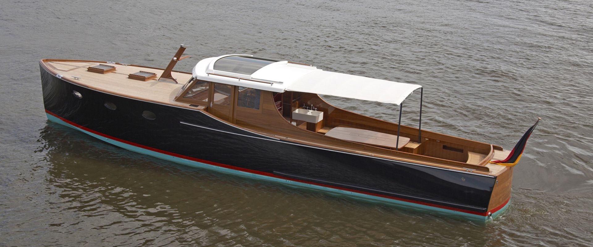

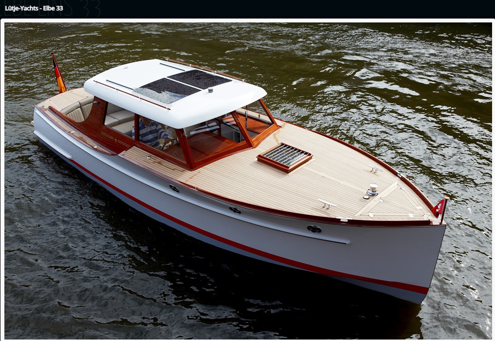

    Here's what I have come up with to date. Still considering a few things. My main beef is the engine placement. As the aft end of the boat is so shallow there is nowhere to put the damn engine where it is not in your way. A couple of small outboards could be appealing in that sense. Then I could open the whole Helm/Salon to the Aft Deck. My compromise for an inboard diesel is below two settees but also through a main bulkhead. I got inspiration from the Rangeboat, Lutje 33, Matthews 38, Southstar 37 and Georgia attached.

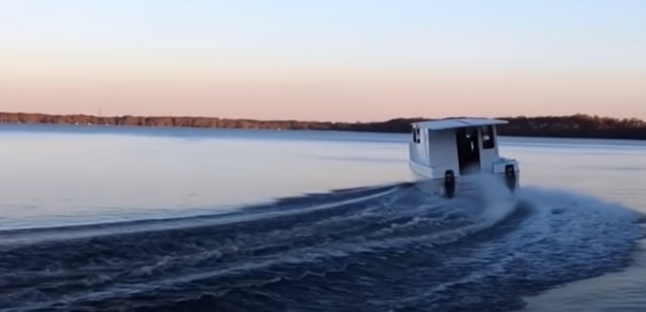

    What I do like is this vid where it's really got a bit of skoot on.

    This looks like a really interesting boat, proper lightweight at 1.65t. I'd love a 36' version of this that can still just about fit on a trailer.
    I was a bit confused by the hull shape. This is a displacement boat but the full width of the beam of the boat come down onto the water like a planing boat?
    Or is this a hull design that is a bit like a trimaran or "stabilized monohull" - with the full width of the boat just barely skimming the water? I guess if it's balanced just right it only adds a little bit of wave drag. Or is this a "light planing" hull design?
    I'm interested in powering a boat similar to this on lots of solar panels, traveling slowly at 5-6 knots. The electric version seems to have a range of 44nm@8knots with a 53.2 kWh battery. This should be about 6.6kW@8knots. So maybe something like 2.3kW@6knots and 1.32kW@5knots. But fitting enough solar on the roof would be hard (5kW / 25m²) to generate enough power to extend the range meaningfully seems hard. It seems there is no way around a power trimaran with thinner hull for my dreams of solar.
