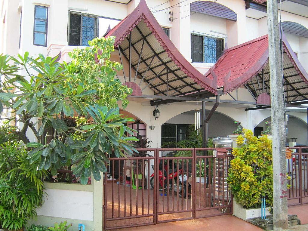

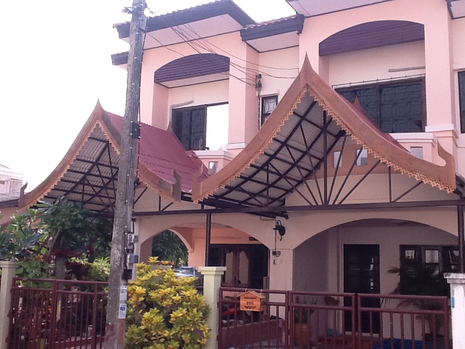

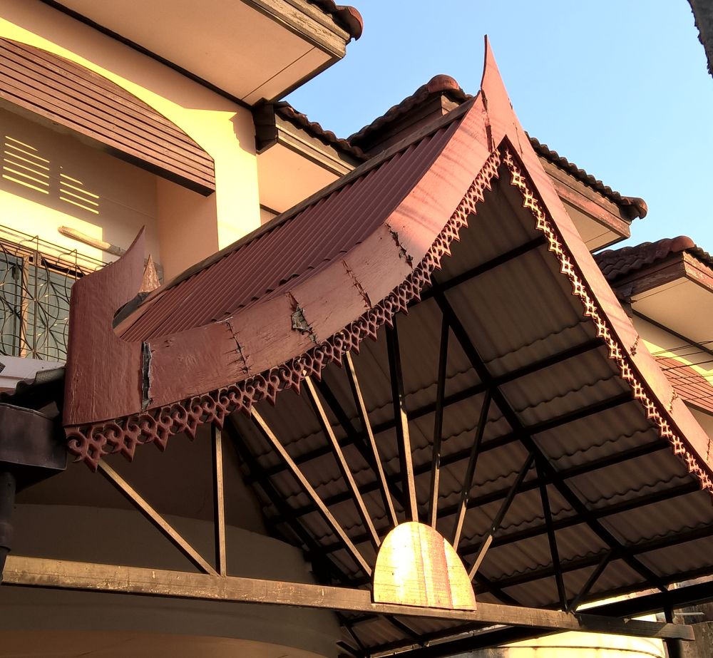

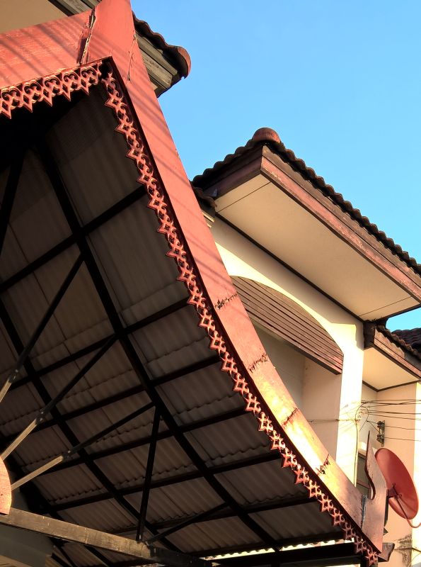

    I was looking for some 'exterior grade' plywood to make some replacement 'fascia' pieces for our Thai style roofs here in Khon Kaen (attached a few photos of when it was first built, and the deterioration it has suffered).
    I was quite surprised when I visited a local hardware store that appeared to have a number of different selections of plywood, BUT was told that none of it was exterior grade/usage?
