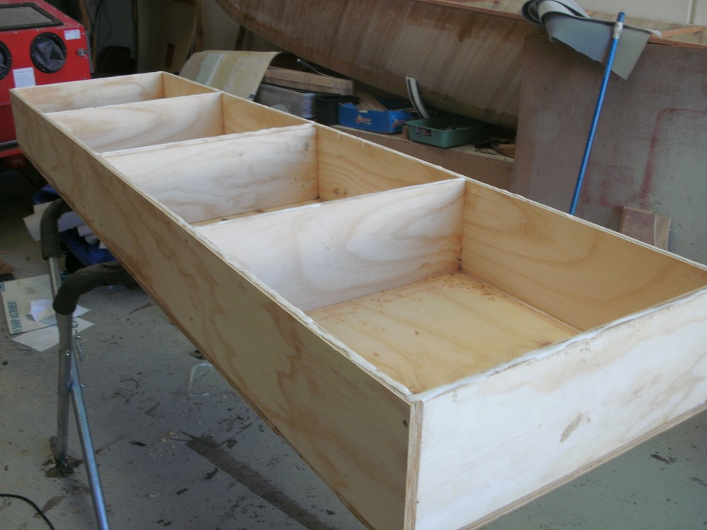

    Here is my marked up scan of the K25 main hull sections in .pdf. I don't vouch it's perfect but it did work out ok for me. The boat of course is no cruiser but there is a reasonable amount of hull volume for daysailing gear/picnic basket etc around the daggerboard case area.
    I glued in the deck and beam supports today.

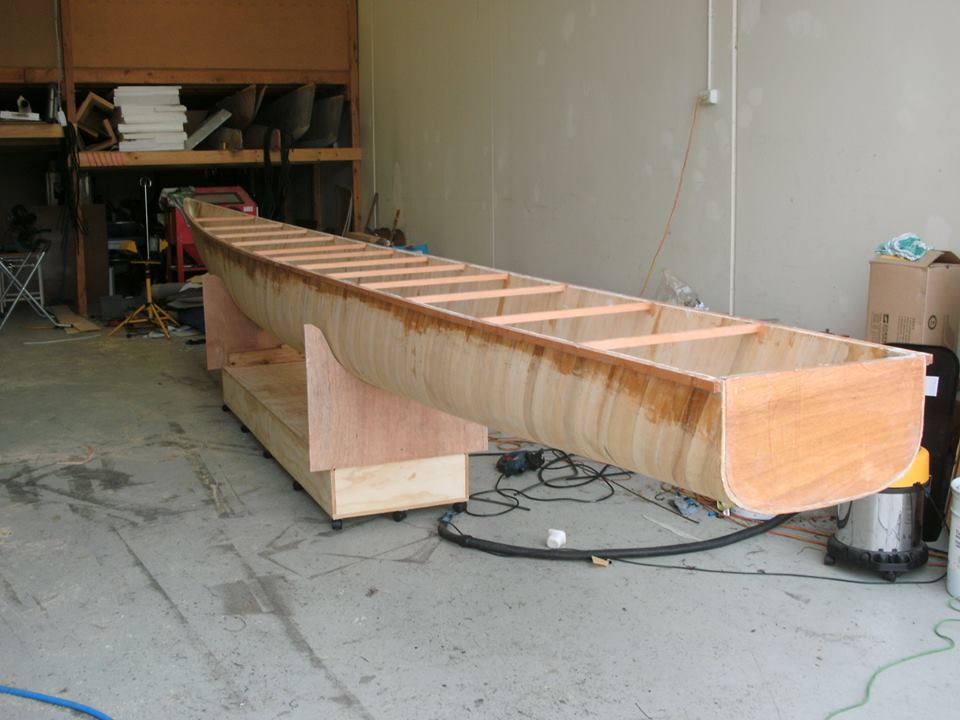

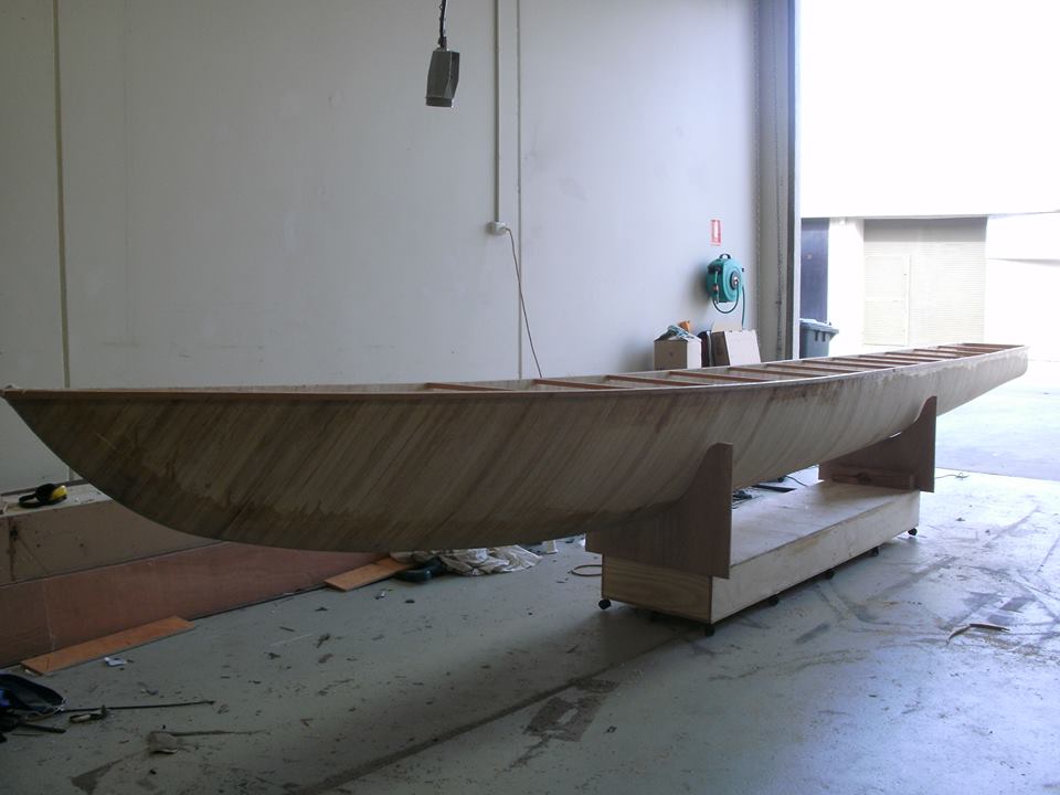

    A bit of work completed today I built a small rolling platform and cradle to carry the main hull so I could break down and remove the original strongback and clear up the workshop. In the next few weeks I should get the platform, crossbeams and old floats mocked up to confirm bulkhead positions and alignments.

    Hi Barry, It's not perfect and has a slight twist in the front and rear of the hull nothing that will cause problems but a fixed strongback while building would have been better as far as keeping things square.

    It's pretty minor I ran the plane over it today in a few selected locations and now the perfect eye is pretty satisfied. It wasn't much and I think I can tweak the last bit out when I fit the bulkheads and daggerboard case. The only thing I'd do differently is setup the case and internal bulkheads first, accurate measurements at the mold stage are a bit easier.
