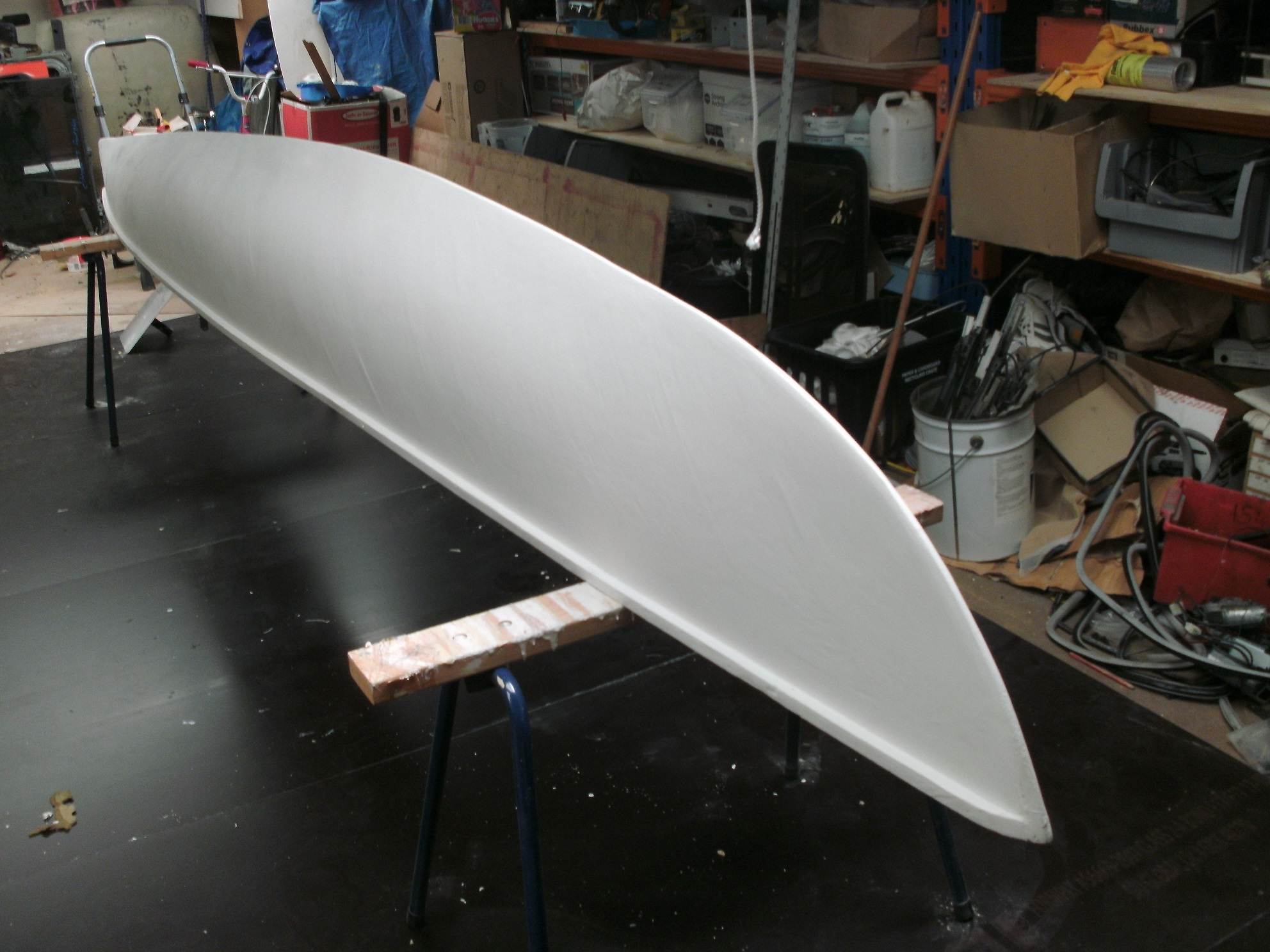

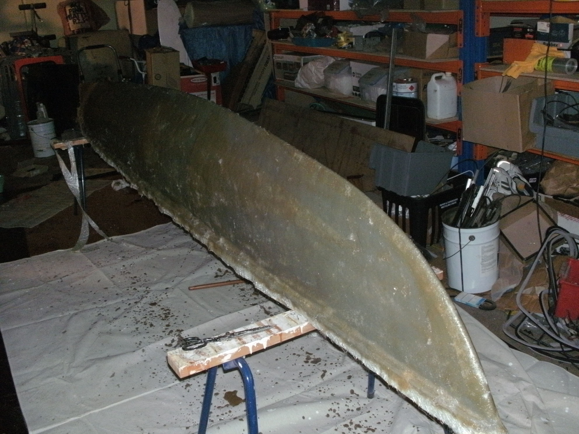

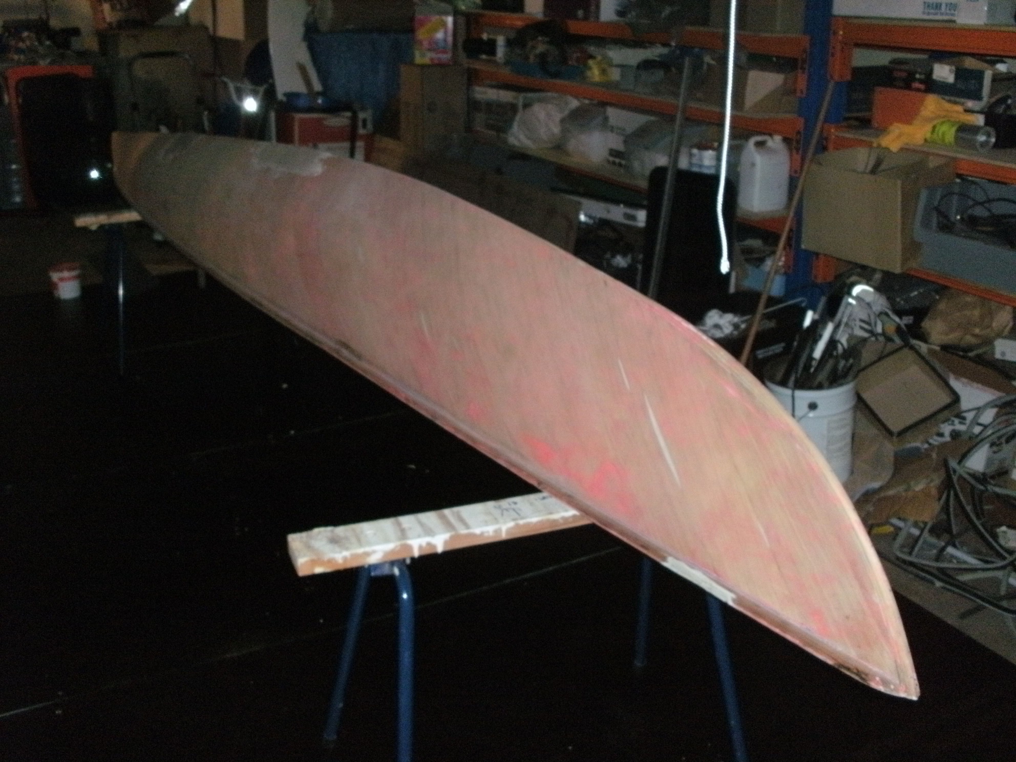

    My Kraken 25 trimaran project got some love today. I've been scratching my head for a while on how best to reproduce the floats on the boat. These floats are custom and came out of Lock's head and don't align with dimensions of the ones in the plans. The later floats as shown in the plans were used on the more refined racing version of the boat "Jabberwock" Initially I built a hull shell using one of the floats as a plug. I've never been happy with it's shape so what I've done is use the one float that is in tolerably good shape as a plug to build a female mold. My intention is to split it down the middle using my oscillating cutter and build the float hulls in halves. Possibly vac bagging the veneers in position rather than stapling them. I've done quicky molds like this before when making custom bonnet scoops. More sanding required but gets the job done for a one off.
    My wonderful father Graeme came down and helped me do the gelcoat and wetout the CSM.

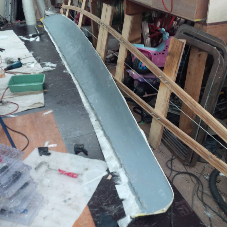

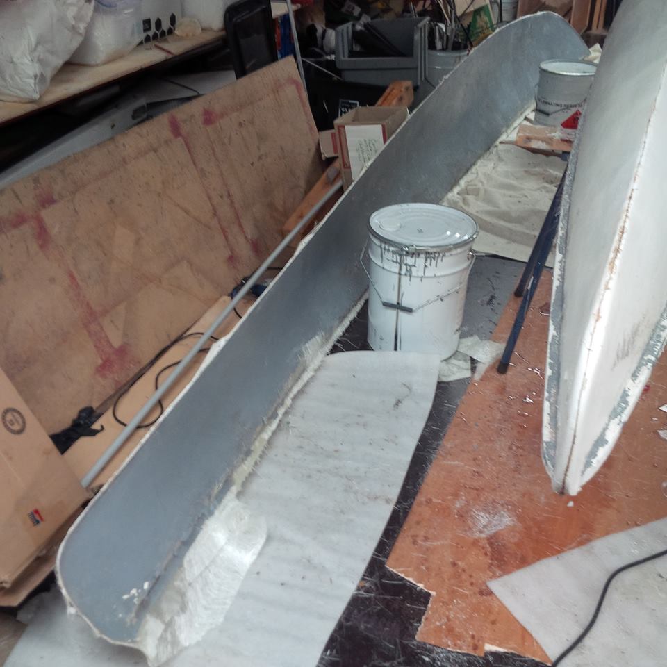

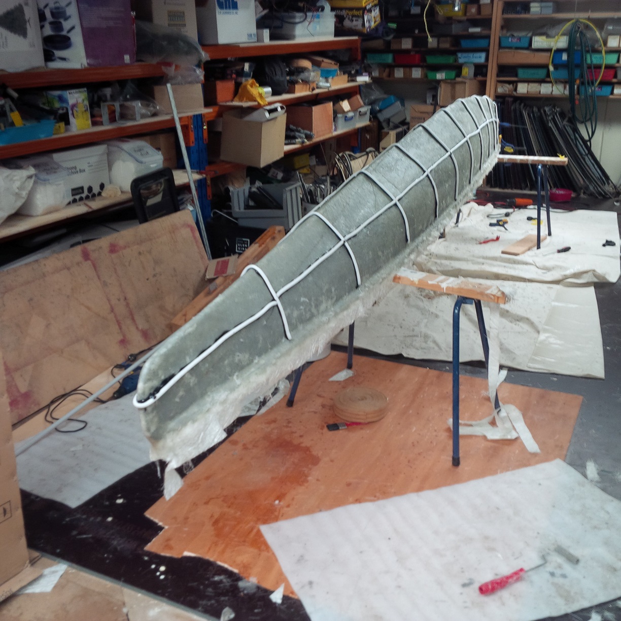

    Over the last week it's been more tedious work strengthening the mold with stringers. I used closed cell spacer round section foam to form the ribs then glassed over. It doesn't look like much but I've found it adds a surprising amount of stiffness to the female mold when I've done it this way in the past. I also broke up the most rotted of the two floats to make some space for laminating new float halves.

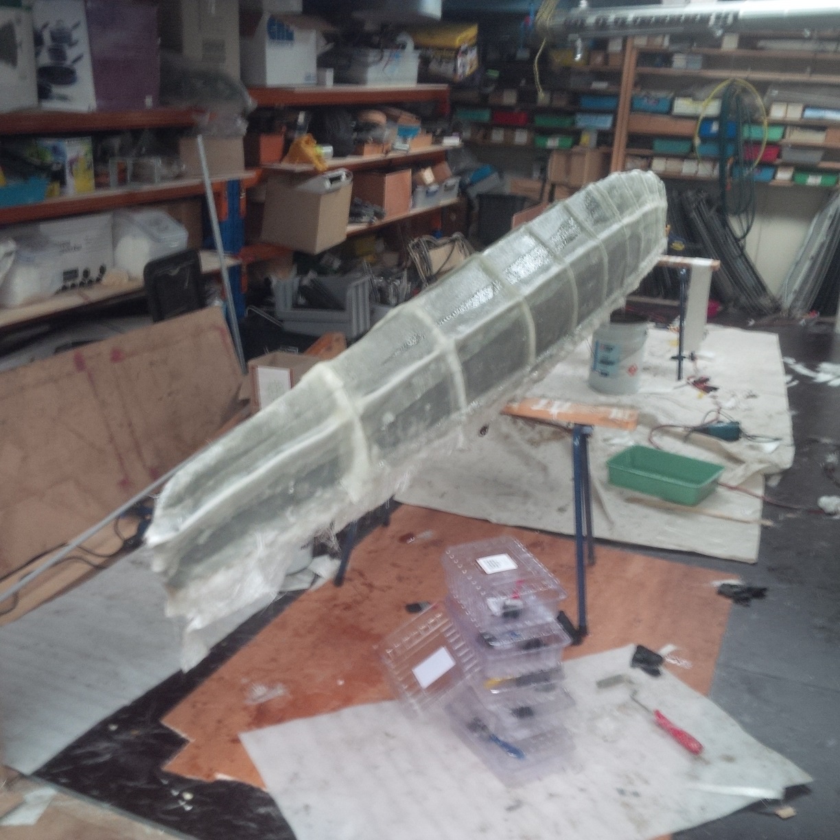

    Now it's cut in half thanks to Mr Fein saw. They are a bit rough but since I'm going to cold mold inside the form I'll just wax and coat the forms with PVA release. The cold mold fairs itself pretty well and since the shape is basically a curved V the veneers wont require much effort to conform to shape.

    whats the plan, do side then other and combine, or combine mold and lay up inside recombined mold?

    This is what I'm thinking:
    a) I'll lay the sides up in the molds I'll probably mark out and sit the lower keelson edge against a lip to hold in position. I'll fit a slightly higher than needed gunwale strip and just staple at the very top. Should save me a lot of stapling as the veneers will be constrained inside the mold. Bottom layer laid dry and thickened epoxy between it and the second layer. Could vac bag but may not if it all sits together ok
    b) coat the inside of the finished lamination with two coats of epoxy.
    b) Glue and tab in the bulkheads on one side, glass in with double bias over the tabbing
    c) Offer the other side up and fix both sides in the deck jig
    d) tab the bulkheads in on the other side.
    e) Join the two sides along the base with double bias.
    f) Pour the keelson on the inside and cover the fillet with double bias.
    g) Then do the same for next float.

    Much better to vac bag the veneers, not just for shape and excess resin removal, but as it draws the epoxy into the veneer increasing the veneer strength significantly, as you then have epoxy bonding the fibres together inside the veneer, not just cellulose. You can do this with either unthickened, or marginally thickened epoxy, depending on how flat your mould is.

    Thanks, I will have to tidy up the mold edges up a bit to vacc bag but it isn't a major job. If it avoids having to pull lots of staples and gives a superior end result then a bit of extra setup time isn't a problem.
