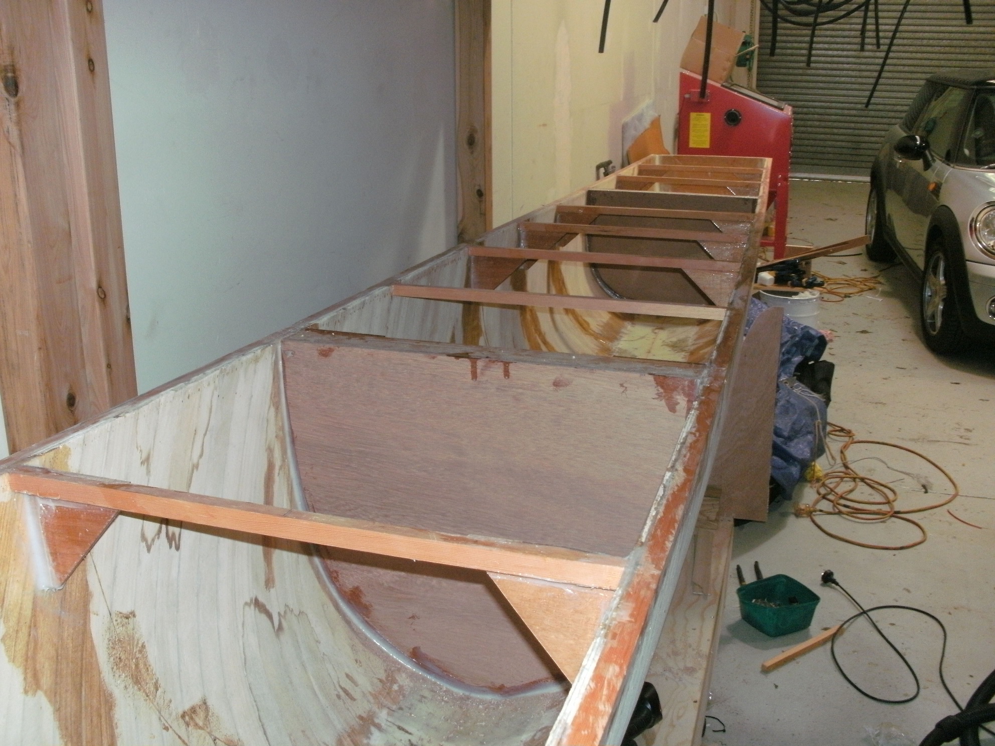

    Epoxy keel/keelson was poured some time ago it's more of a deep fillet in this case. I'm very pleased with how strong it is bulkheads should go in next week and firm up the shape.

    its shaping up either way. is that 1"x1"(guessing) part of the jig you made for the top forming?

    It's the same size as the gunwale strip 3/4" square but on reviewing the plans again I've realized that the crossbeam mounts are 1 1/4" square I'll probably just bulk up the Oregon a bit with some hardwood to that size to take the captive bolts that the beams are attached with. The bulkheads which are 3/16" ply had a sawn hardwood 3/4" nailed to the front face of the bulkhead in the original. That will be replaced with a structural fillet and some double bias glass.

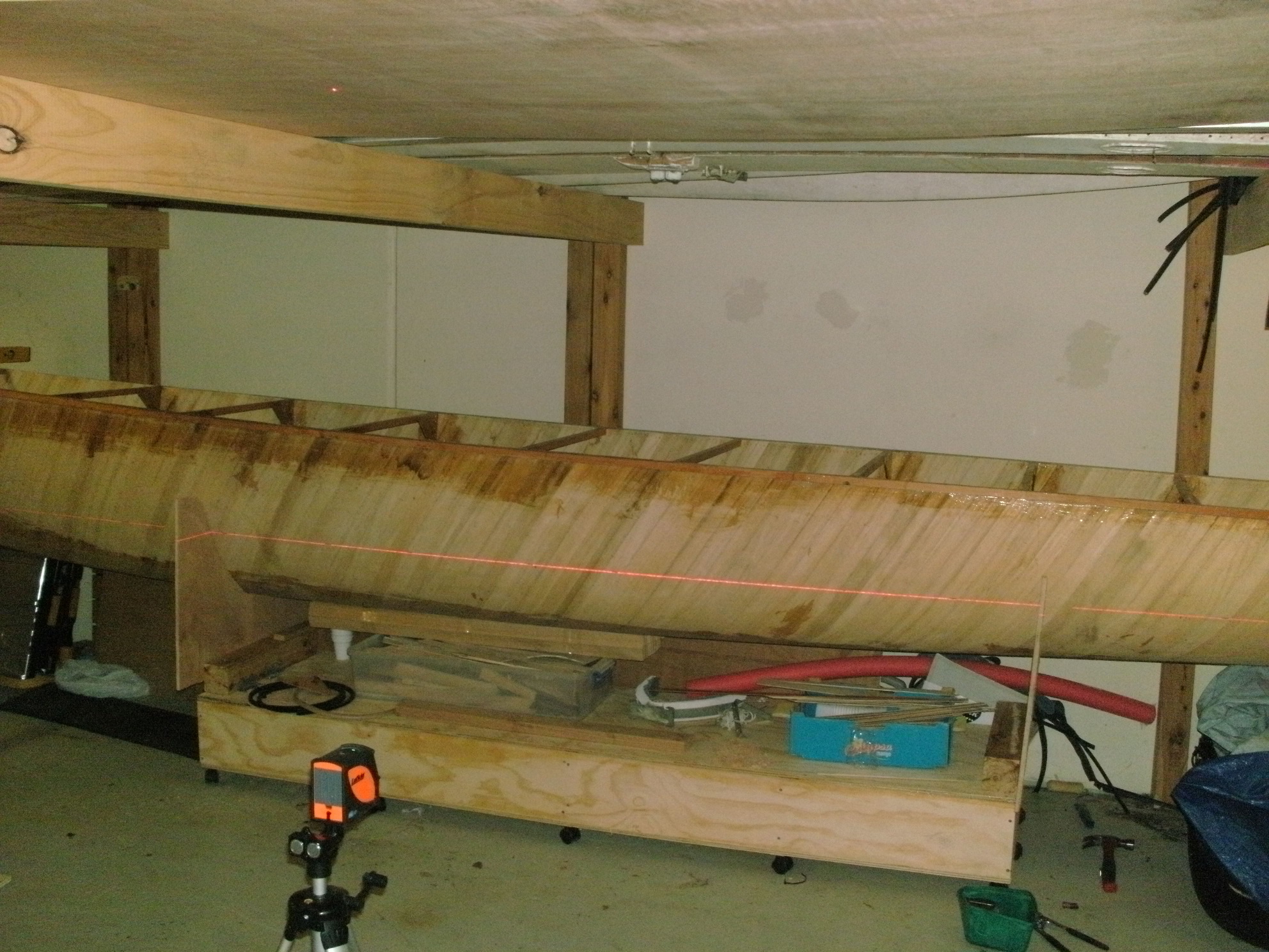

    A little more work on the tri this week. I marked a waterline on my main hull with the self leveling laser. A fantastic tool which makes the whole process so much easier. This is to help position the internal hardware with more precision.

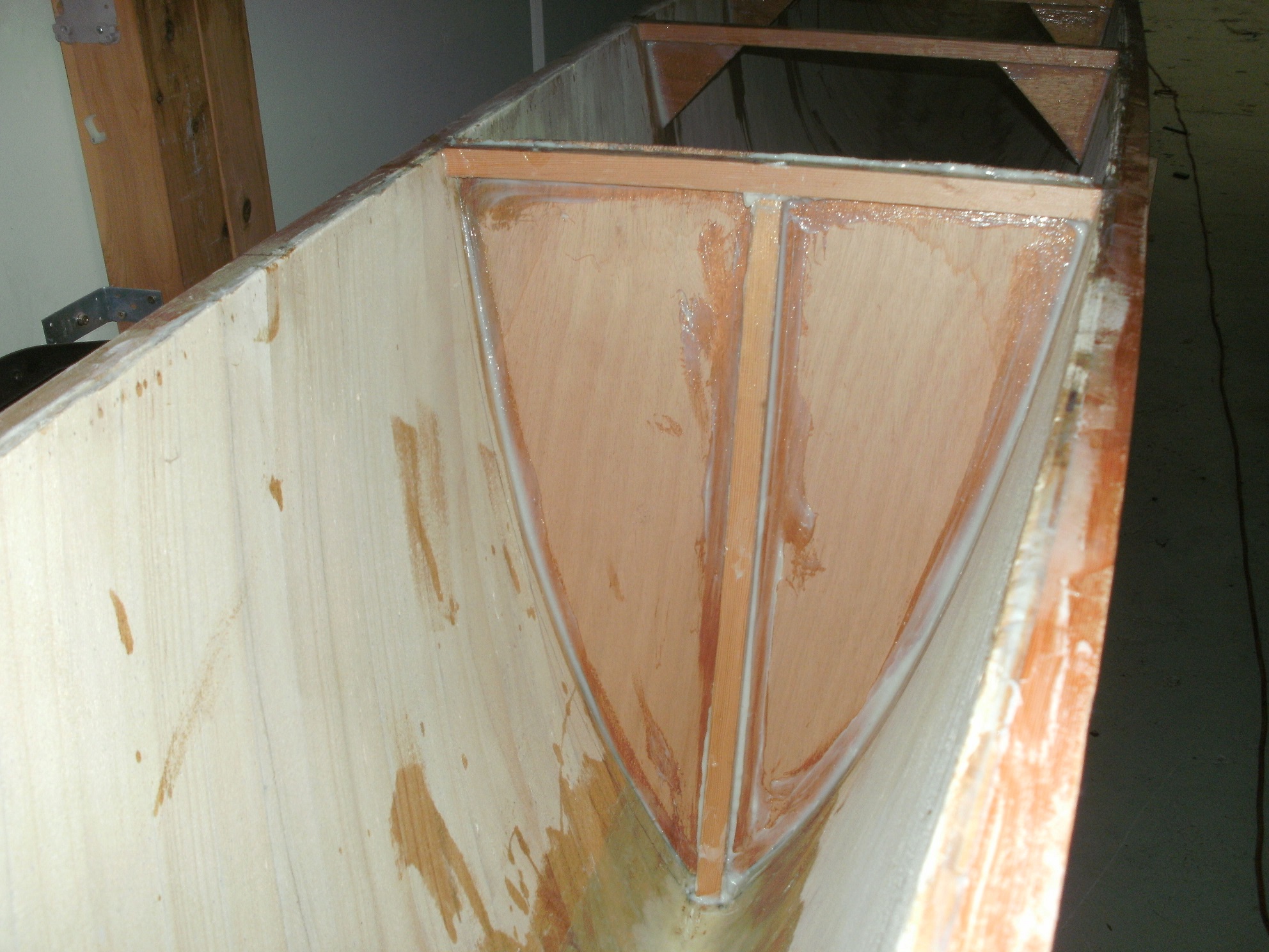

    I've cut and tabbed in the first bulkhead. This bulkhead is for the furler/genoa mounting and I've inclined it to be inline with the load. It's a double bulkhead with a 3/16" ply on both sides. I'll epoxy the inside of the cavity prior to closing it as It will be innacessible once the second part of the bulkhead is fitted. I'm going with the plan suggestion of a stainless strip bolted through the bulkhead for originality purposes. This bulkhead will have elongated lightening holes cut into it once glued in position.

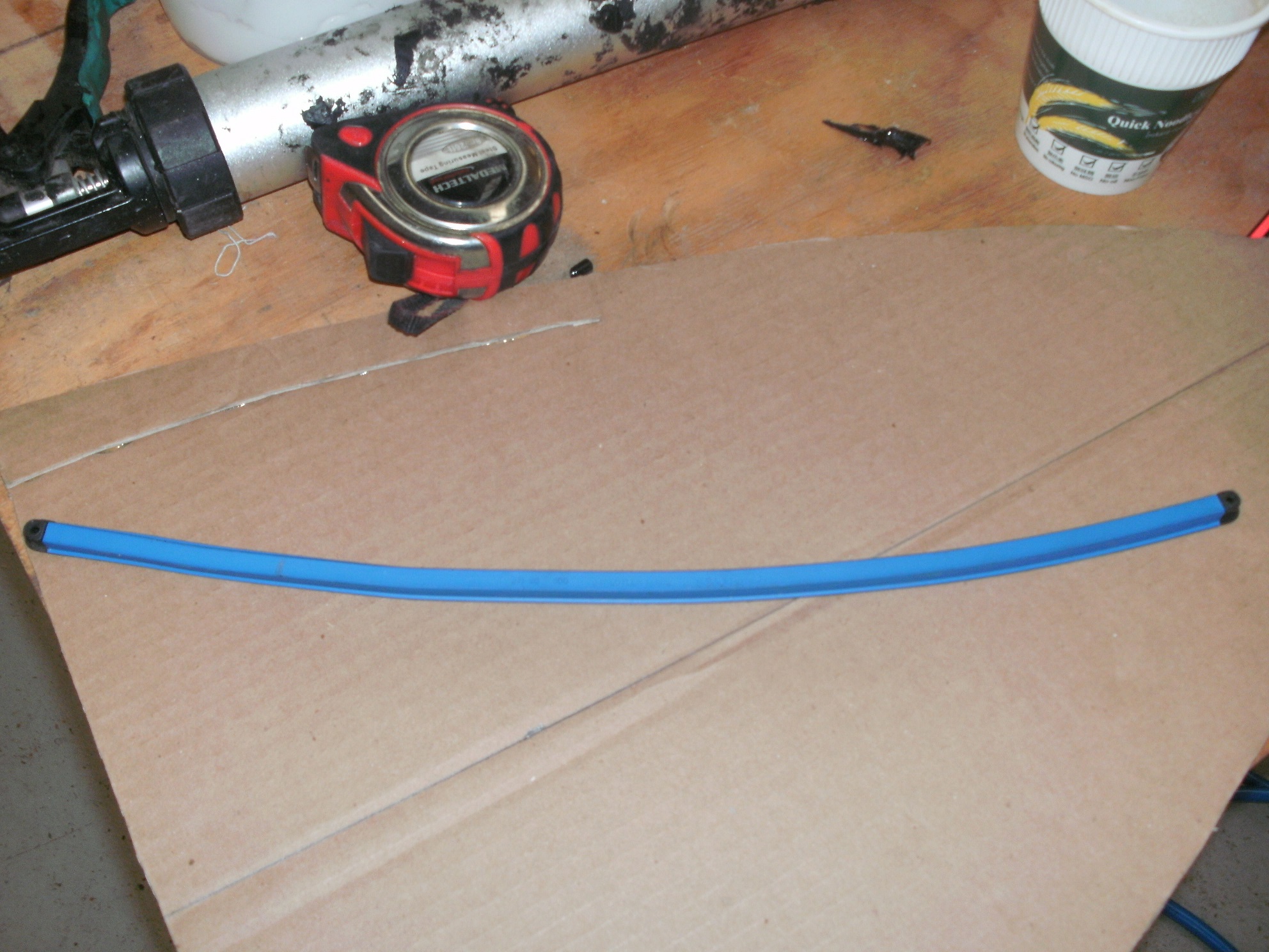

    To mark my bulkhead curves I use a handy Staedtler stationary tool. It allows you to bend it to shape and will hold in position for you to mark out on a sheet of cardboard.

    I'm still debating the ventilation issue it's certainly important to have airflow through the hull. I'd rather not put a spin out cover on the bow for aesthetic reasons but will have one behind the roller furler base. The furler bulkhead will have cutouts so I'm hoping that will be adequate. I'm considering putting a limber hole under the bulkhead for easy drainage I've seen them done with a short section of PVC tube glassed in position to prevent any standing water remaining in the hull.

    I would urge you to consider having no access at all into the voids you make in the bow, stern and float areas. Well epoxied and with proper Gougeonesque attachments of fittings you need not have any access into voids at all. Epoxy coat them well and drop some Copper napthalate into the void as you seal it up.
    Often adding the access creates the leak so I would use large wooden epoxied in place backing pads to tap into and composite chainplates as well to ensure the voids stay watertight. If you bolt you will need access and the leaks that will create.

    I've been thinking rather than bolting the forestay fitting through I might follow the gougeon suggestion and just bed some machine type stainless screws in epoxy to hold the load. Most of the load will be in shear from the forestay my only real concern is the tow ring that will have to be attached in that area. I know they take a beating particularly when the boat is being pulled onto the trailer.

    When the Kraken was originally designed it was probably meant for cedar veneers or ply wood. The glues were nowhere near as good as epoxy. Even if you do not use any glass it should be much stronger than the previous build. BUT I would not be happy unless I taped the bulkheads in as well as gluing.
    Have a quick test. Glue a piece of scrap onto a bench or scrap wood and cove it nicely. When cured tap it with a hammer. With a certain force the cove will crack and the join will totally fail. Epoxy - strong but woeful at impact resistance.
    Then do the same with a light layer of glass over the cove and attached to the bulkhead proxy and scrap wood. You will need to pound away to get the thing to let go. The glass gives the joint huge impact strength.
    As your hull is flat and will go fast I would be very willing to have some extra weight so that the bulkheads stay attached.
    My 38 footer has 600gmDB tabs. I would want very light ones for your boat. You could try a technique Burt Rutan used on his planes - use sheathing cloth. He used to get some loose weave stuff and skew it with a friend but I just cut it at 45 degrees to the roll - cheap and light +- 45 cloth. It will weigh nothing but make the structure much stronger. (Watch out - it stretches like anything) Remember you won't have any water inside as the boat will have composite fittings so you can gain a kilo for strength.

    Thanks Phil, I've more clarity in my mind in regards to the best approach now. I've decided to tab in with 400db over a fillet on the bulkheads. So you are suggesting it's a good idea to cover the flat face of the bulkhead as well with db glass? I've had some useful advice on composite mount on the bulkhead the general suggestion is to use glass uni's to spread the load over both the faces of the aligned bulkhead and then glass over with double bias which seems reasonable for the genoa mount. I was going to run with your suggestion on building the composite forestay mount and tow ring as it seems the best approach.
