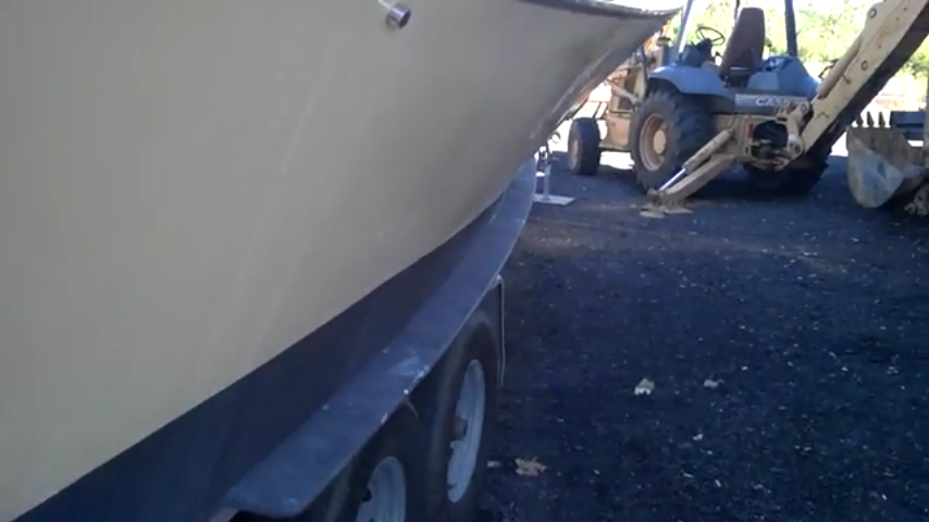

  7. boatbuilder41
    Joined: Feb 2013
    Posts: 162
    Likes: 8, Points: 18, Legacy Rep: 56
    Location: panama city florida
    boatbuilder41 Senior Member
