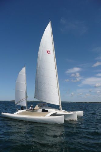

    I’m buying plans for a Newick Spark
    It has a Ljungström sail that opens like butterfly wings.
    I’m seeking suggestions on how to get the same twin sail use, as planned, with better performance and ease of use while cruising.
    Newick mentioned yrs ago how he likes the
    Whisker poles for this rig. The original builder went from the boomless rig to a boom.
    I’m thinking something in between.
    One very amateur idea I have is:
    Could you use a stiffer batten on the bottom edge of both sails?
    These battens one inside each sail, would connect
    And become a boom, so to speak.
    When your going down wind, the two battens
    release from each other, and become whisker poles.
    I have the idea for the way they Attach, and release. I also have a idea about how the other battens connect the two sails together.
    Also, with this type of rig, is a jib beneficial in any way? This boat has none
    Top photo is not the spark, just shows how the sails open.
    Bottom Photo is the Spark
    Thanks

    I have seen a Ljungström boat sail here in Sweden. The boat was beautifully Restored to perfect conditions. A real classic, but the sail tech is oldschool, although has some interesting benefits.
    If you use a boom or horizontal battens, you loose the ability to reef by rolling the sail around the mast.
    I think this rig isn't very suitable to a trimaran if you want performance. Maybe it could be easy to use if you cruise and do a lot of sailing dead downwind.

    Just a few toughts about improving the rig.
    1. Big roach square head to be supported by vertical battens.
    2. Double boom with (rigid) vang or separate deck atachement.
    3. Curved traveller without booms.
    Now the downsides to the above:
    1. Watch the sailmakers face while you drop the hints about your new mainsail: unstayed mast, continuous around mast furling, vertical battens, double sided sail. Yes it can be done just not cheap or by anyone.
    2. You have just gone from two line sailing (2sheets&furl) to outhaul, downhaul, vang, traveller lines, etc. depending on how exactly you rig the booms. Remember everything is doubled as there are two booms. Same cockpit spaghetti as with conventional slab reefing if not more.
    3. Sacrifice of cockpit space, esthetics and weight in order to avoid the booms and their lines.
    IMHO the Ljungström is best like it was designed, no booms, no battens, central sheeting. One gains simplicity and comfort and looses top end performance. That's the deal, take it or leave it, there is no improvement or underway tuning. You make your choices of mast bending and sail chamber for the expected prevalent winds and live with it in all other conditions.
