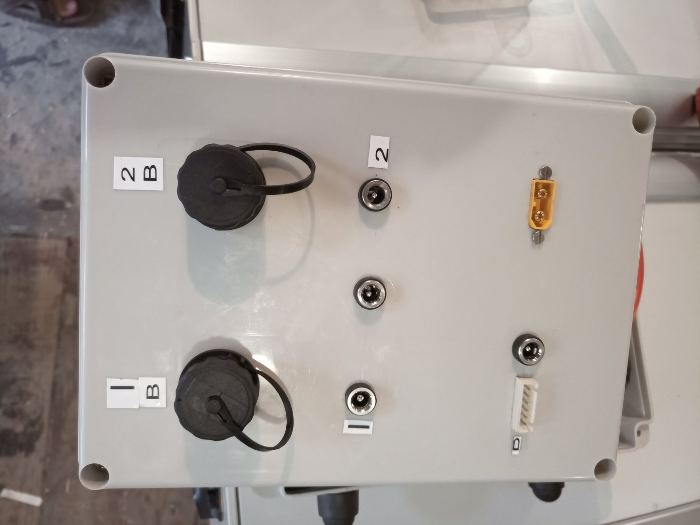

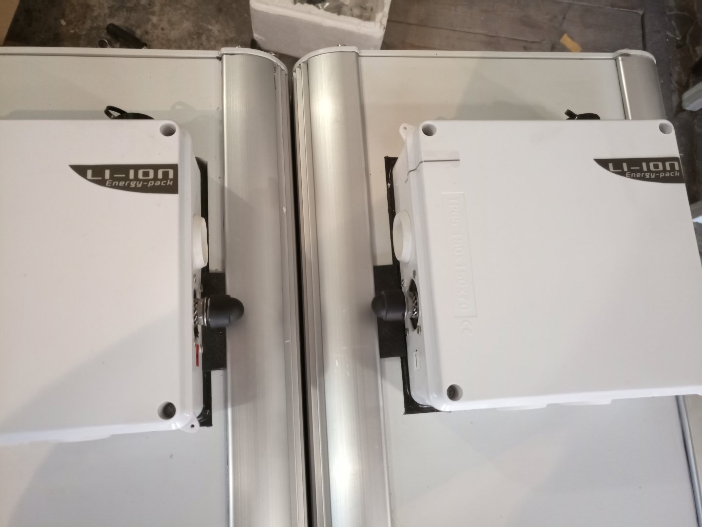

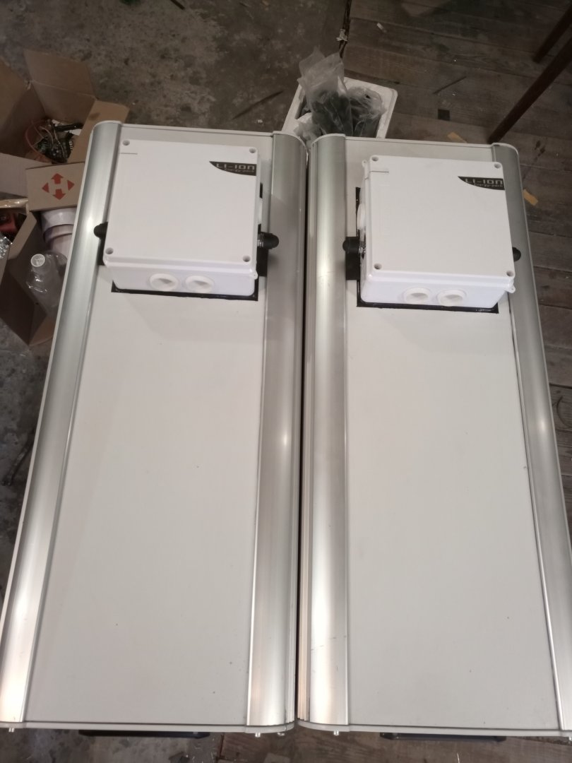

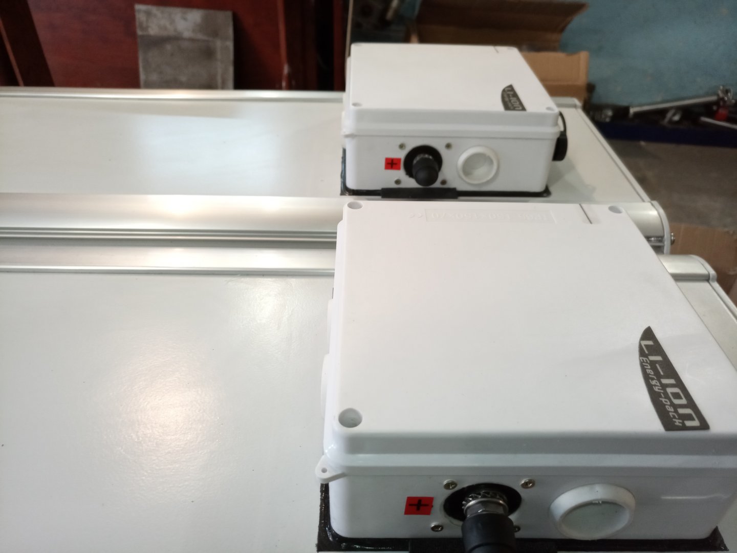

    Let me introduce our new just finished sailboat batteries )
    Specs:
    30V (8s) 235 Ah each of two modules.
    Module weight with case: 40 kg
    BMS with unlimited current discharge capability, 40A charge current. BMS have own waterproof box. Module cases is also waterproof: all joints are spilled with sealant.
    Fuses 150A at each module, temperature sensors at each.
    7100 Wh at each module.
    Modules provided by CATL company, they never was on electric vehicle before, manufactured at december 2019.
    Water tests at boat we plan to do soon.
