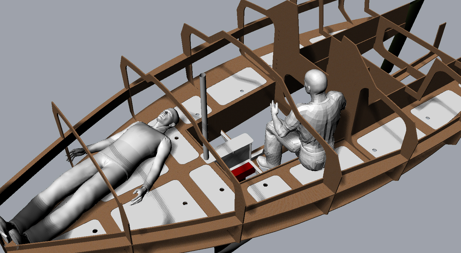

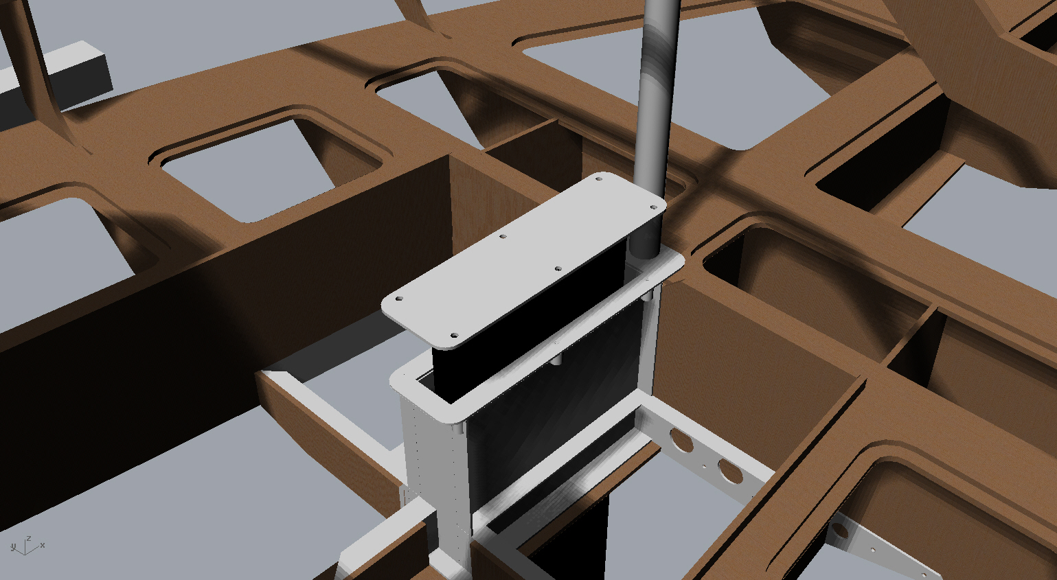

    For Lion 550 Adrenaline was the design of the keel box in the embodiment with a lifting ballast keel or a light centerboard and internal ballast.

  3. rwatson
    Joined: Aug 2007
    Posts: 6,276
    Location: Tasmania,Australia
    rwatson Senior Member
    That daggerboard takes up a lot of room internally, and interferes with the underside of the forward deck.
    What are your thoughts on a pivoting centreboard ?
    That mast compressin post is also a major interferance with the forward berth.
    What are your thoughts on a substantial mast beam support instead of the compression post ?
  4. Unik
    Joined: Dec 2015
    Posts: 173
    Likes: 47, Points: 38, Legacy Rep: 24
    Location: Ukraine
    Unik Senior Member
    Hi Ray, actually keel box takes up very little space 450х100х350 mm. in case of installation of the pivoting centerboard it will occupy three times more space. The yacht keel box will be hidden under a folding table. For easy installation of the masts spurs of the mast is on deck, so to ensure the strength under it installed pillers.

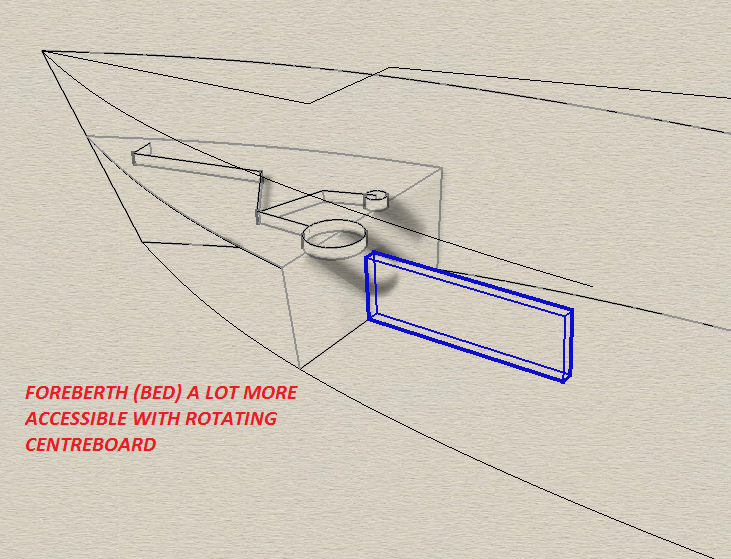

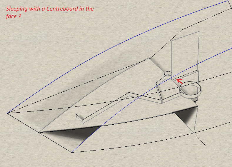

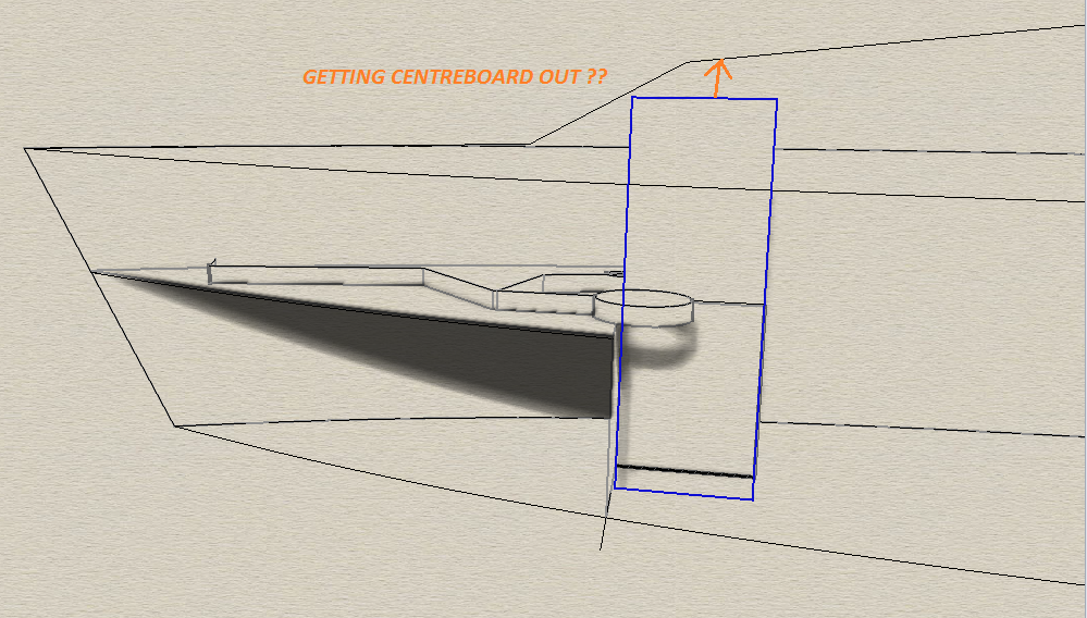

  5. rwatson
    Joined: Aug 2007
    Posts: 6,276
    Hi Yuri
    Yes, the keel box doesnt take up much space. Its the vertical Dagger Board itself that gets in the way of the forward berth. The forward berth is the prime sleeping place in these small boats, and sleeping and getting in and out is of prime importance.
    Also, getting the Dagger out of the Box can be a nuisance, and then finding some place to store the thing is also a pain in these little boats.
    The Centreboard takes up the equivalent size, inside, but in a far more convenient, low place. ALSO - when hitting an object when sailing, it can swing back.
    Heres a couple of drawings to illustrate :)

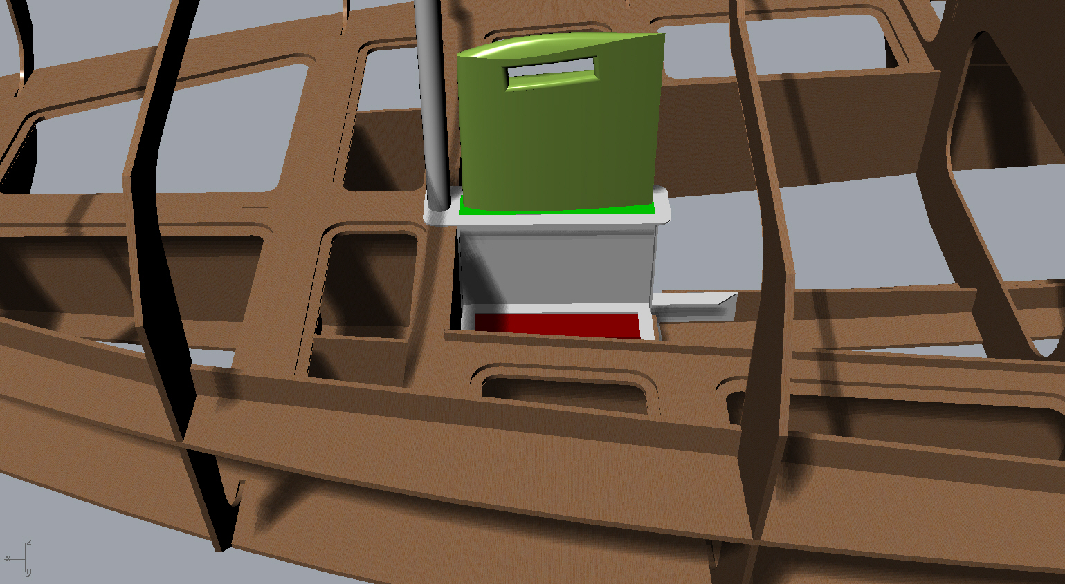

  13. Unik
    Joined: Dec 2015
    Posts: 173
    Location: Ukraine
    Unik Senior Member
    Аctually not so bad :), Lion 550 is designed as easy to build boat, so I chose option two dagger board and lifting keel, keel box is level with the seat and does not occupy much space, it is very simple to manufacture and operate. Using a different design centerboard boat will complicate and increase the cost. The Lion 800 probably use bilge keels, but simple design with no moving parts. I think that everyone in the boat should be very simple and very reliable.

  14. tane
    Joined: Apr 2015
    Posts: 326
    Likes: 137, Points: 43, Legacy Rep: 10
    Location: austria
    tane Senior Member
    looks far forward, that keel, btw...
