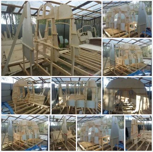

    I think perhaps I wasn't clear. I'm suggesting that this bulkhead and ones like it...
    ... would be challenging to handle, erect and wrap hull panels around due to its flexibility. Clearly, this bulkhead hasn't yet been erected nor have hull panels been wrapped around it.
    I understand that the cabin soles will provide stiffness to the finished boat - I'm suggesting that the flexibility of the bulkhead itself will create difficulty for the average kit builder.
    We get around this issue by leaving the large waste piece in the center intact until after the boat is assembled. We leave many temporary appendages on our bulkheads to provide stiffness during assembly and to facilitate alignment with a cnc-cut jig. We also cnc-cut the hull longitudinal members with keys matching slots in the adjacent bulkheads (ideally those longitudinals are cut in one piece to assure that the bulkheads remain perfectly parallel)
    I'm not suggesting that there are any issues with the boat design - it looks beautiful and strong. I'm suggesting that the design of the kit must enable the amateur builder to successfully achieve the design goals envisioned by the boat designer. (Design for manufacture)

    The idea is good, it works fine on smaller boats, but in this case not very effective. Assembled frames have enough rigidity, and after the installation of a wooden supporting straps for mounting the internal rigging has assumed an even greater rigidity, and do not need additional reinforcement. Besides, if we leave the jumpers to increase stiffness is to increase the value of kit set due to inefficient use of material.

    Today, you can draw some preliminary conclusions of the work, collected almost 80% of the parts supplied in the whale, the remaining elements of the shell plating and deck.
    All parts supplied in kit set stood in his place, great 3D puzzle LION 800 has developed into one rugged design.
    To date, the assembly boat took 20 days

    Looking forward to seeing the hull 'skins' go on.
    Questions:
    1) Do you fibreglass the insides of the hull plates before applying -( it doesnt look like you could do it easily afterwards.)
    2) Will there be access to under the floor when constructed ?
    Looking good so far

    The body is completely covered with fiberglass only outside, inside the enclosure only the frames are glued to the outer skin of fiberglass tape.
    I have provided easy access to any area of the hull from inside the yacht, it is necessary to raise the bottom ceiling, or simply open the cabinet or locker.
