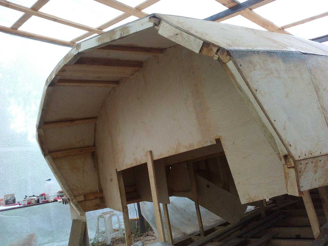

    Some more photos from the construction of the Lion 870

    The assembly of the Lion 870 yacht is completed, the further work is grinding and gluing the hull with fiberglass

    Several new photos from the build of the yacht Lion 870
    For reliable protection of the edges of the plywood from moisture penetration, the joints and grooves of the outer skin are sealed with epoxy resin with filler.

    Well, that's HALF the work/time and expense done with. The final fairing and painting, then the fittings await. It would be interesting to see if the time logging has been kept up, and the costs to date would be fascinating.

    Usually work on the construction of a yacht is conducted one day a week, today it is about 60 working days.

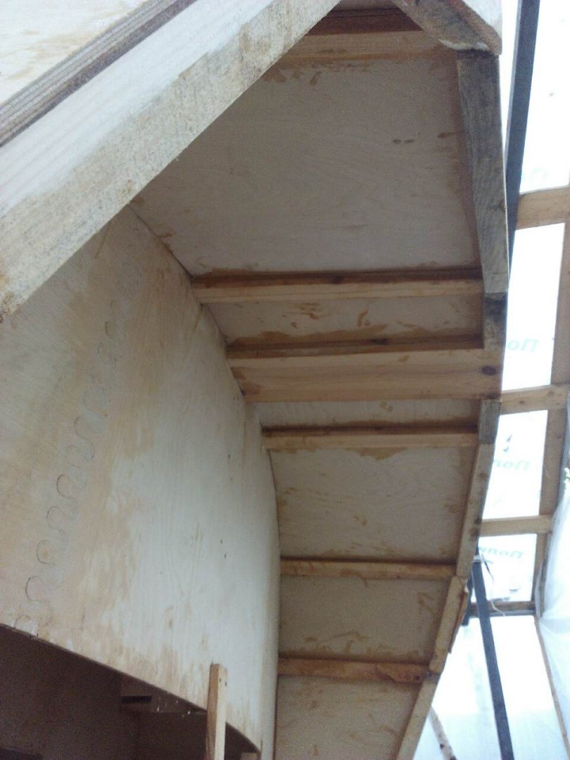

    To protect the edges of the plywood from moisture penetration, cracks are poured with epoxy resin with the addition of aerosil, for greater viscosity.
    For edge sealing, it is recommended to use epoxy resin, because the resin has a greater adhesion, in addition to filling the joint, the resin well impregnates the edge of the plywood.
    In order to prevent spreading of the resin, the seam is closed with a paint tape.

    Grinding of the outer skin of the hull, preparation for gluing with fiberglass.
    To eliminate all unevennesses on the yacht's hull, to ensure a good fit of the fiberglass, the body is sanded with sandpaper, using a hand grinder.
    The hull of the yacht is sufficiently treated with sandpaper number 80, this paper well level the surface and leave it rough enough, this is necessary for good adhesion of fiberglass.
    All the work on grinding and preparing the hull of the yacht for gluing with fiberglass took about 10 hours with 1 person working.
