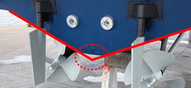

    The marketing says this boat has 6-7 watertight compartments. Have you verified those are dry, or is watertight a loose term in their marketing? If there are watertights that have been breached; a slight list would also be exacerbated as the water mass is now also added to the listing side. It is not a free lunch; so to speak. So, you must verify they are all dry or you are fighting a losing battle.
    Because the boat is a vee hull with lotsa reserve; they are tolerant of error, but not without displaying it. Think of that vee as a fulcrum on a seesaw.
