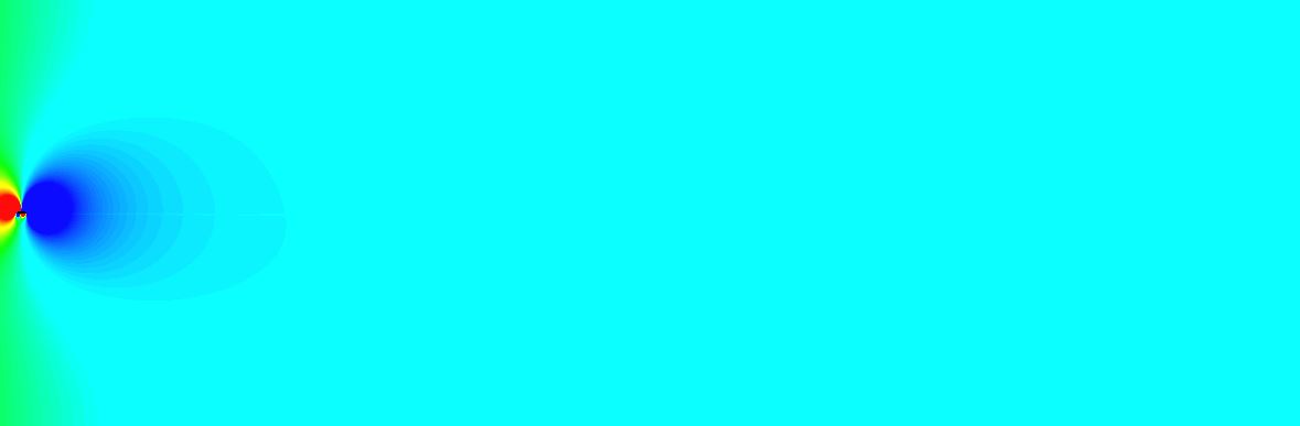

    Apologies for dragging this thread out of its peaceful slumber in the archives.
    I was just reading an Arvel Gentry article (The Origins of Lift, 2006) that mentions that "deflecting the air downward" is a three-dimensional effect. It did not sound right, so I ran a quick cfd on a foil with 1m chord and stretched the computational domain out to 150m behind with 25m above and below. I still end up with a net uniform vertical velocity component in the wake far aft- see pic attached.
    Is this different from the previously discussed definition of "downwash"?
    Or does the key to "no downwash" lie in the fact that an infinite wing that produces a finite amount of lift require the lift per unit span to approach zero?

    What were the boundary conditions? If you let everything escaping out the bottom reappear at the top, you are modelling an infinite stack of airfoils, and that has a different sort of 'farfield' law than a single airfoil does.

    If you are simply setting freestream flow at the inflow, then the right way to do this study is to increase the flowfield grid equally in all directions, so that it remains a square with the airfoil in the center. You should find that as you make the box bigger, the downstream downwash magnitude gets smaller in inverse proportion: Doubling the box size halves the downwash. In the limit of an infinite box the far-downstream downwash is zero.

    Thank you, my results check out.
    It is really nice to have the Clever League on speed dial.
    How does Tom Speer's comment in post #18 tie in with all of this? It reads as if finite lift is a condition for no downwash. If I am measuring a finite amount of lift on my 2D unit of span, does that not translate to infinite lift over an infinite span?

    The 2D wing is "less infinite" than the unbounded flow around it. Or another way to look at it: A 1-meter span section of a 2D wing is finite and has a finite lift, but it imparts this finite lift force to an infinite amount of fluid below and above it. So the resulting velocity of this infinite amount of fluid is zero. This is partly arm-waving, but should get the point across.
