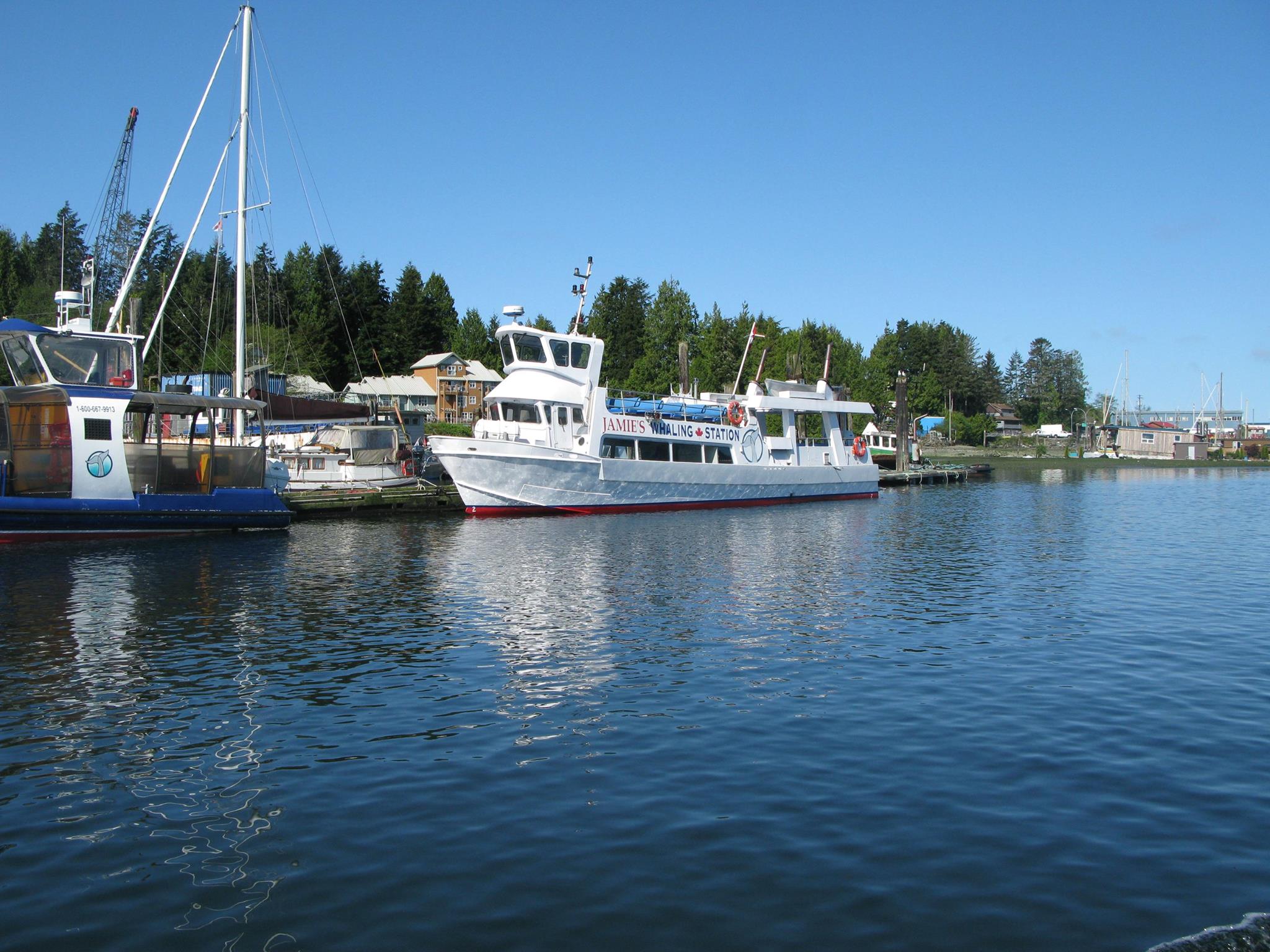

    That ship, fully loaded, can weigh, say 65 tons. Suppose at the poop deck were 20 people, 1.5 tons. That weight to one side, there should be no danger to the ship.
    What is worrying is the low freeboard that, as seen in the picture, has the boat.
