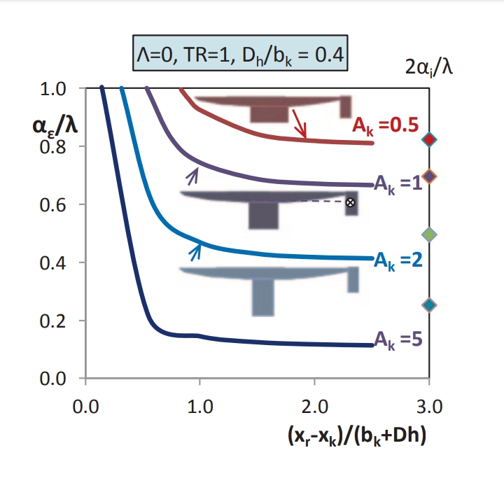

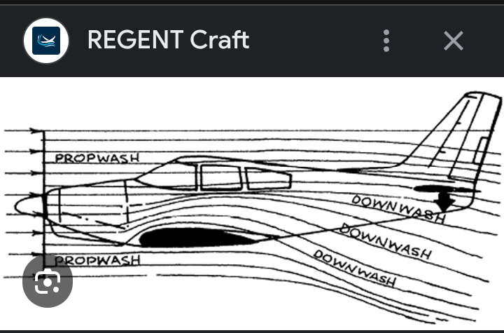

    If the keel is a low aspect ratio keel and the rudder is directly behind it, then the rudder works in a very deflected flow: a big downwash, which here should be called side/downwash
  2. CarlosK2
    Joined: Jun 2023
    Posts: 1,489
    Likes: 122, Points: 63
    Location: Vigo, Spain
    CarlosK2 Senior Member
    0.8 means that the Rudder lost 80% Angle of Attack
    For example
    Yacht Yaw/Leeway 6°
    Hull (mister Max Michael Munk) Angle of Attack 6°
    Keel Angle of Attack 6°
    Rudder behind a low Aspect Ratio Keel Angle of Attack 1°

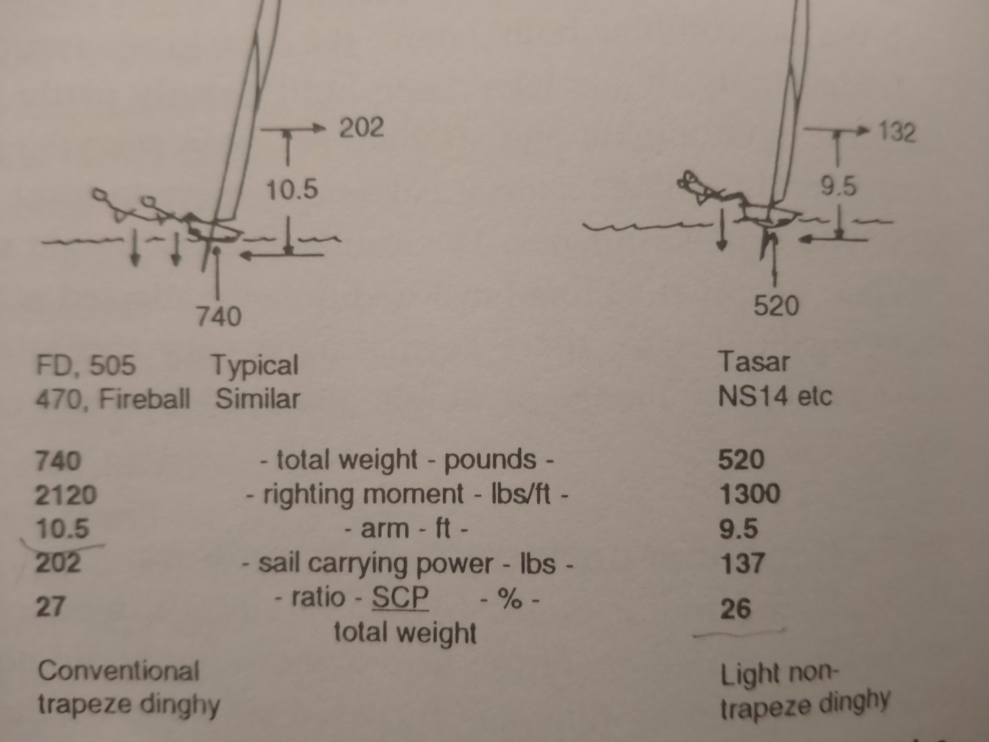

    60-foot IMOCA (about 15 years ago)
    Sail Carrying Power
    % Displacement
    60-foot IMOCA @ 15° Heel: 19%
    599 @ 15° Heel: 15%
    470 Dinghy: 27%
    A Dinghy: 19% - 27%
    470 Dinghy: 27%
    (Frank Bethwaite)

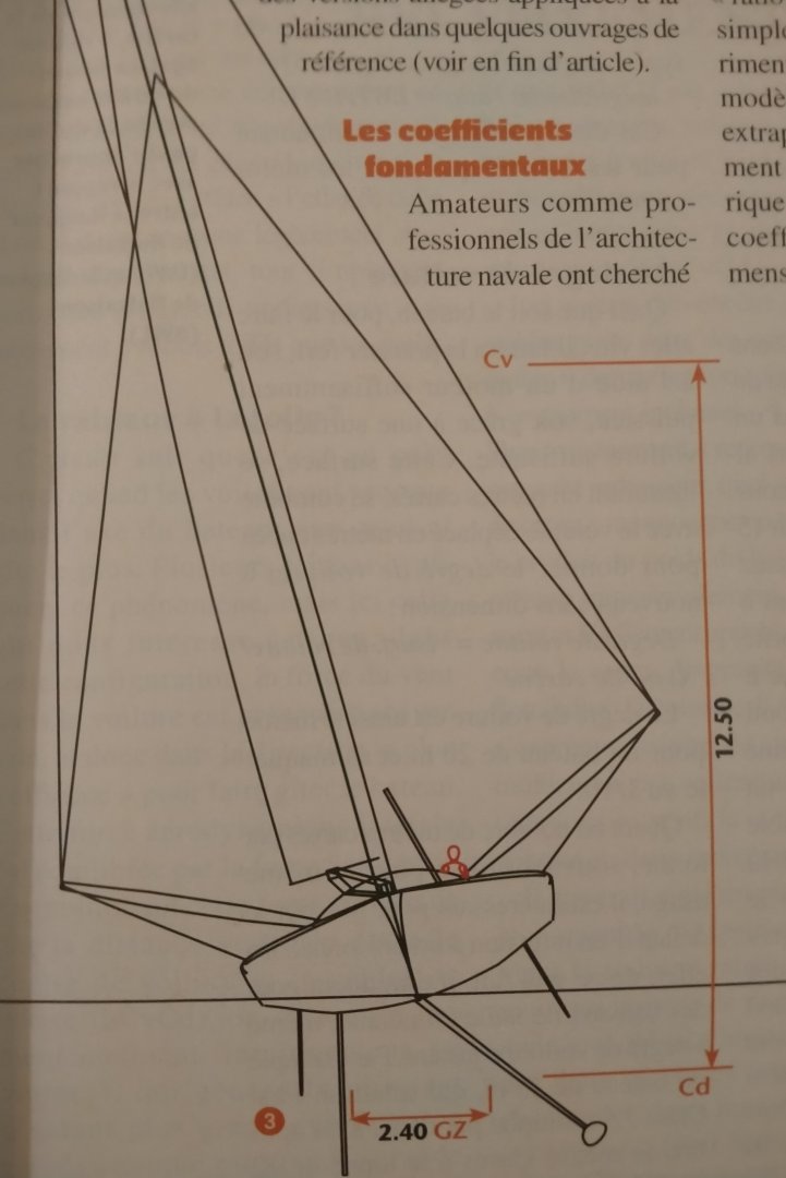

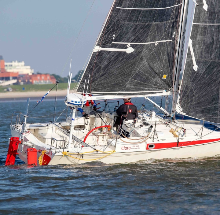

    Note two things:
    First, with a 15° heel, the plywood epoxy boat rises more than 1.4 (!) meters in height. Compare this to a Dragon or a Tumlaren, which sailed in the water instead of on top
    I mean, with 25 knots of wind, the Aero Drag is significant
    Second, note that in these types of light boats, controlling the Heel is crucial to prevent the centerboard root from showing out of the water and/or more interactioning with the hull wave
    (The position of the 3-in-1 system—mainsailsheet, vang, and preventer in a 2 meter (!) traveller—clearly does not correspond to the wind coming from the starboard side. This position is for Downwind)
    With two rudders, the upwind rudder is raised and the downwind rudder is lowered. The difference in induced drag is enormous compared to a heavy yacht with a skeg.

    (Blue Storm 800)
    BLUESTORM 800 8 metre centreboarder by Keith Callaghan https://www.bluelightning.co.uk/ts/BS800.shtm
    The old sailor's position is similar: seated forward of the enormous traveller, not behind it. In my case, the boom reaches all the way to the transom.
    My antennas are fewer: AIS B+ (5 W) at the very top of the mast
    7" KP-27A with AIS Transmitter/Receiver. https://avesmarine.com/7-kp-27a-ais-transceiver
    VHF aft on the starboard side
    GX1410 https://www.standardhorizon.com/product-detail.aspx?Model=GX1410&CatName=Fixed%20Mount%20VHF
    and a clumsy radar reflector on the port side.

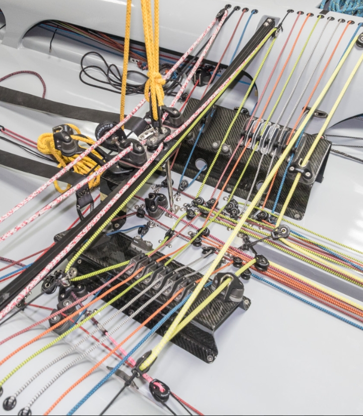

    (Flying Dutchman)
    A lot of ropes on a sailboat
    1 Ton WindSurf Board for an old sailor
    Staysail on boom
    + 1 halyard
    + 1 line to tension the luff from below
    + 4 lines for angle of attack: two (port and starboard) duplicated, passing through a pulley on the boom
    + 1 for twist control
    + 1 for camber
    + 2 for reefing
    + 1 for lowering the sail
    = 11
    MainSail on boom
    + 1 (3 in 1) MainSail sheet, vang and preventer
    + 2 traveller
    + 7 reefs and outhaul
    + 1
    = 11
    Gennaker A5 on 3 (!) meter Bowsprit
    + 2
    + 1
    + 1
    = 4
    No BackStay
    + 1: The line for tensioning the mainsail halyard is missing
    The single winch is for raising the massive keel, and in case it's needed for either of the two anchors: the sand/mud anchor (Mantus M1) and the sea anchor (Lalizas)
    Sea Anchor (Drogue) | LALIZAS https://www.lalizas.com/products/mob-systems/sea-anchors-drogues/sea-anchor-drogue
    The lines for the gennaker and the staysail can also be run to that single winch.

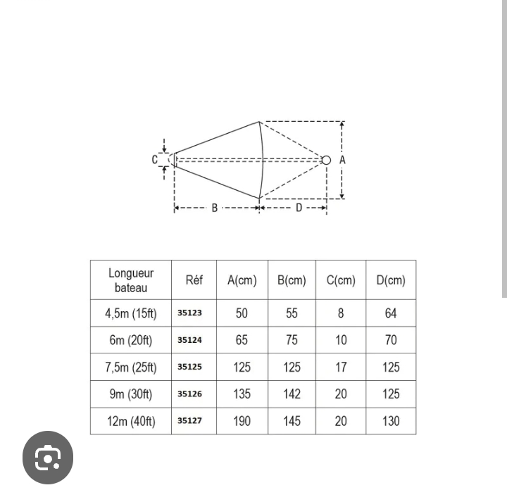

    Achtung
    Caution

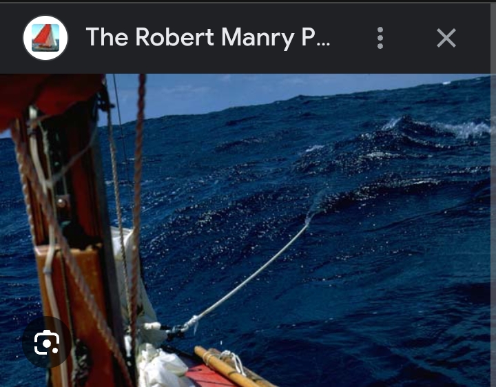

    Lalizas sea anchors are sized as "drag devices," meaning they are designed to slow down a sailboat that cannot Surf
    Remember that this Tiki 21 in these images is using a 2-meter diameter sea anchor:
    Nearby was sailing an old MiniTransat just like the one I own; it had no procedure for stopping and remaining safely stationary, and it lost its mast and was rescued by a merchant ship.
    Robert Manry removed the rudder and thanks to that his small boat anchored very well in the sea with a canvas bucket
