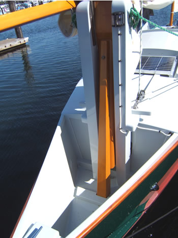

    Gonzo, I’m thinking the masts will be right around a fore full bulkhead, with full bury in the hull. I’d pictured a hinged tabernacle abovedeck, with a line run underneath the notched mast base acting as a 2:1 block to lift the mast, then using the windlass attached to a line on the mast base to control lowering the mast, but Rob’s idea seems simpler. I can think of several feasible ways to lift the mast from the post hole. More thought is required certainly, but I don’t think stepping and unstepping the mast is going to be the limiting factor. My next best alternative would be an A-frame, but the trade offs aren’t worth it for my purposes.

    By far the simplest, quickest and easiest way to raise/lower an unstayed mast is a trench in front of it and a pivot at the deck bearing. If you have enough space for the trench and are raising/lowering regularly, this is the way to go. With a bit of organisation, the rig can stay attached.

    Bolger had a solution for a selfstanding mast and a tabernacle. He designed a slot on the deck for the buried section of the mast to come up and above the deck. Block and tackle at the foot of the mast is used to bring it up and control it going down. It precludes the mast being all the way forward, and needs a bulkhead aft of it.

    I’m familiar with the Bolger tabernacle and the trench, but have trouble trusting it to a 50m2 sail on a stable cat. My tabernacle idea incorporated elements of this, but is still in the works. Topic for another thread.
