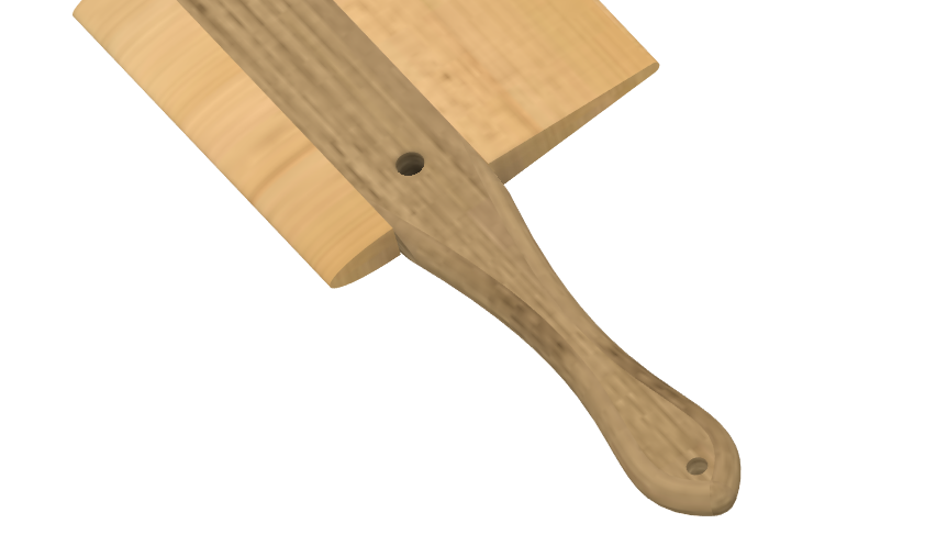

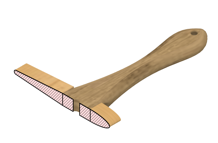

    I am wondering a couple things.
    -If making the 'cricket bat' looking leeboard, would the handle piece be better as hardwood and then the leading and trailing edge could be a softer/lighter wood for foiling?
    -Would a foil with a flat section also facilitate the manufacturing and bearing against the boat?

  10. Samwise1983
    Joined: Apr 2026
    Posts: 6
    Likes: 0, Points: 1
    Location: Northern Ireland
    Samwise1983 Junior Member
    This could definitely be a good option, thanks!
