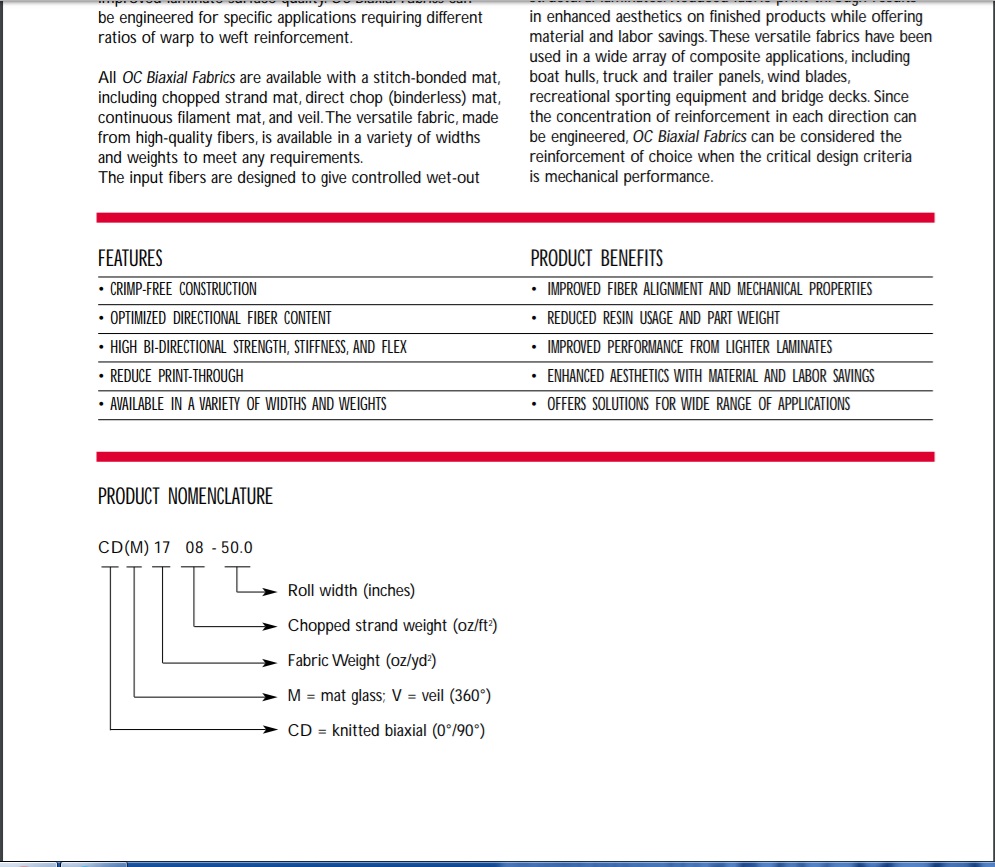

    OK found it. This should educate us all. Searching Knytex, Owens Corning came up.
    Seems that this manufacturer uses oz/yd2 for fabric and oz/ft2 for mat. It uses M for mat, and V for veil cloth as there are fabric suppliers that supplies Biax/BD with veil cloth in the 50grs/m2. When it is 280 grs/m2, it is described as light mat.
    Since the fabric in topic is DBM 1715, It can be interpreted as a 17 oz/yd2 fabric + 15 oz/ft2 mat. Whoa, that comes out to 137 oz/yd2 of mat. That means if we follow the original data by Knytex where it say 1.5 oz mat (they meant 1.5 oz/ft2=13.5 oz/yd2). Confusing.

    The mat then accounts for almost half the weight of the cloth. That's a significant amount of the weight associated to the laminate. The other schedule called for 34oz. WR I'd need to look to see how much mat was called for there I believe it was similar.
    Since it's against the core it doesn't provide impact resistance? If not what strength does it provide? Thanks so much for the replies I've learned a lot.

    Scuff- Nothing to do with impact resistance. Its main purpose is to provide a good adhesion from the biax to the rough core. Sometimes called the bondline.
    The mat also serves as promoter of adhesion when the lamination stops for more than 4 hours and may require sanding in between coats.
    When laid up continously, layer by layer, "wet on wet", a 1.5 oz/yd2 of veil cloth will suffice as interface.

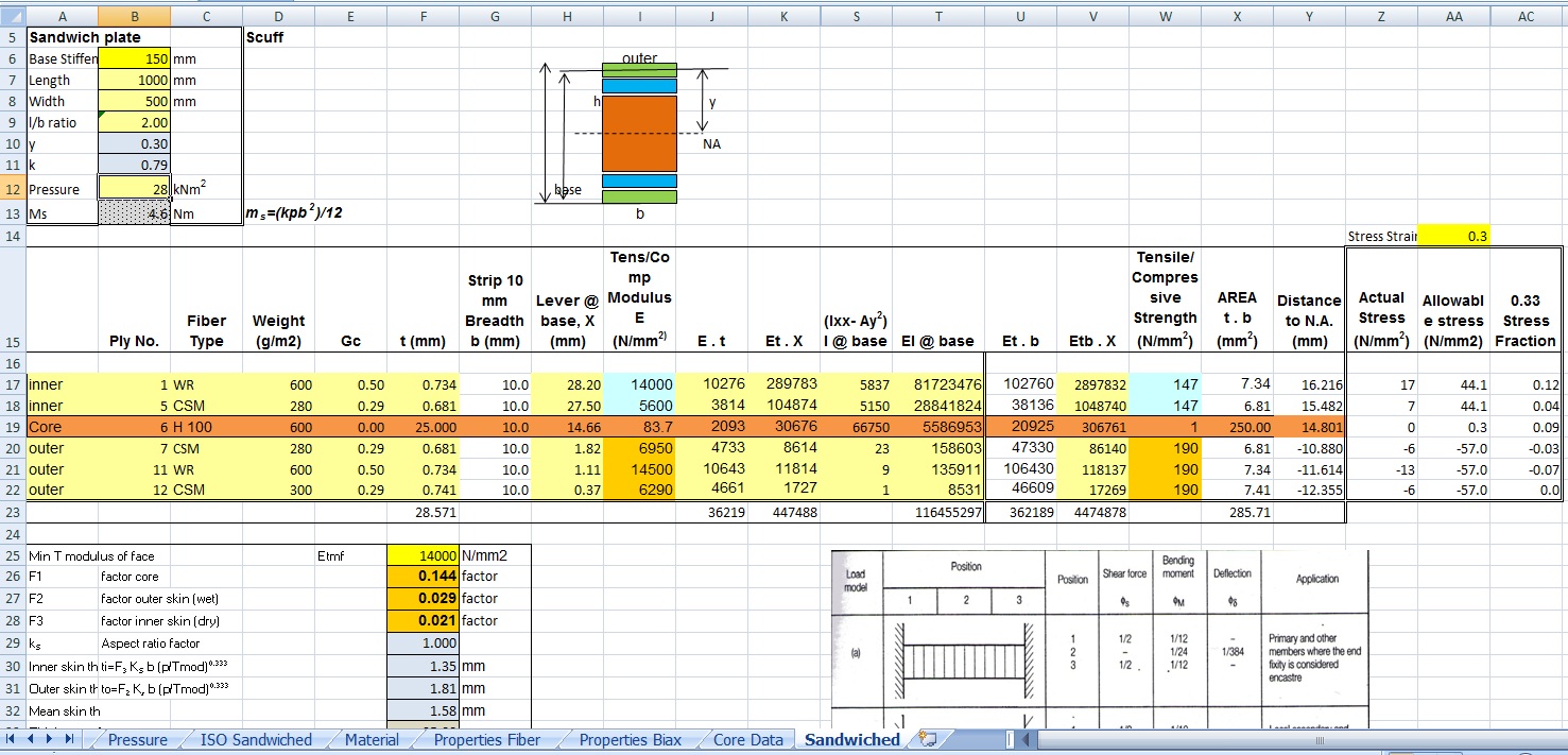

    Its been a long time Scuff but I noticed in my library I did play with your design to evaluate. I used ISO and played around with 1 meter length panel and a 25 mm core. With 28 kN/m2 of bottom pressure, planing craft mode, I can get by with just a layer of 600 gr/m2 of fabric with a light CSM for corebond. The skin is not even stressed to the limit. 0.3 is the max stress ratio and I am getting only 0.1.
    If you look closely at the right hand side equation, the stress diminishes from the outer layer to the inner layer. The second layer, though a CSM, is not even stressed.
    3 layers of 1715 seems overdesigned.

    It's a single layer of the 1715 .. the three layers is just at the keel. That was what I was thinking that the mat was for a good bond between the core and laminate. What would be a good weight of CSM to use as a veil? Thank you!!!
