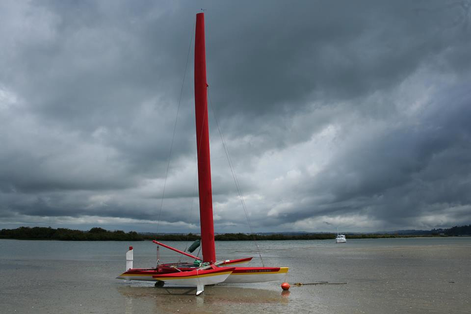

    Hauraki Gulf sailing on Groucho. Second photograph is at Otata Island at the Noises. Originally named Les Noisettes by Du Fresne- because shaped like knuckles of a hand. You can see them in distance in first photograph. Beautiful place. Third shot is at Waiheke Island.

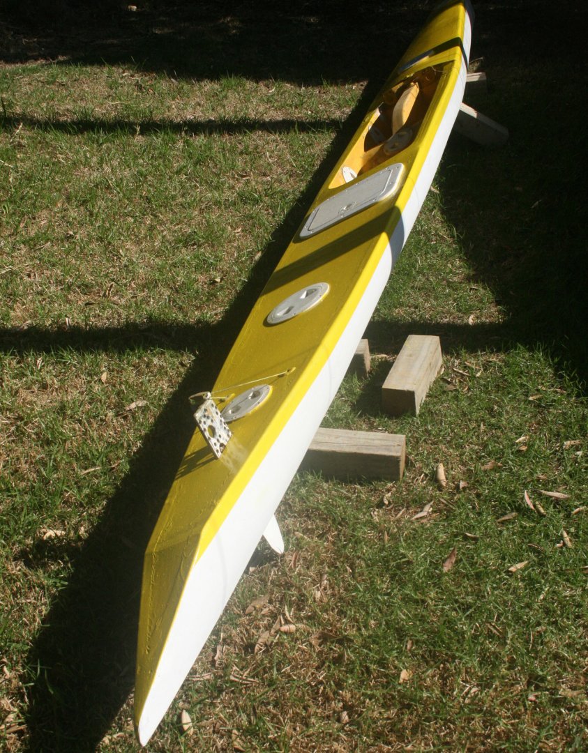

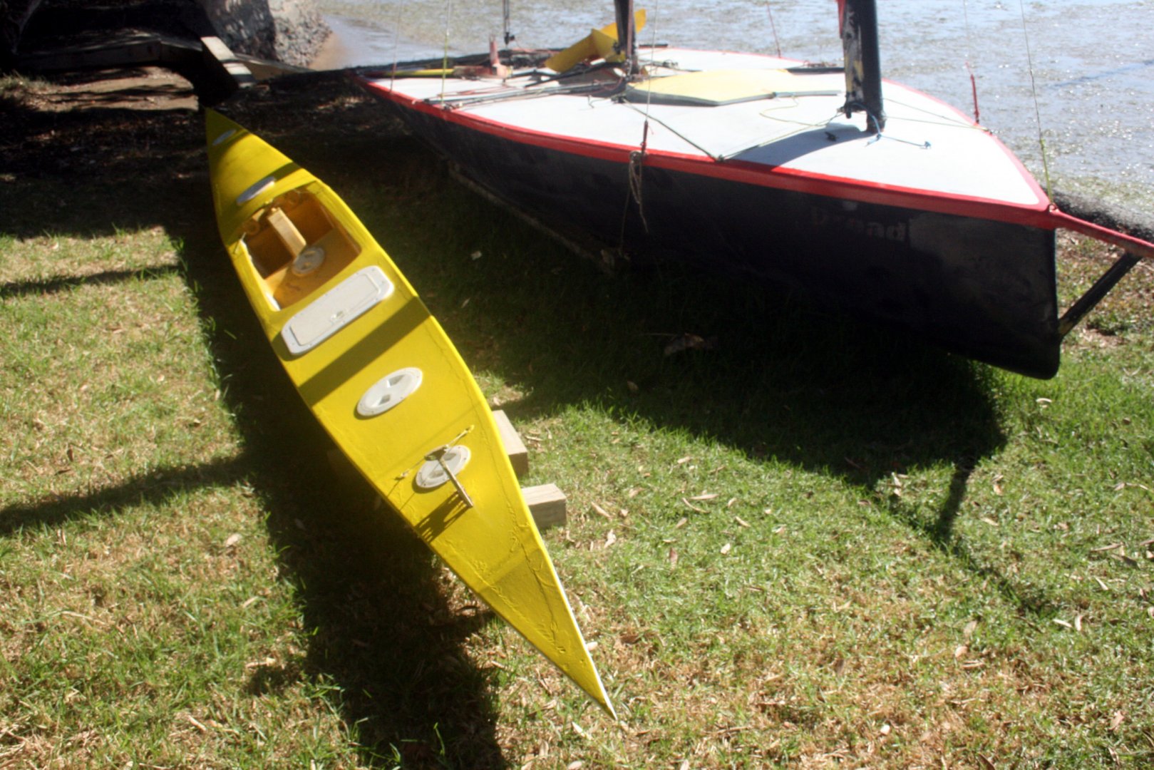

    Cannot sail here yet so fixed up my 20 year old 6 metre x 20cm sit on top kayak. Sailboards and SoTs are legal. Cleaned, repainted and polished. Fast and very light boat. Definitely blew the no sailing cobwebs away.

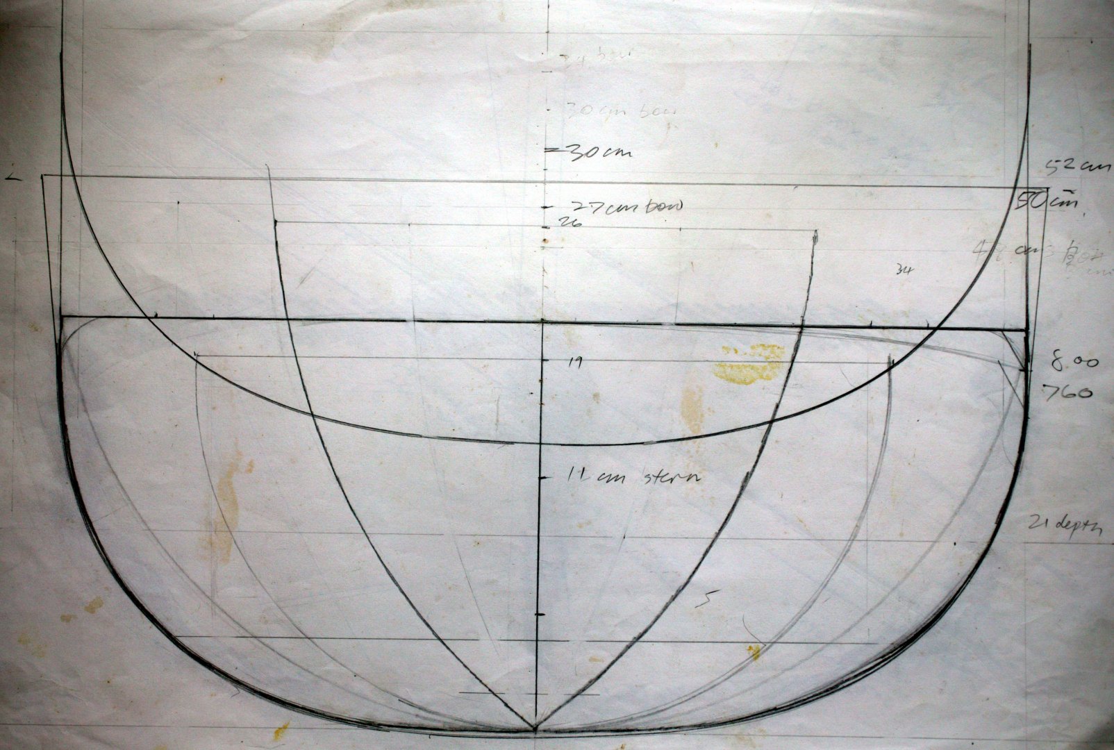

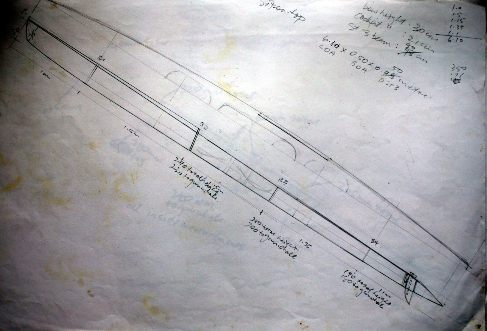

    Gary,
    Do you have any drawings or images from the construction of this sit on top?

    Here are the fairly crude plans: measurements in metrics, sorry.
    3mm ply, glassed.
    Correction from earlier post on this craft: 6.1m x 0.52m - the latter correct measurement is approximately 20 inches - whereas I had typed 0.20cm, wrong.
