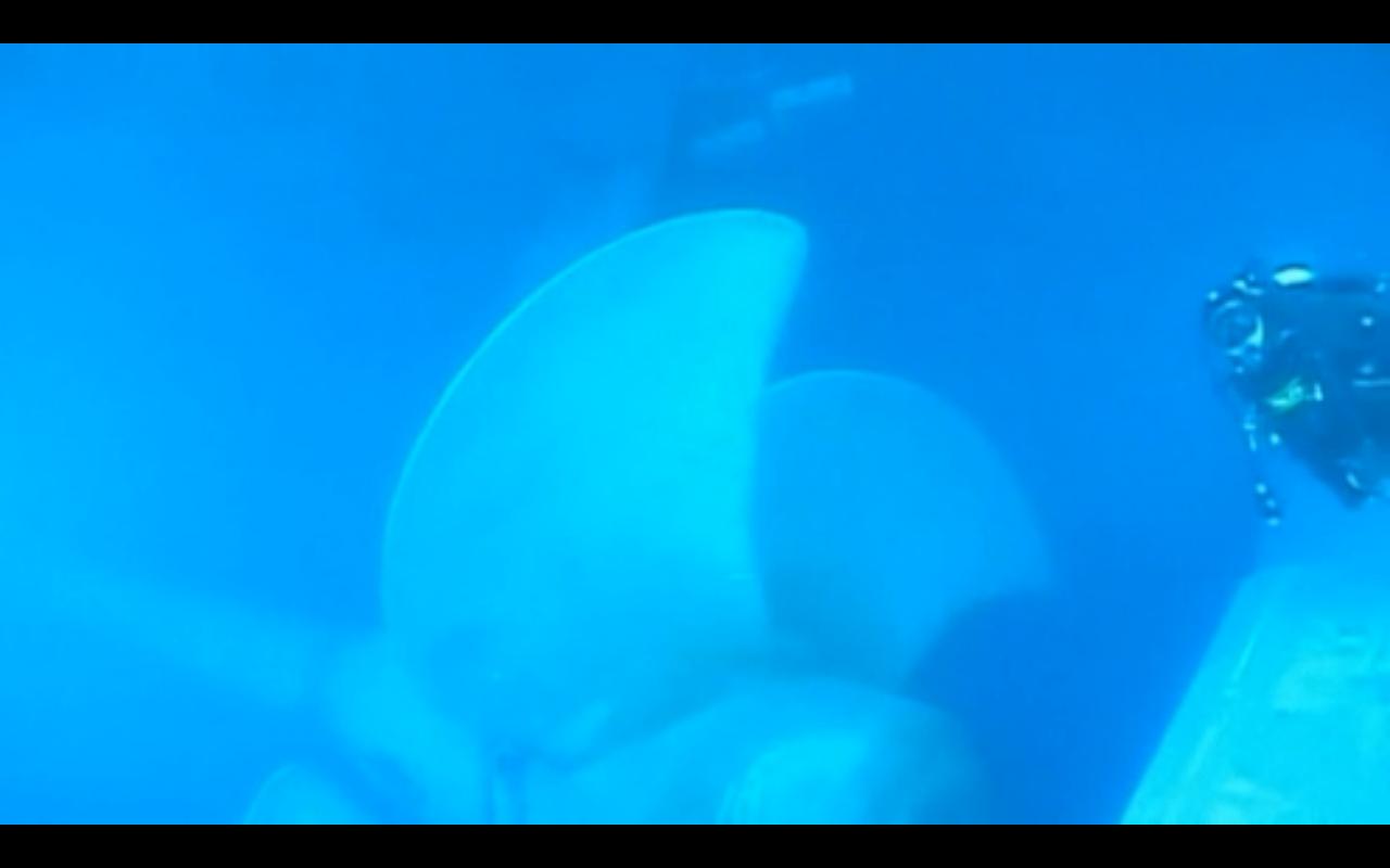

    Spotted one of CC's props on this video (13 to 20 sec - after the ad), took a screenshot, it's a left handed prop (anticlockwise forward thrust), think it's on port side but not sure about that, in contradiction to Wiki CC info ‘‘two fixed pitch propellers’’ it looks to be a variable pitch propeller . . ? ?
    click pic to enlarge
    So, it's for sure not what I asked for in post#751 if CC could have two right handed props :)
    Now waiting for a picture of the other prop and confirmation of the side . . . . . . :?:

    Angel,
    That is probably the port side propeller. It looks to me like a fixed pitch anticlockwise turning one. Starboard propeller should turn clockwise then.
