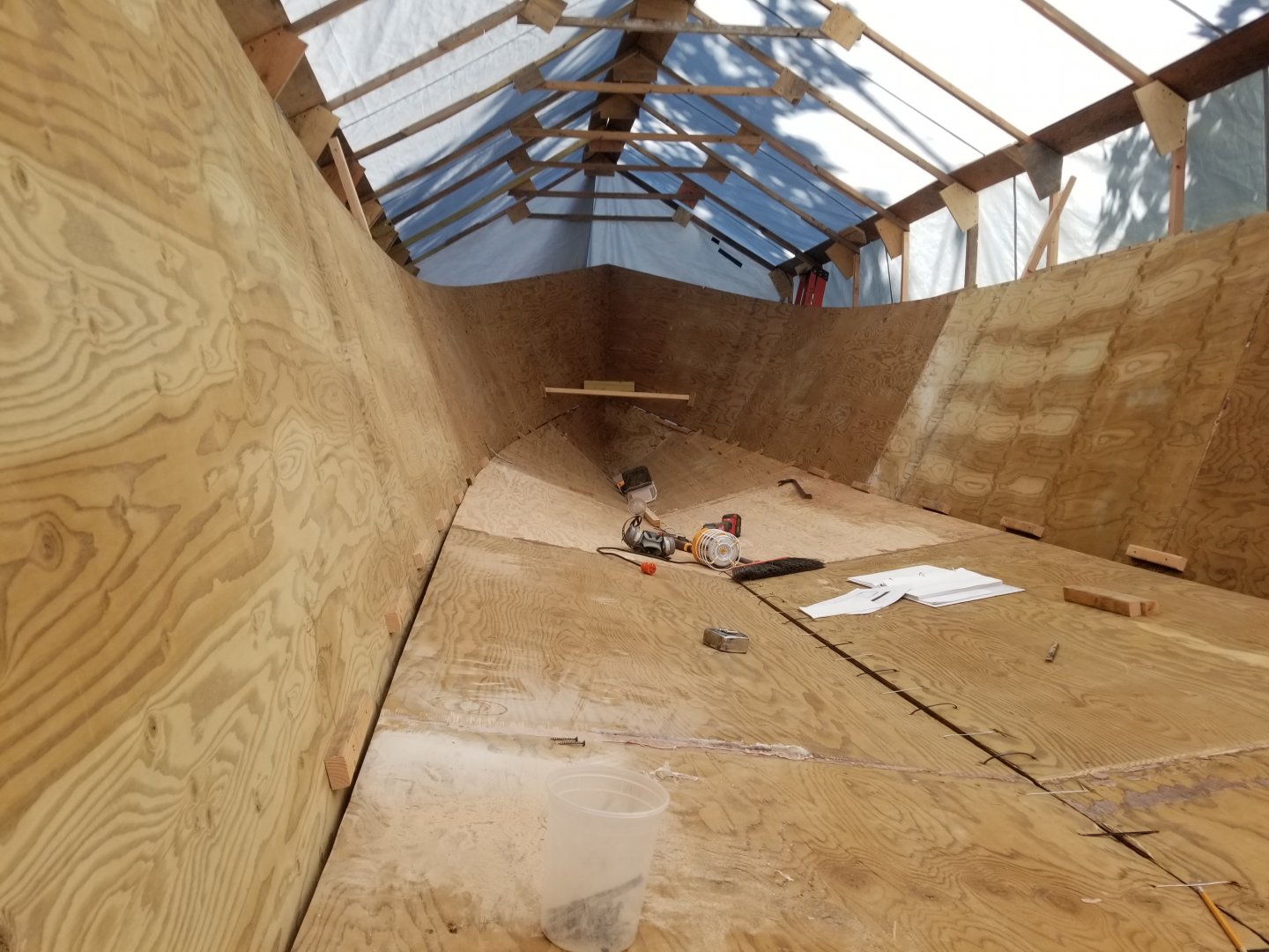

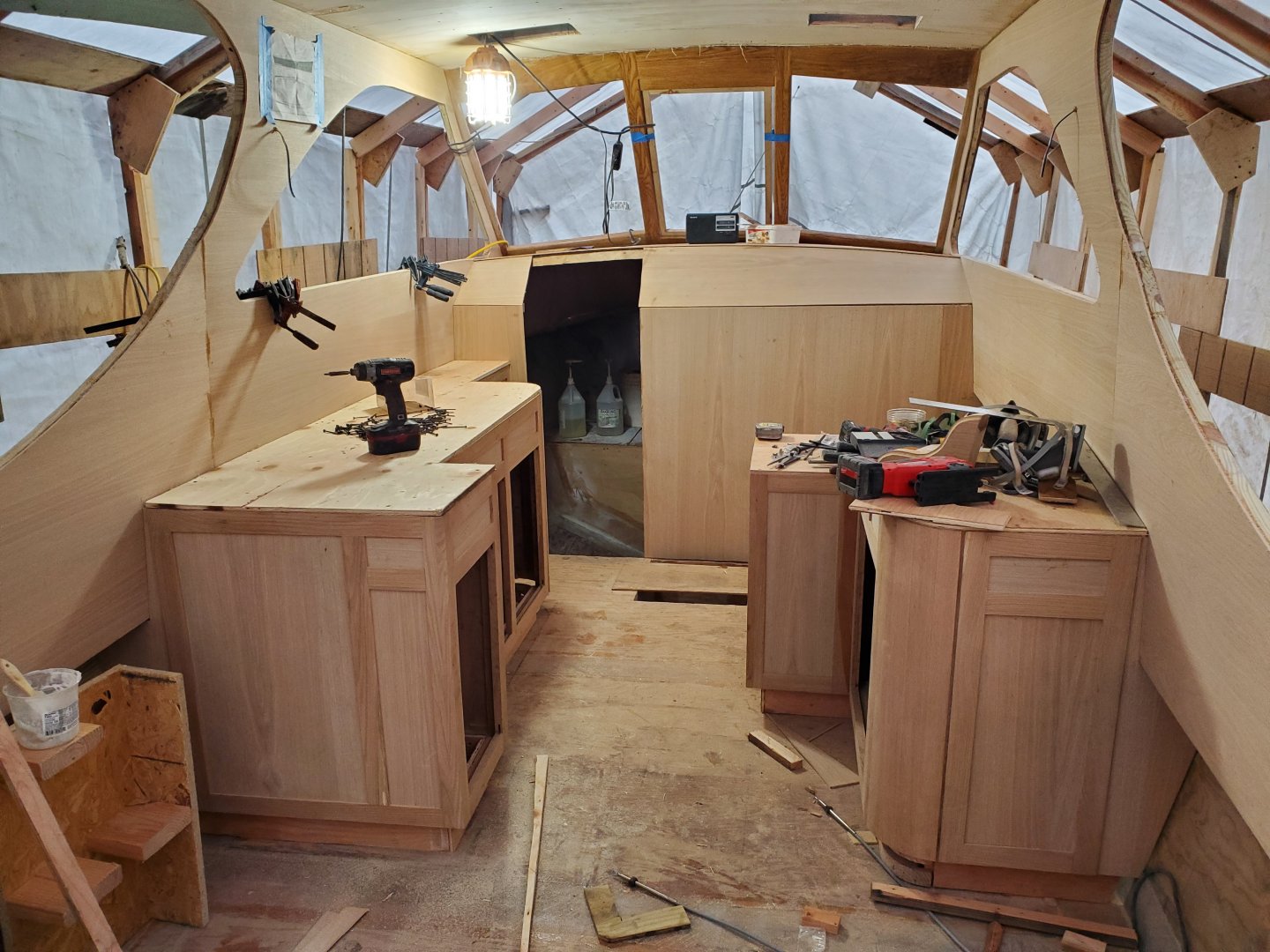

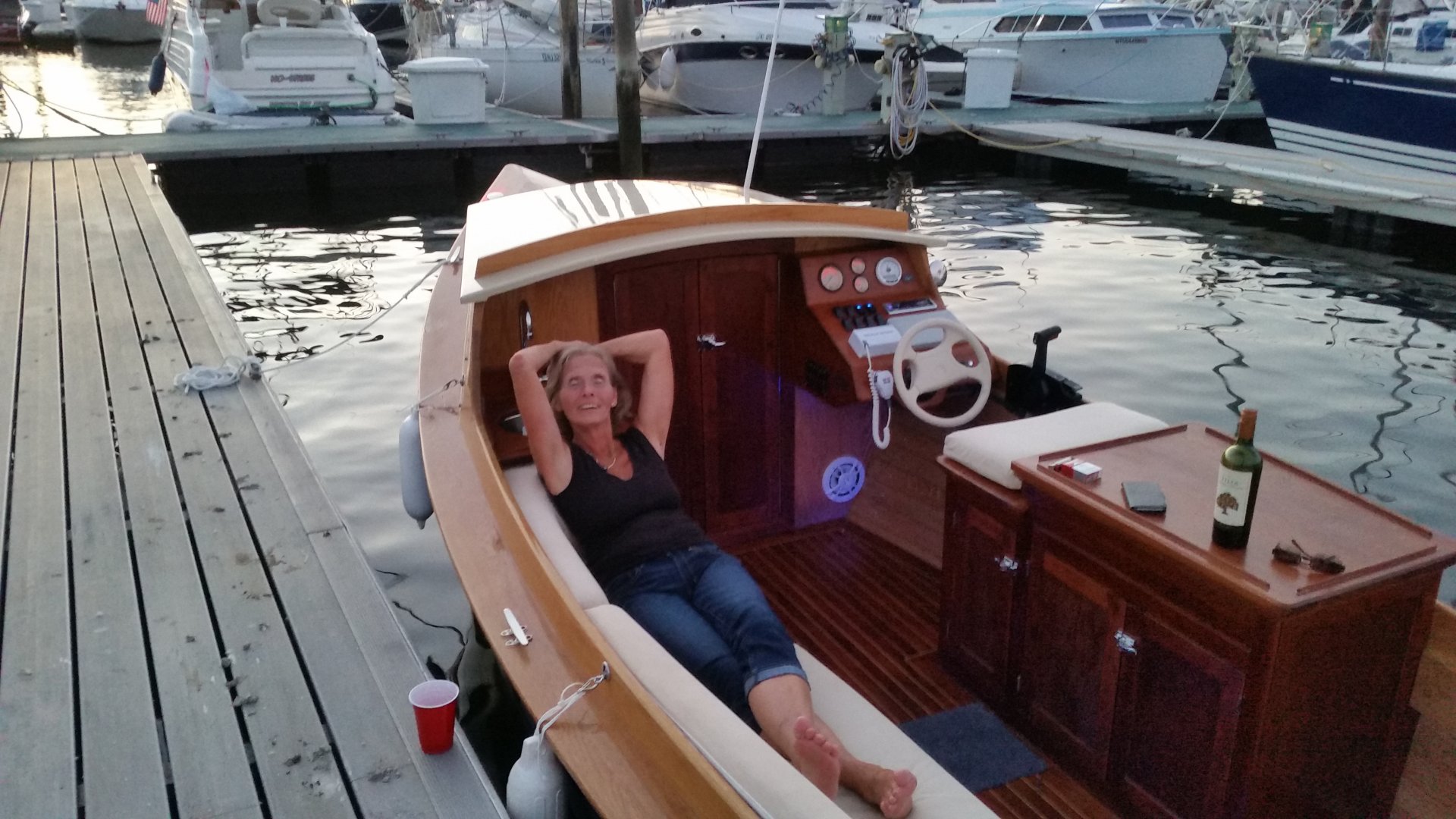

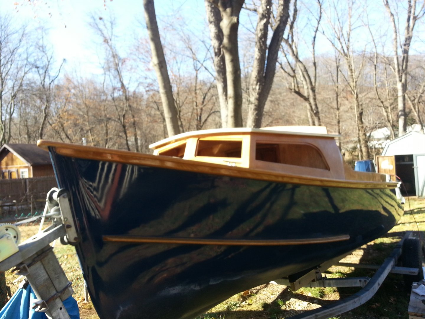

    194089-377c565a9106639e92c8c5179c514155.jpg So I started this boat build 5 years ago and I always liked the look of the Downeast boats. To me the style is always current as long as the boat is clean and maintained. So, as I'm pushing 76, this is my last build. Being thrifty [cheap ____ ] I found a set of plans for a 28' boat that uses a 90hp outboard. The plans are from Tom lapthrope 20160819_195815.jpg /Bluejacket Boats. I had a 90hp from a previous build so I figured "You don't get better then this". 20141207_114701 - Copy.jpg 19' Downeast from a previous build with the 90hp outboard.

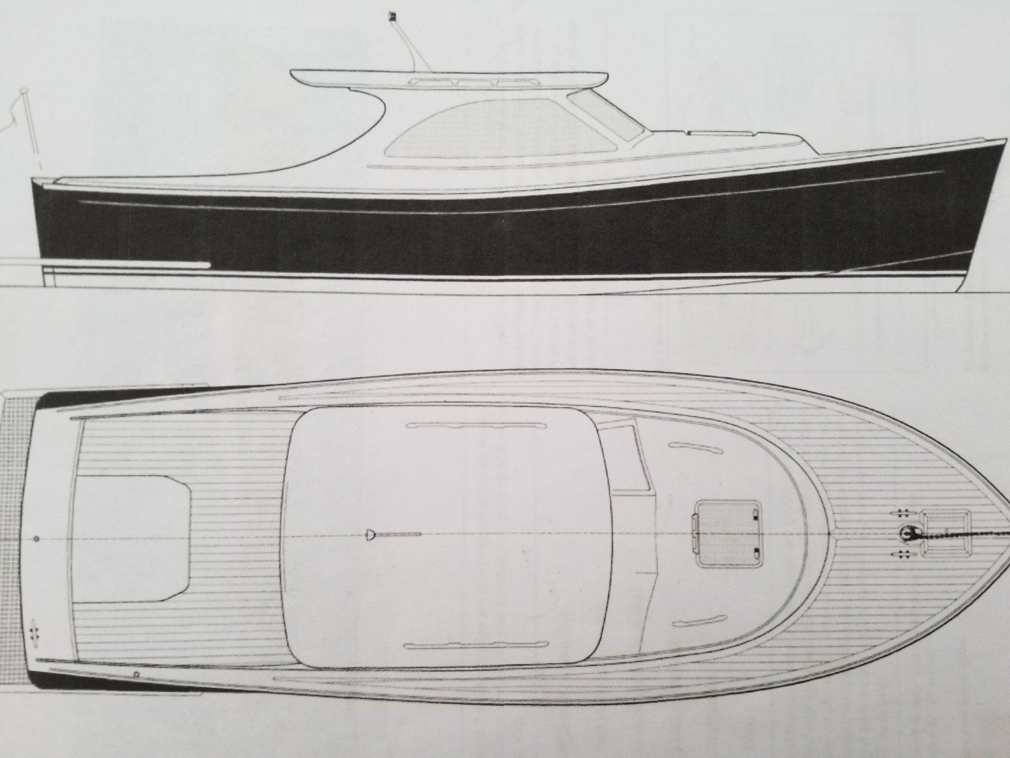

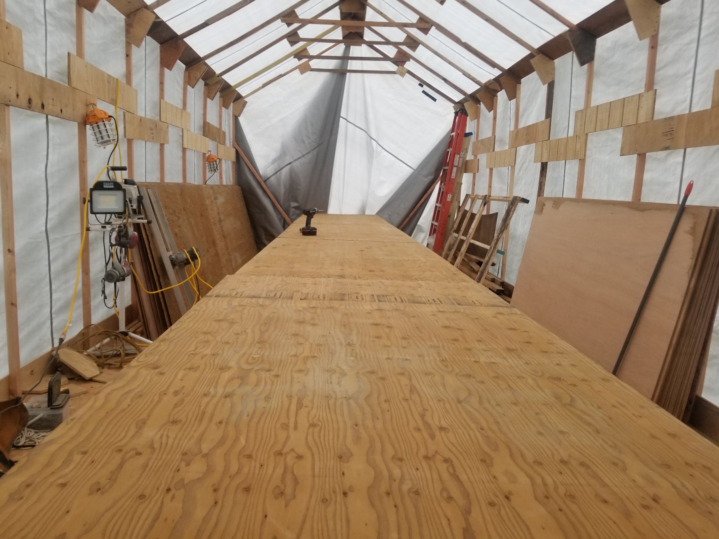

    Searching the web I found a drawing of a boat that I liked so I printed the image and scaled it for a 28-30' hull to fit the Bluejacket hull. 20210425_185951.jpg At this point it was a go. I ordered the plywood and then built a tent in my back yard 20240719_133431.jpg This image is when I was tearing down the tent.

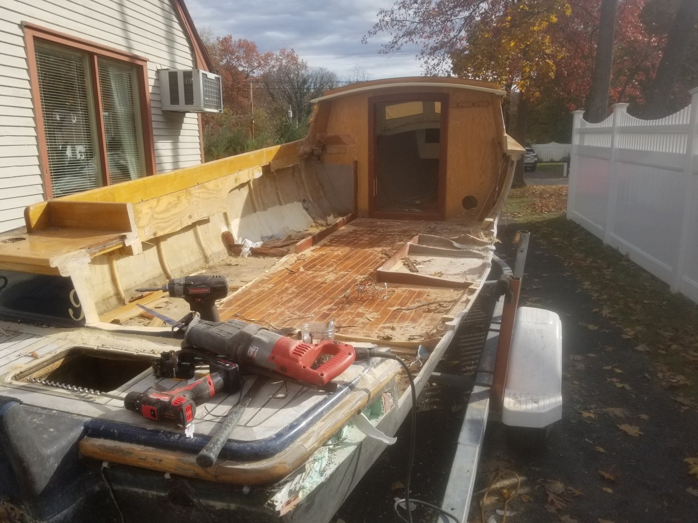

    So to keep costs down, I decided to cannibalize the previous boat for parts. 20211113_115026.jpg
    Cut up cannibalized and put in a dumpster.
    started assembling the hull with the help of my older brother. 194097-e26c0aedb9ea2318bf0f09db53cc06f9.jpg 20210515_093600.jpg 20210515_103124.jpg 20210527_162305.jpg

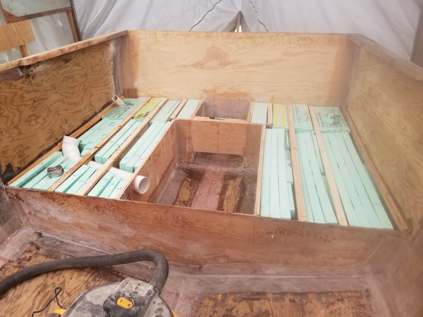

    Next came the sole [floor] with some foam added for flotation according to Tom

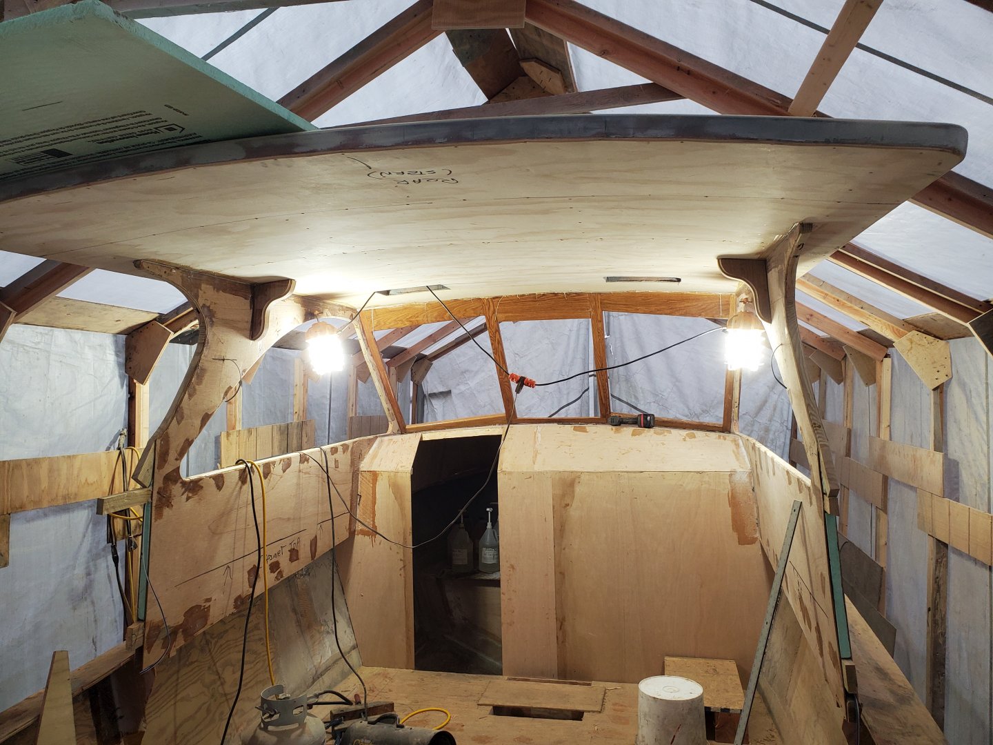

    20210922_124156.jpg The the superstructure
    Some cabinets
    More to come

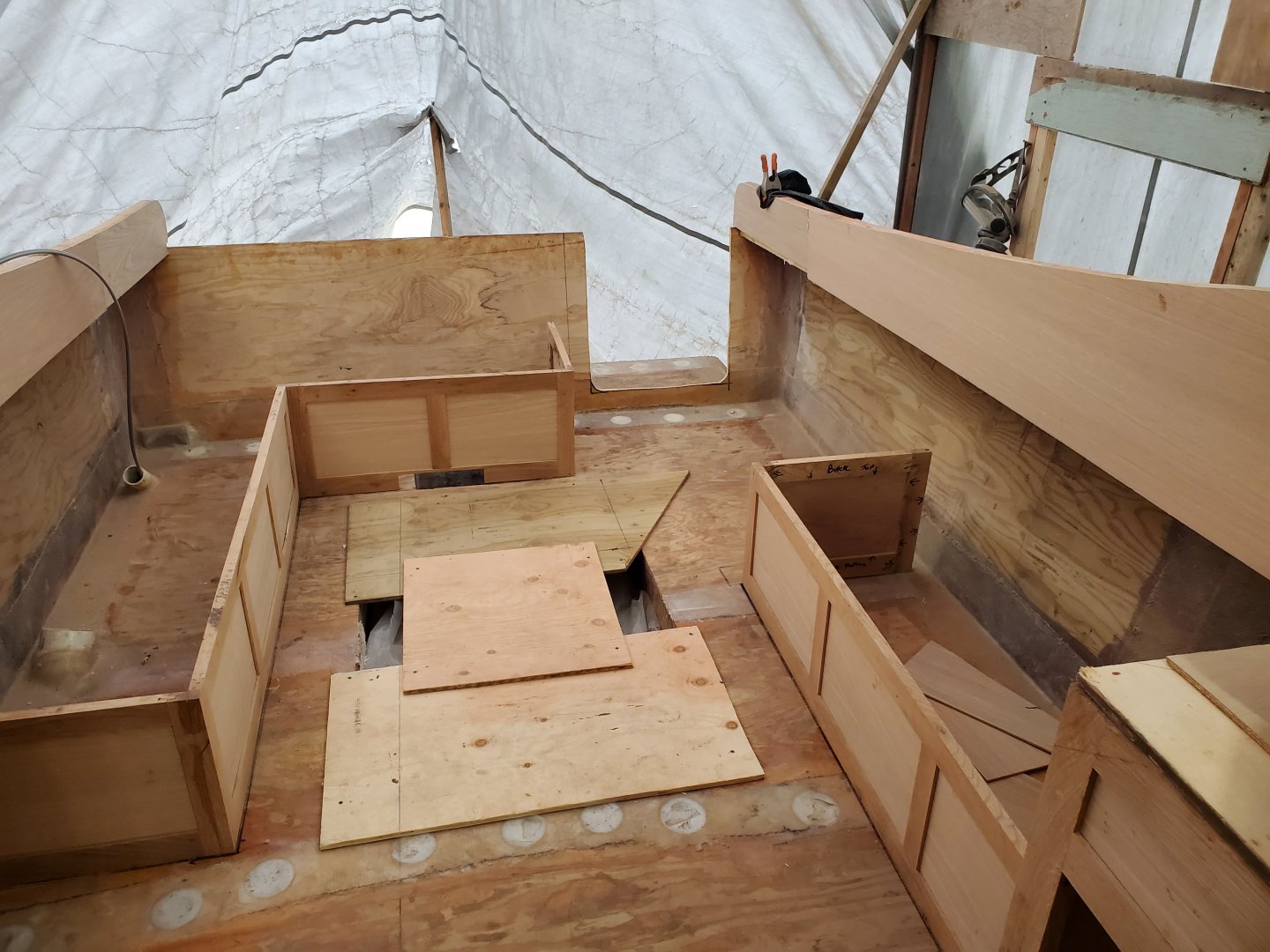

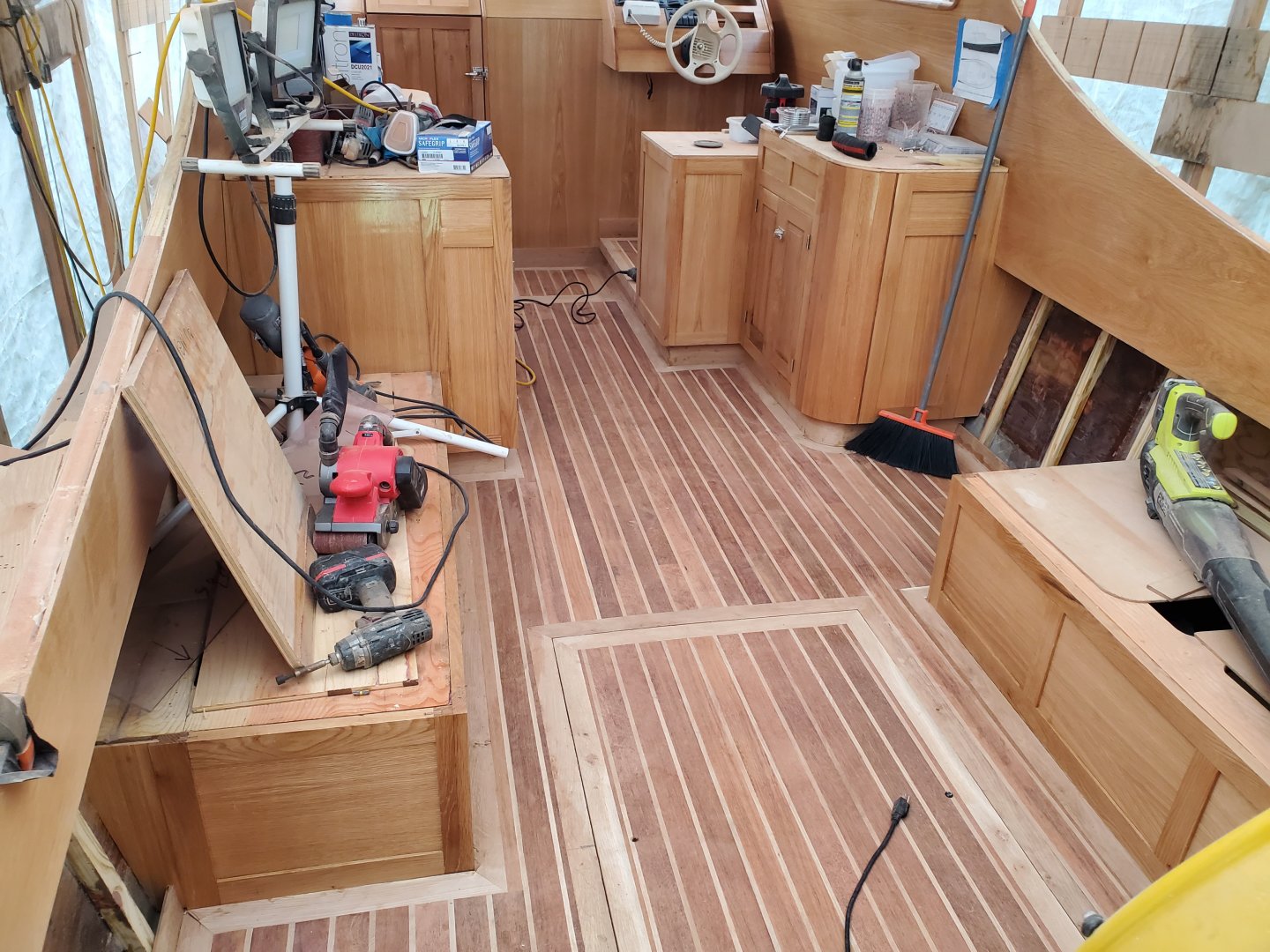

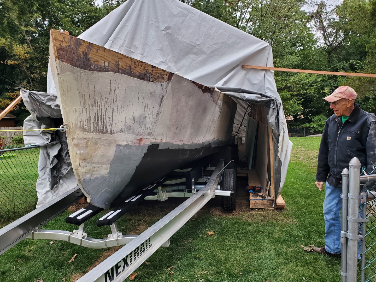

    20230306_112132.jpg Added some seating 20230625_105715 - Copy (2).jpg Then I added the sole 20230923_160201 - Copy (2).jpg Epoxy on the floor [needs sanding and finishing] and the cabinets and seating was sprayed with Deltron Clear 20231007_102802 - Copy (2).jpg 20231022_121014 - Copy.jpg 20231024_110639 - Copy (2).jpg Fairing and sanding, over and over and over again 20240102_122149 - Copy (2).jpg 20240104_153710 - Copy (2).jpg More work on the interior 20221003_111157.jpg At this point the boat was pulled out of the tent and put on a trailer for more exterior finishing work.
    More to come

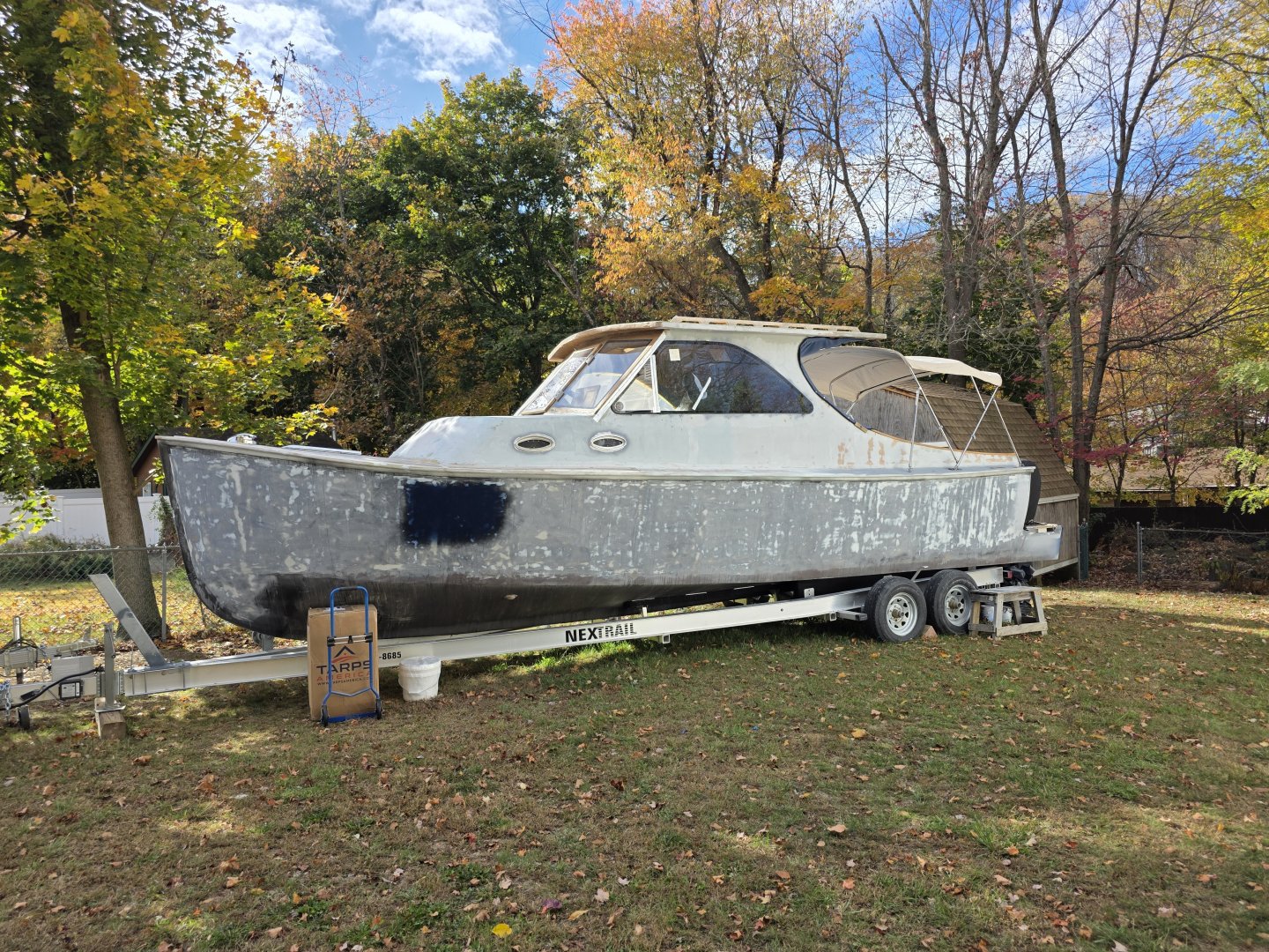

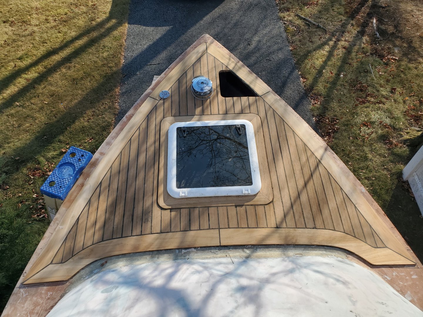

    20250527_151721.jpg This is where I'm at as of now. 20260331_090414.jpg Got the seats done by a local upholsterer 20241207_101826.jpg Some Teak done at the bow 20260331_072609.jpg My son who has a need for speed convinced me to sell the 90hp outboard and go with a 300hp outboard. I compromised and got a 150hp outboard. Let's try it for a season and ten make a decision. 20260331_072630.jpg 20260331_091707.jpg Got a Bow and Stern Thruster installed 20251029_144359.jpg Just need paint
