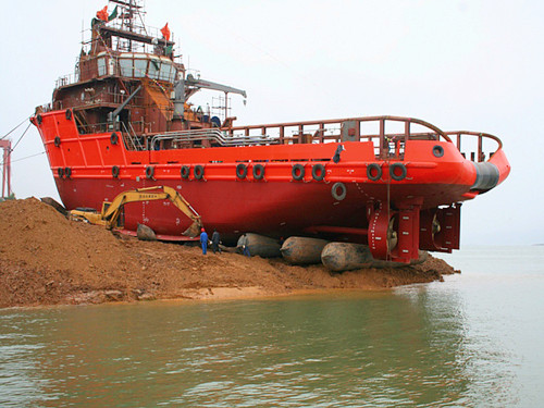

    this is not real but the better way for ship lifting is the airbag

    hi my friend RHP we have the same experience in anzali port in iran but we use airbag for lifting and lunching the ship

    i am so sorry but i mean this kind of air bag
