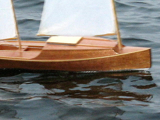

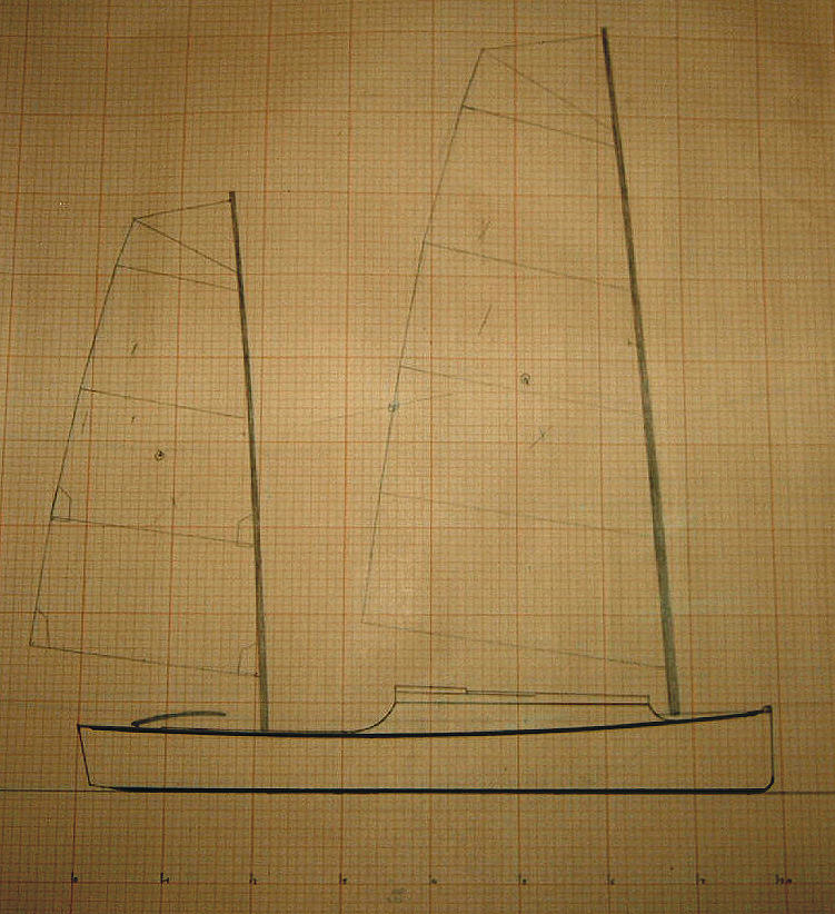

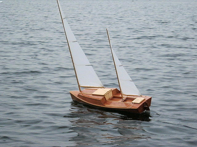

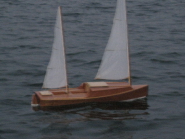

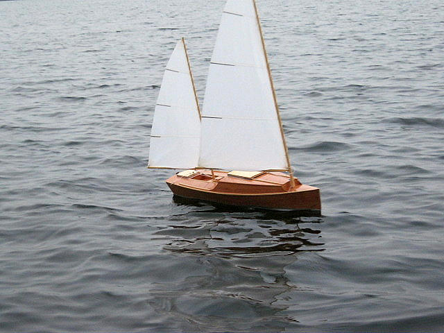

Years ago I have drawn (yes, as you can see ... pencil on paper) my own version of Egret, but in my search for performance I ended with a broad stern, more in the direction of the NIS Boats. But with a more economical usage of plywood and only 8m long (26'). It has a shallow keel that houses the centerboard for stability / performace. It has a full but simple accomodation with up to 4 bunks, galley and table, uninterrupted because the centerboard is housed in the keel. It uses a complete OK Dinghy Rig as the mizzen. Cheap and fast to build.
I made a model from the plan and equipped it with RC. It sails beautyful. Find the fotos attached.

Hello Igor,
well, I believe that the bad performance of the Egret belongs to the wooden boat magazine plans only. R. Parker means that their version is historically more correct and sacryfises speed in favour for seaworthiness to cope with the difficult conditionbes at the Florida Coast (running the inlets and sandbars, Gulf Stream weather and waves).
Parkers version of the "Egret" is, to my eye, much more "yachty" and should perform better. Nevertheless, if you build the masts and spars hollow and therefore lighter, you can make them a little longer to set more sailarea for the light wind days in croatia. But still not much space inside. Also note the other Designs on parkers website.

Your boat advances the idea even further, by removing the centreboard from the house a lot of space opens up, the ballast goes down low ih hollow stub keel (where it belongs) and all of the underwater appendages are hi aspect foil section to improve windward performance. It does remind me of NIS boats and I like it a lot. Hope you will build the full size version!
