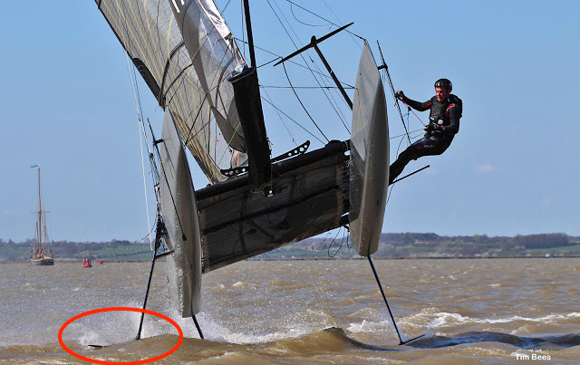

    According to Alan Smith and others canting a wand controlled t-foil outboard 15 to 20 degrees can eliminate most negatives associated with them while still retaining the ability to generate RM.
    Another solution with wand controlled t-foils (which eliminates the ability to generate RM with the foils) is the canted, retractable T-foils on the Vampire cat that have proven fast. The boat sails with a main foil consisting of a single, wand controlled, canted t-foil(and two rudder t-foils).
    This picture clearly shows the cant angle of the leeward wand controlled t foil:

    Vampire style canted, swing–up Ts might solve some hydrodynamic issues, but create a number of practical issues, not the least of which is that when a T foil ventilates (as in the image posted by DL) all lift is lost and a solid crash is inevitable. Other configurations tend to have less violent results (though the SuperFoiler is showing that J foils + short floats do an excellent job of creating spectacular crashes).
