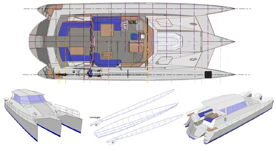

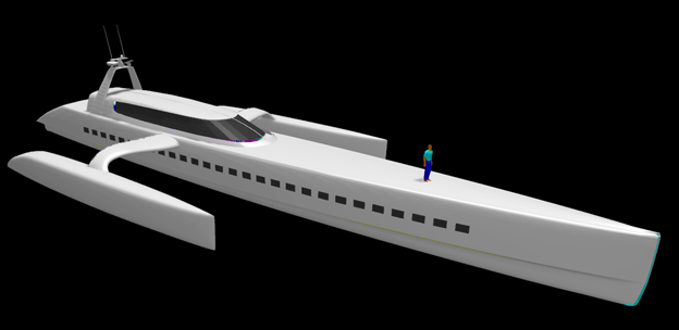

    A project made by a collegue
    You can find below some view of a power trimaran

    The design parameter that makes any of these types of slender hulls work efficiently, is the displacement to length ratio. It is THE most important design ratio with regards to hull resistance. It doesn't matter if it is a trimaran or a stabilized monohull or a catamaran, if it is very light, and very long it will be extremely efficient in the semi displacement speed regime, for our purposes in the hull lengths already discussed, say between 10 and 20kts.
    Building in aluminium should be fine, and allow a reasonably lightweight structure. Sandwich core Composites would also be a good choice. Don't be fooled into thinking just because it looks fast, and that it's a trimaran, means it will be fast and or efficient automatically. There are fundamental reasons for it.
    What I am trying to say is, if you need this boat to carry a large displacement, then perhaps a stabilized monohull does not fit your purposes ideally. If you attempt to build a design like this, and it ends up very heavy, you will have a very poor performing vessel that you wish you never wasted your years on. The displacement to length ratio is key in these types of designs - which allow higher cruising speeds than classical displacement vessels, with still minimal fuel consumption.

    You are right
    but we are leave a board guys (and woman !!), it means when we make a list of weight:
    - alloy
    - engine, filter, shaft ,propeller, accumulator, sound insulation etc
    - insulation
    - wood, plywood or cored material
    - books,
    - solar panel
    - hatches, plexiglass
    - anchor , chain, ropes
    - windlass, capstans
    - tools
    - heater
    - watermaker
    - water tanks
    - diesel tanks
    - electrical wire
    - food (and food for our dog !!)
    etc etc

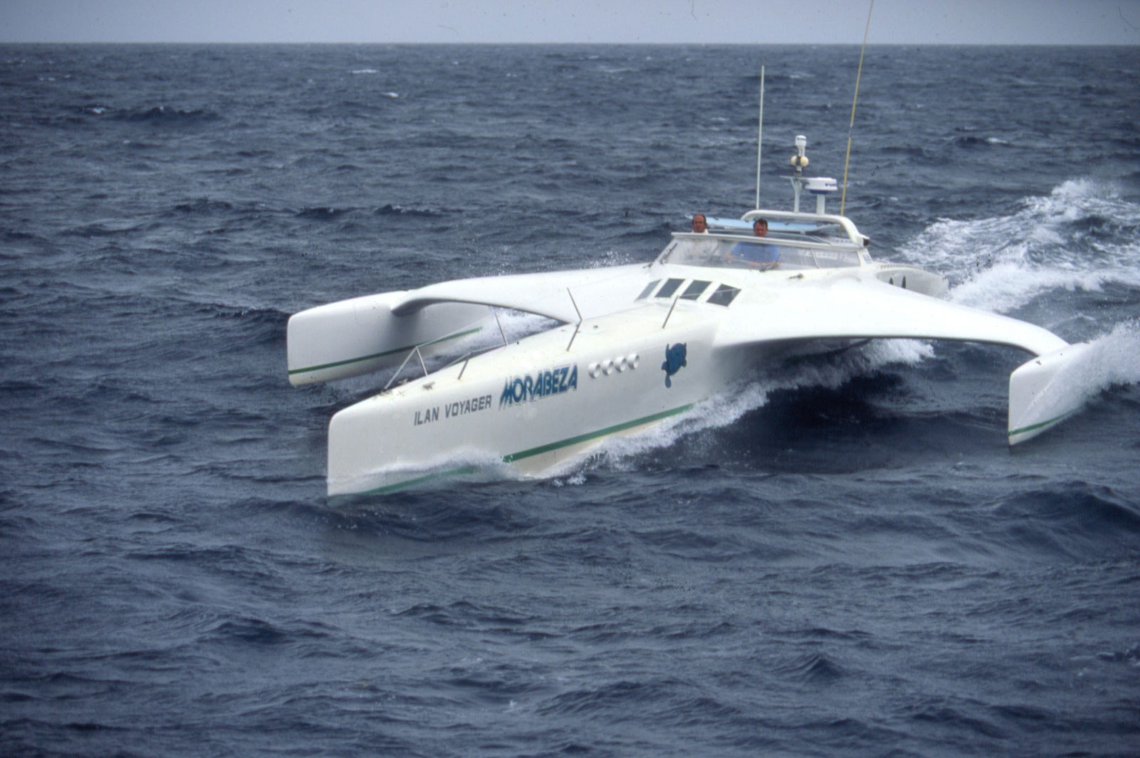

    We can't go under 20 t full loaded, yes the L/D ratio is not big : around 55
    But for a trimaran or stabilised monohull it is a lot compared whit for an "extreme" example "ilan voyager".
    But in any case it is not our "target", but as you wrote before able to cruise somewhere between 10 to 20 knts, say 15 knts with a "low" consumption of around 2,4lt per nm, and for exemple 10 knts @ 1lt per nm.
    May be it is "voie sans issue" , may it will be better to keept the same drawing than our actual boat (we can "decrease the weight under 30 t) with the same volume (even little less) but for 22m loa :confused::?:
  5. groper
    Joined: Jun 2011
    Posts: 2,467
    Location: australia
    groper Senior Member
    You have your answer- simply make the boat longer if you wish to carry more displacement... You can compare benchmarks of the similar vessels outlined earlier. Plot the displacement to length ratios of them on a graph, then once you see the range in which successful designs have been implemented, you will have an idea of how long you should make your boat in order to carry an amount of displacement you want.
    Once you have a rough idea of that, you should then consider where you will build it, where will you keep it, and what slipways can handle it for maintenance etc. and of course, can you afford it.
