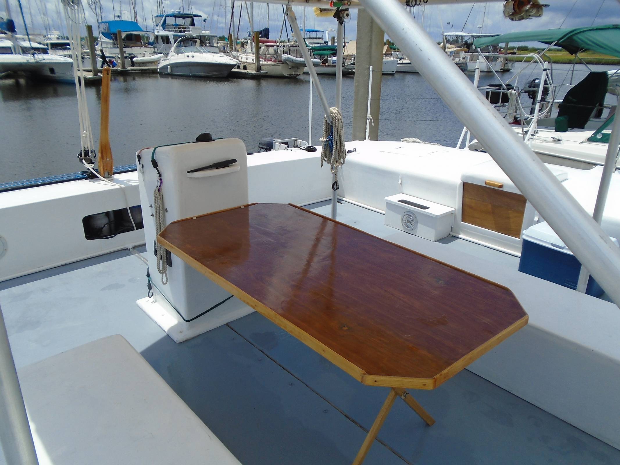

    Yesterday we moved the boat around to a local marina for hurricane season. After a much needed bath I took a few pictures.
    The paint job is holding up OK, I guess, but there is some chalkiness in places. It rubs off on your hands and clothes. (system three) Anyone have a recommendation? Star brite?

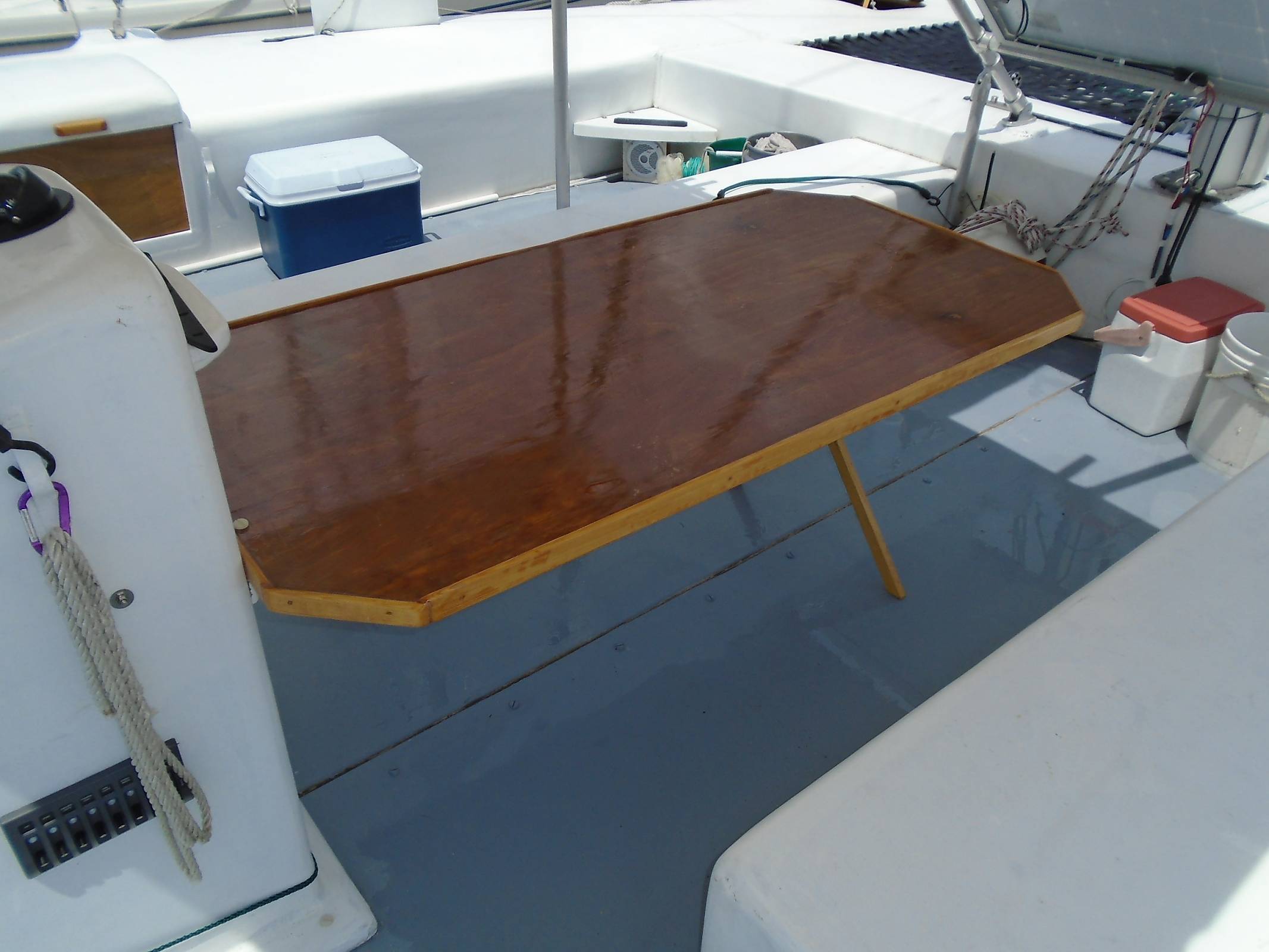

    Cockpit table is ready for Thanksgiving buffet.:D It is just a sheet of pink foam with a layer of cheap 5mm ply on top, some thin cloth, and saturated with "natures perfect material". held down to a ledger with a couple of those nylon toilet seat bolts

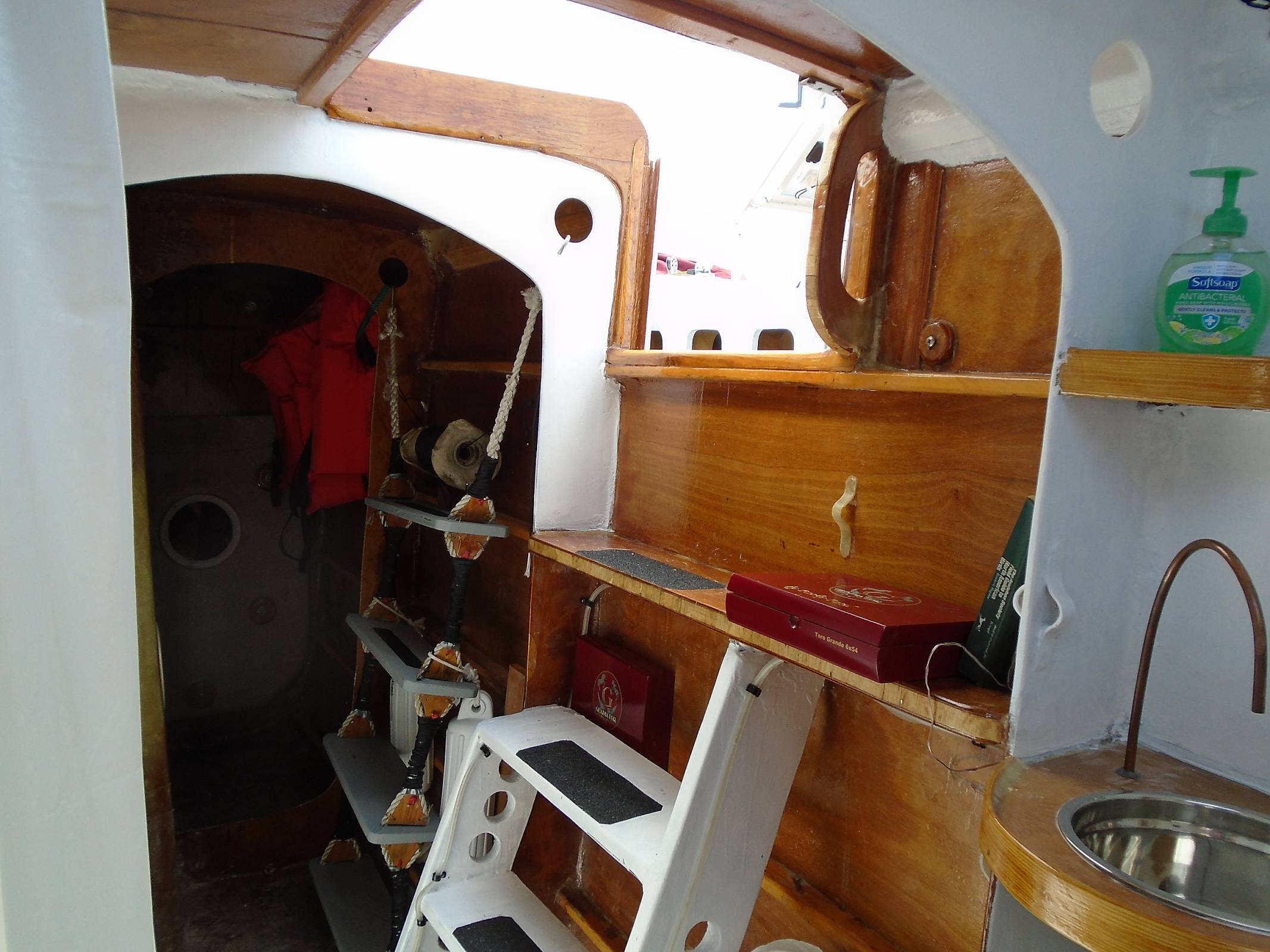

    daggerboards are just pinned up with some 1/2 inch fiberglass rod. I haven't messed with them much yet. So far when we go out sailing, I have been too busy tending to everything else. Yesterday we tucked in a reef for the first time. A real milestone learning experience. Don't forget to hook the new tack to the reefing hook.:D

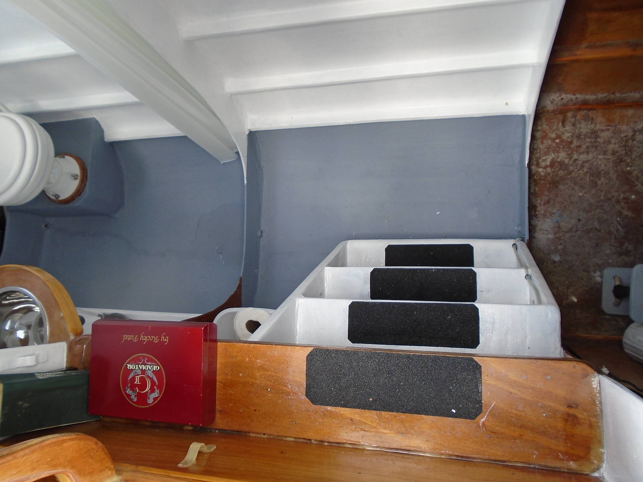

    Isolation bulkheads have not been tested. Hopefully never will be. They make me feel better though. Made of two inch foam with two layers of 20 oz biax each side. bolts go through to cedar boards that clamp it to the bulkhead. weather strip for gasket.
    hand washing sink is made of a stainless mixing bowl from target. 1/4 copper for the spout hooked to a plastic tube with a primer bulb for the foot pump.
    Solar panel makes a good windshield. Ill build a proper dodger when i can afford it.
    Still don't have a good take on speed. I can't afford gps yet and haven't timed her good and proper. I don't have clue really. She goes much faster than motoring thats for sure and she motors 6mph. And Ive been pulling a 12 foot dingy around.
    Anyway, all in all I love the boat. I am still not satisfied with the steering, but am getting by ok with reversed tiller heads, and a double block arrangement to a harken car on a thwartship track mounted on the aft beam. Eventually I may go to hydraulic, but that is off the radar for now.
    I am building a website, to be called LOGBOOK OF THE SPIRIT OF ST SIMONS. It is not up yet, but I will continue to gabble on about the boat there, along with more general interest topics thrown in- anything to do with the boat or the people and places associated with it. It will be here: charlysboat.com
