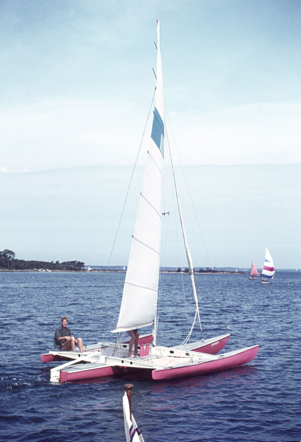

  9. Corley
    Joined: Oct 2009
    Posts: 3,770
    Corley epoxy coated
    some photos of the boat in her sailing days, rebuild in progress need to get a decent digital camera for some current photos but the main hull is getting there and looking good.

    Thanks Corley - yes, a lovely design. Re boarding ladder, maybe consider mounting a fold-down s/s version on the side of the main hull just aft of the rear beam. Though not as rugged as the one on the cat described earlier, a standard lightweight model available from most chandlers would do the job. These come in many different configurations, one of which would be fairly unobtrusive when raised. By adding a couple of small "stops" glassed to the side of the hull below the ladder it would prevent it from swinging under the boat when in use - a major hassle as mention above by Ray. If you 'fair" the shape of these stops, they will create minimal drag

  11. captainsideburn
    Joined: Mar 2009
    Posts: 88
    Likes: 2, Points: 0, Legacy Rep: 23
    Location: Tasmania
    captainsideburn Junior Member
    I would think for a boat as small and light as this you wouldn't want anything like a heavy wooden ladder, maybe a rope loop that you can drop over the side just long enough to get your waist up to deck level?
    BTW you might recognise in that first photo my catamaran, an Attunga
