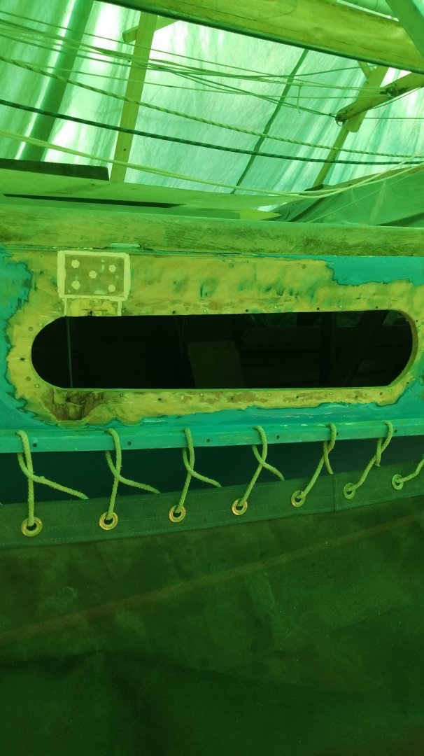

    I sanded out old paints and varnish (or epoxy) from the portlight areas. Some rooten plywood only near the screw holes, other plywood is in good condition.
    We have debated with friend on a future plans: to sand out all paints from the cabin (sand to plywood and then cover with penetration epoxy) or fix weak areas only.
    So, your advice is velcome.

    I should only treat the affected areas, the boat was made with epoxy covering and 2 components polyurethane paint and varnish. I don't know what happened with the boat in the last 30 + years.... IMG_2021.JPG

    You might want to consider a plan to systematically go around all the fittings for rot around the screw holes.
    Drill each screw hole oversize, fill with good strength epoxy filler and re drill hole correct size. Future proof.

    I like to add a tip, in such cases I put some temporary tape behind the hole before filling it and also tape on top of the filler flush with the surface, the filler won't sag and I had much less sanding to do.

    You can do similar with oversized washers, applies a bit of squeeze pressure too.

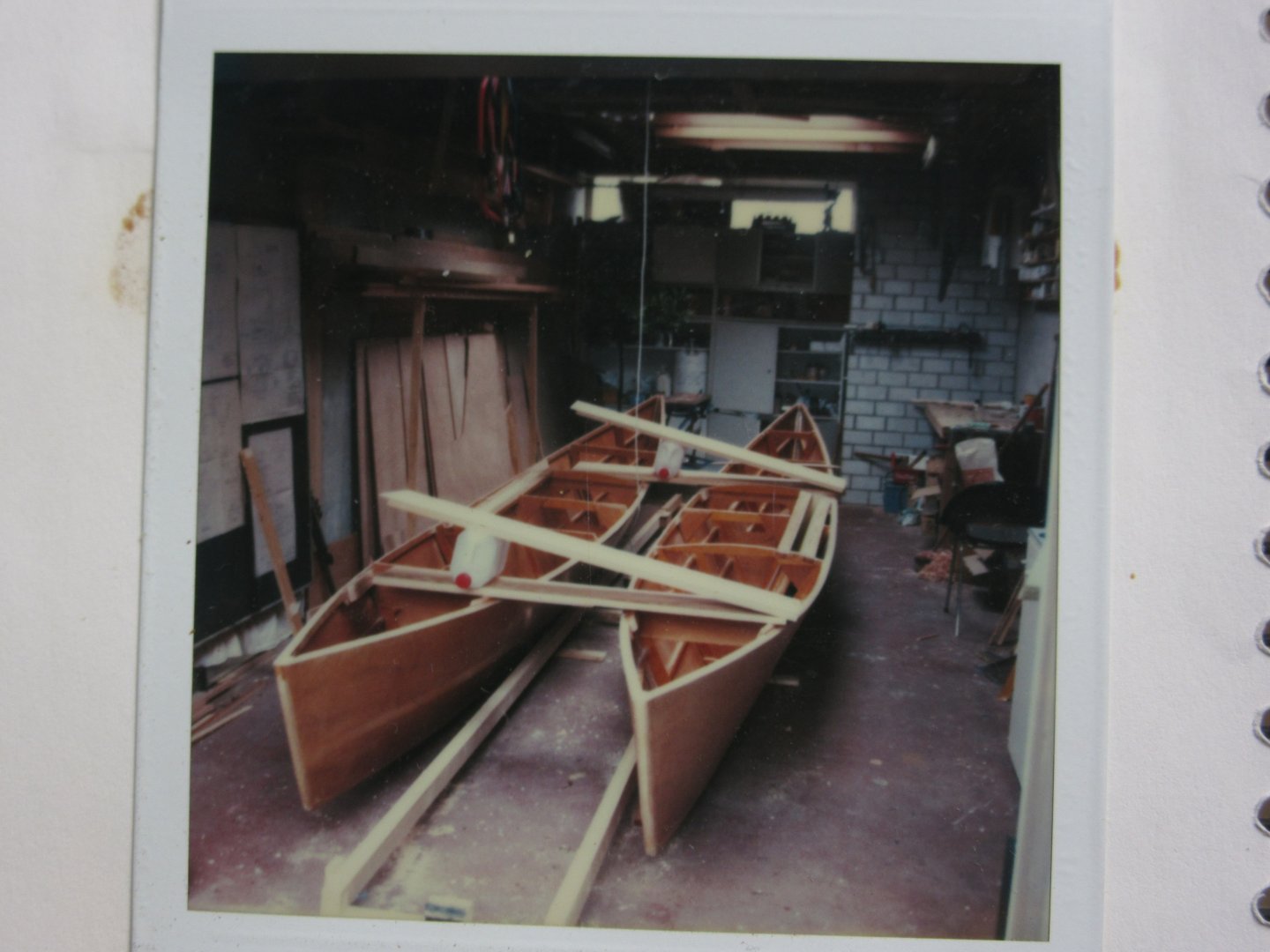

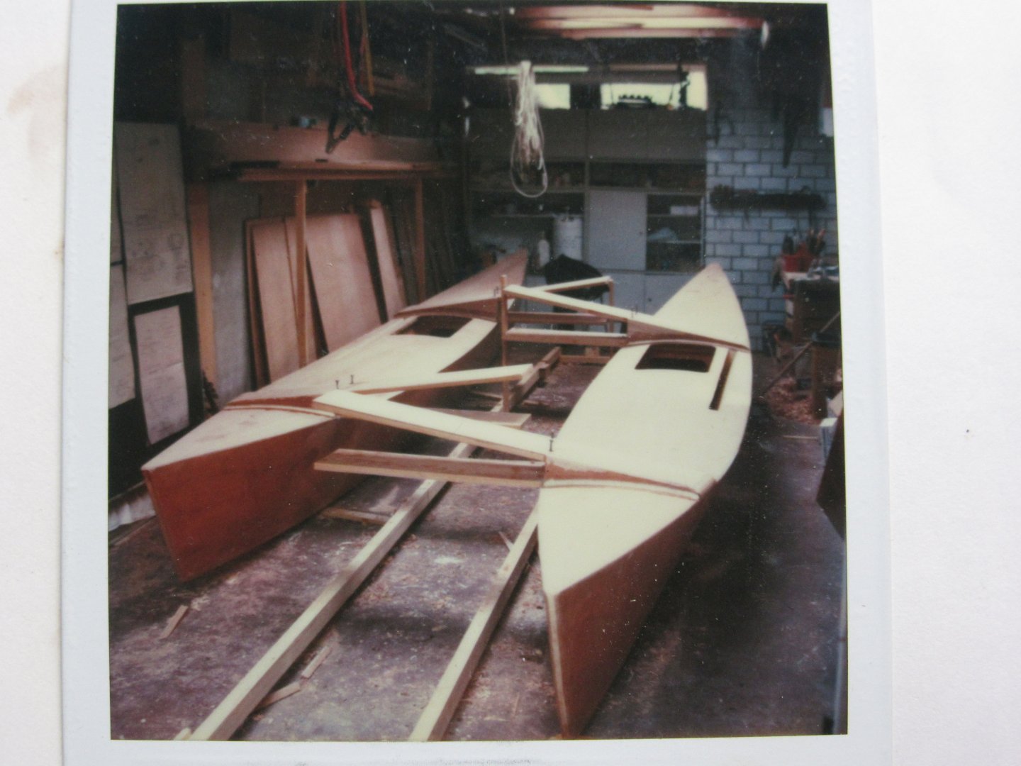

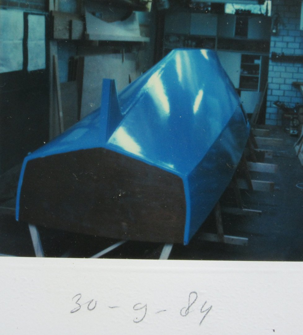

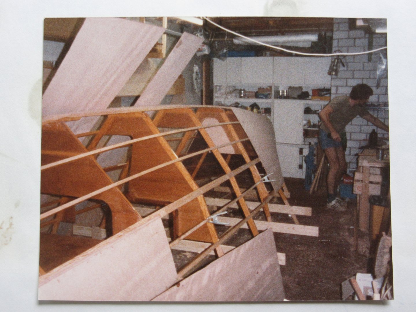

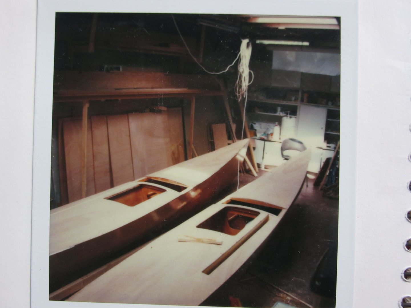

  9. vinboot
    Joined: Jun 2020
    Posts: 9
    Likes: 4, Points: 3
    Location: Netherlands
    vinboot Junior Member
    Hi Zombat,
    All the gluiing was done with epoxy & filler and nailed with silicone bronze barbed boatnails. These pictures (from old polaroids) give you an idea how it was build.
    The deck glued on first, then the beams (I can't recall if fasteners where used in the beam/gunwhale joint) the deck/beam joint close with epoxy&filler fillet. Hope you have enough info.
