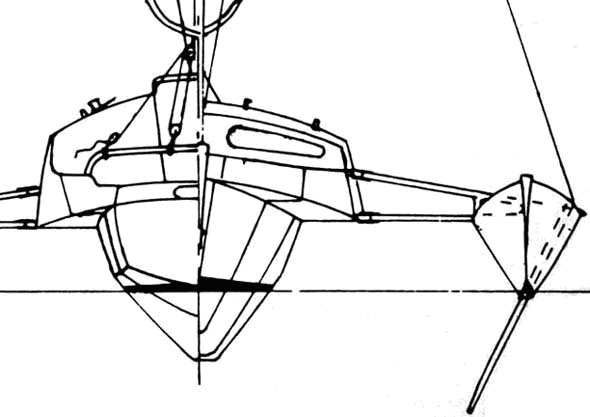

    I've been looking at the Jarcat 6, thinking I could shorten the cabin and have a ginormous cockpit, as well as a nice big head in a trailerable boat. On the Jarcat the mast is located very far aft, so shortening the cabin would allow the mast to move forward and make for a more normal rig, which I'm guessing is a good thing.
    Anyway, looking at pictures I noticed some Jarcat sixes have nearly plumb bows and a different cabin shape, but most do not. I know there have been revisions, mk1, mk2, etc, but the current website has no information on this. One ad for a Jarcat with a plumb bow described the boat as 21', not 20 (6m), and it does look a bit longer.
    Anyone know if the plumb bow is in the current plans?
    Jarcat 6's with nearly plumb bows:
    And the other variant:

    And here I chopped some of the cabin off with photoshop.
