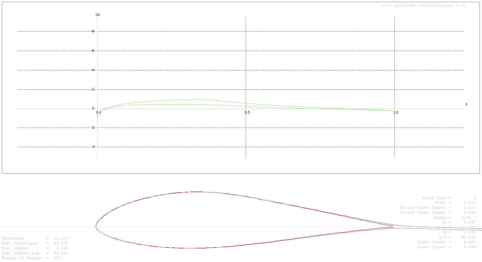

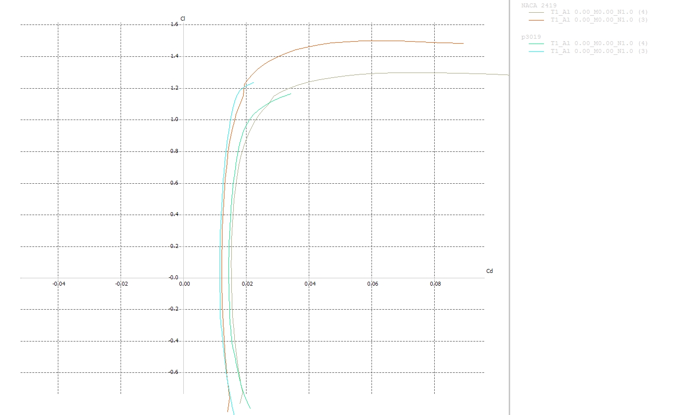

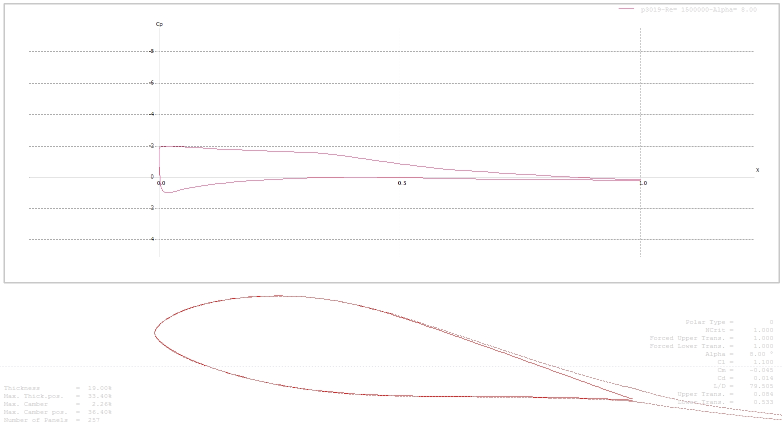

    1. If you put them far out to the sides, they can work like an extra hull when at speed. They then counteract the heeling moment of the sail.
    If you put them forward, they can lift the bow, which is important to many fast boats, so they don't fall 'head over heel' or 'over the handle bar', to use a bicycle analogy.
    2. Cavitation occurs when: The water is moving so fast over the top of the foil, that the pressure is reduced so much, that the water boils. The steam bubbles increase the drag and decrease the lift for normal foils dramatiacally, and they can collapse (implode?) so violently that they ruin the foil surface. If air is available to the low pressure side of the foil, then that will equalise the pressure and replace cavitation with ventilation. Ventilation can happen at much lower speed but only near the surface.
    Ventilation and cavitation is handled the same way, to reduce the negative pressure peak on the low pressure side of the foil. This can be done with particular shaped sections, and with sweep forwards or backwards.
    Some foils, like Jon Howes surface foil, are made to ventilate, so that they will never cavitate. His foil also runs on the surface as soon as it goes fast enough so it doesn't need active height control.
    The speed limit for a subcavitating foil is around 60 knots I read (more with sweep?). Incidently Jon's foil was originally designed for a 100 kt+ boat called 'monofoil'.
    If you want to know more about cavitation then search in tspeer's posts. He's a jedi at explaining and I remember he's had a fair bit to say about both stability and cavitation.
