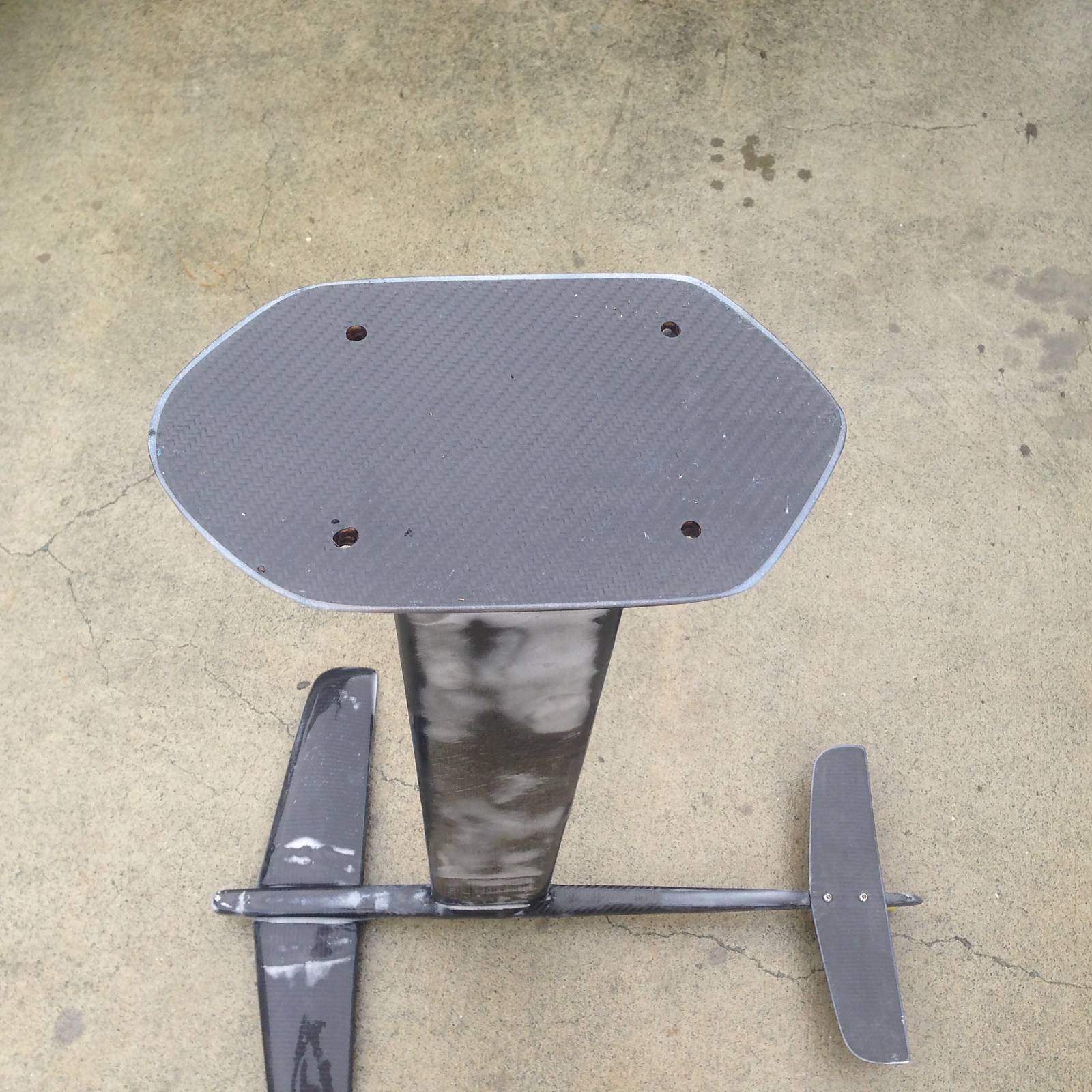

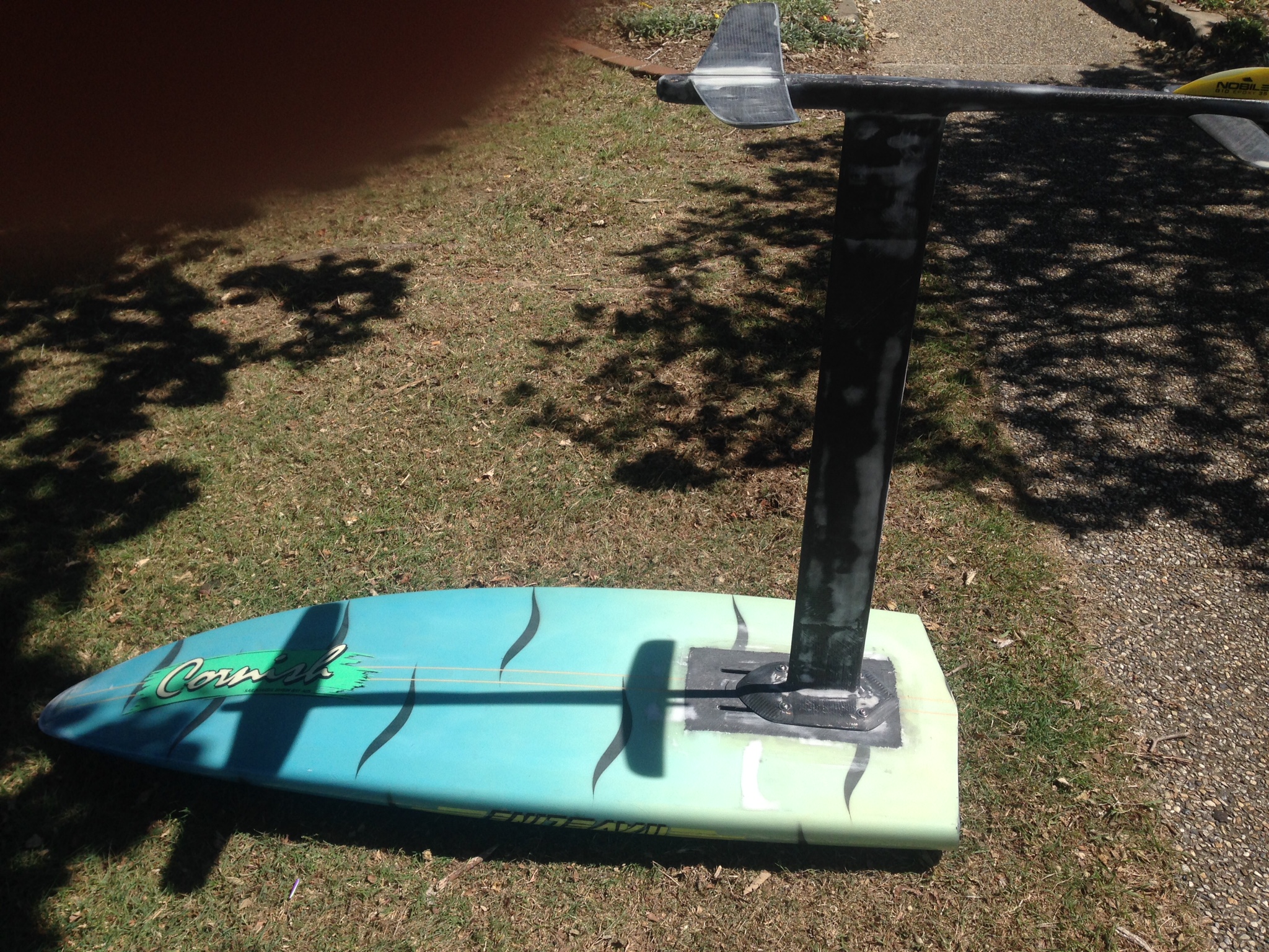

    Here is the foil and board I just finished building , works great.

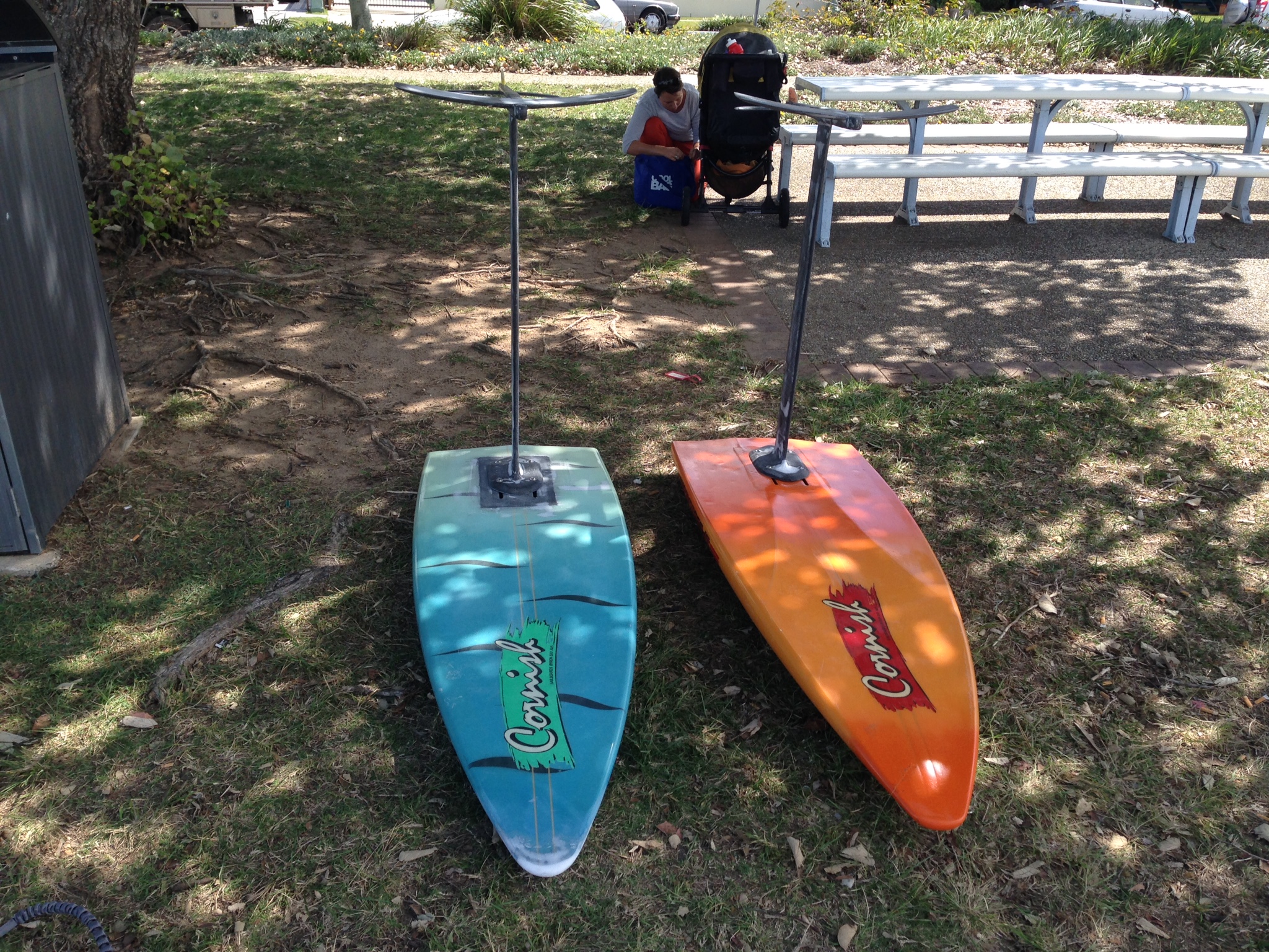

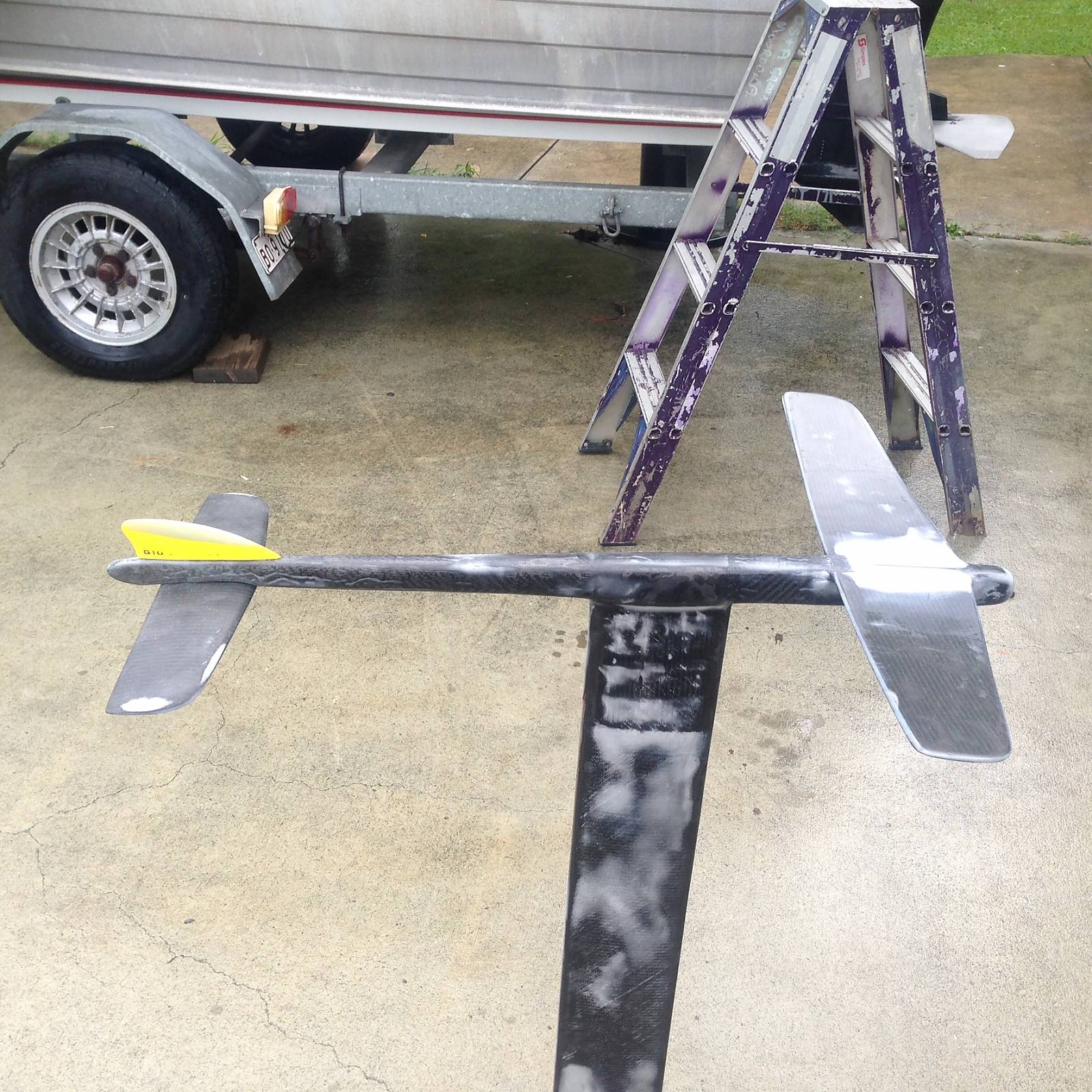

    Couple more pics

    Way to go! Whats the purpose of the little yellow fin-a skeg?

    No other purpose but to bolt the rear wing to ,Its removable and has adjustable pitch . the skeg is G10 and has 1/4 threads tapped into it , it was that or epoxy in some nuts or use sex bolts.
    Jay.
