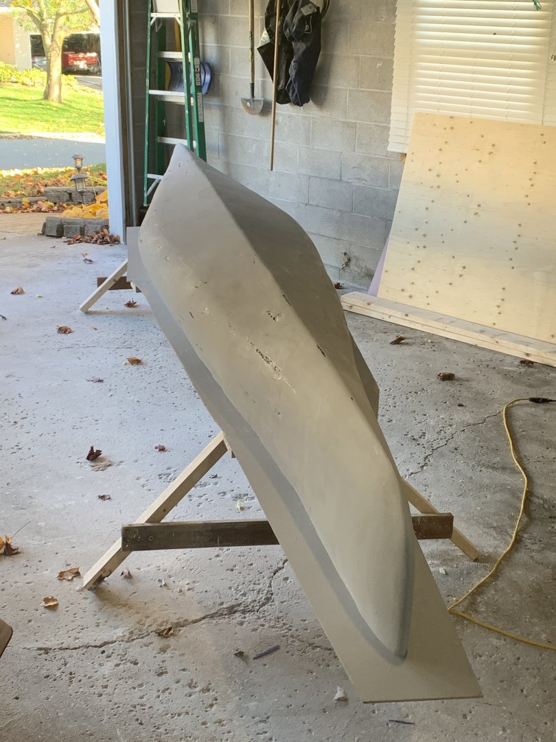

    I have had a copy of James Moran’s book for a few years and decided to give it a go. I made a few adjustments to the solo canoe plans in the book and got to work. I’ll try and post pictures. Currently I am almost done the male plug mould, and am somewhat nervous about the next steps.
    As my mould is almost all drywall compound with some small areas of pink insulation board exposed, I am wondering if I should paint it next to seal it a bit. The book goes into using a release agent wax but I’m wondering if there is a better more modern product to use. Also I’m considering making a fibreglass canoe as a first run to learn but also maybe use as a female mould if it goes badly. My hope is to make 5-6 canoes, so a female mould could work better, but I’m not sure what kind of product I’ll get if I lay up over a make plug and either roll the epoxy or squeegee it on. My plan is to use a kevlar inner layer and a inegra outer layer, or perhaps a basalt/inegra outer.

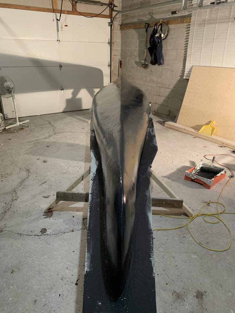

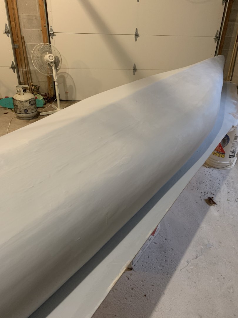

    So I’ve decided to go directly to marking a female mould, I’ve added a stiffener flange around the what will be the top of the mould. Sandable primer next, many coats then a sanding with 400, 800, 1500 grit, followed by a top coat and sanded again. 8-10 coats of wax, sprayed gel coat and fibreglass after that. The mould will be made in two pieces to facilitate temoving the mould, as well it will store better when I’m not using it.

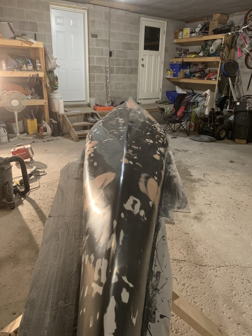

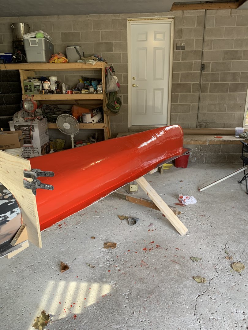

    D6F5C421-936E-4536-9389-3B5C1DFE212B.jpeg D6F5C421-936E-4536-9389-3B5C1DFE212B.jpeg 0CD31523-BF5B-4724-A784-948AF9B1678B.jpeg 75B7644C-A9D2-4C0D-A542-F4C7DF64477C.jpeg DC000131-6FCE-4B03-AD92-D3DF82E46246.jpeg 4BF44B4B-2927-4D20-91DA-B342C6491050.jpeg 41D5AB8C-CDC9-4DFB-AF95-51DB30E09AB2.jpeg F8B97F18-2292-42D3-B5CA-0F12516E575D.jpeg
    Ok, so first sorry for not seeing all of these posts, initially I didn’t see much action and stopped looking, thanks for all the input. I’ll explain what I’ve done, explain my mistakes as well.
    After the plaster shape was made I coated the plug with Duratec primer, this is a great product in my opinion, and next time it will go much better. Some areas where the plaster was not quite think enough my mould was dissolved from underneath. I went back and re-puttied these spots and reapplied the primer, I brushed this on as my roller didn’t seem to spin freely when applying, I don’t have a sprayer. So both coats of this went on like ****, and had to be sanded a lot. This made it thin in spots. The next coat was a more durable duratec primer(black coat in pics). I managed to get a better roller and this coat went on much better. In an effort to perfect my mould I sanded through in spots and had small cracks appear in spots. Eventually anytime I made improvements I also made more problems and may have to make initial repairs to the female mould, assuming things work out. I made a middle flange to enable a split mould, applied 8 coats of carnuba mould release was per instructions, and this morning started with gel coat which I’m waiting to have set up so I can fibreglass it. I’m making this in my garage and am weather dependent. I’m not sure if the male plug would survive. The design is from the book which I then changed. It’s 17’1” long, 30” wide at the widest point, around 29” at the waterline I think. I changed the bottom to a shallow “v”, and will layup with carbon/inegra outside and Kevlar inside. As well, I made some corrections to the plug with bondo.

    I like it! What does the red image represent?
  11. Sneddy71
    Joined: Oct 2020
    Posts: 4
    Likes: 2, Points: 3
    Location: Canada
    Sneddy71 New Member
    That’s the gel coat.
