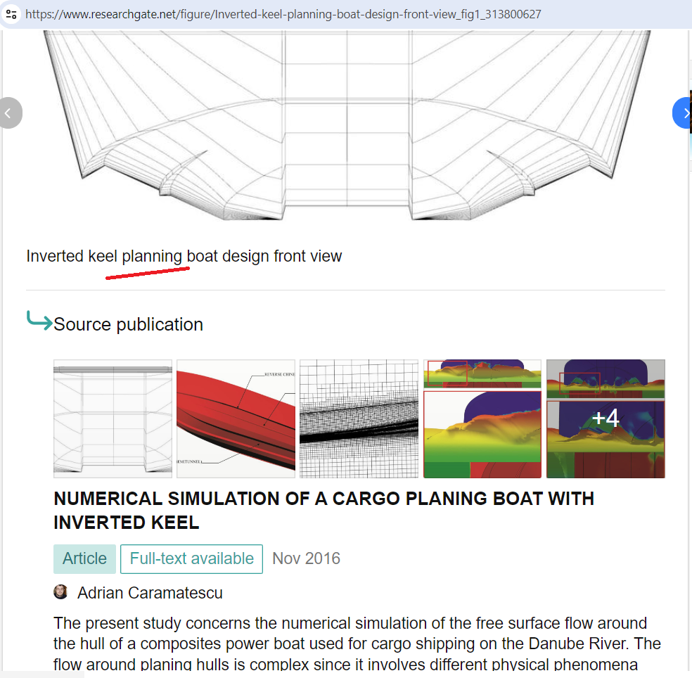

    On some Norwegian forums, searching for some speed vs. power results, of traditional Scandinavian boat design ( double-ender, spitzgatter..) I find term " planning on keel ", describing behavior of (typical) semi-displacement hull with keel, when power is increased .
    I am familiar with tendency of such boats to " dig " stern , but, is "keel planning "something different ?
    thank you in advance

  3. zoran
    Joined: Apr 2020
    Posts: 3
    Likes: 0, Points: 1
    Location: europe
    zoran New Member
    dear Rwatson
    yes, it is misspell, but, i search for the term even with proper spelling.
    with your help, I find some (already known) facts about semi-displacement boats with keel, during planning. Like hard maneuvering ( due to a long keel) , and, especially problematic, stern digging. As a "countermeasure" in mid9 80's thy add a little tongue on the edge of the stern ( where bottom going upward) . Later on instead of just flat bottom from midships to stern, they start adding some "volume foot" , a mimic of V bottom . In last 20 years, an entire platforms are added (i.e Menorquin) . So I belive that only issue with rounded stern "traditional " form in the world of planing boats is lack of volume on stern.
    But know, I found this new term " keel planing " .

    Well Zoran, there are a few misunderstandings involved. First, if your focus is on a hull that is mainly supported by dynamic forces, then please use the correct term, namely: planing (NOT planning; you may be planning to build a planing hull, but that's something else!).
    Then, what it is all about when it comes to "keel planing", is that a hull with a keel (like traditional hulls, both double-enders and transom type) tends to rise to a point where it loses transverse stability, then leans to one side and keeps planing on one bilge surface plus one side of the keel. In this mode it resembles a "soft-chined inverted vee" hull.
    For a double ender with round buttocks aft to reach planing speeds it is necessary to create a straight buttock aft with a sharp cut-off. This is done by adding a horizontal panel to the extreme aft of the hull. This is a means to achieve planing speed, but it should not be confused by the consequence of planing with a keel.
