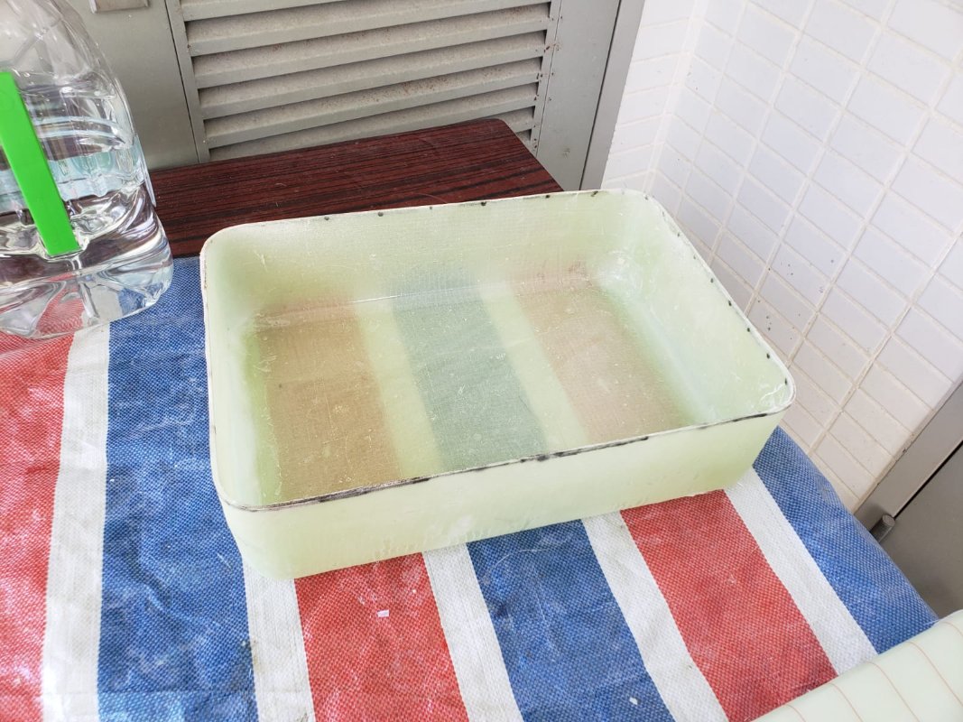

    galley cabinetry
    final position on the boat (the wall wasnt given the storage, this was a prior rough fit)

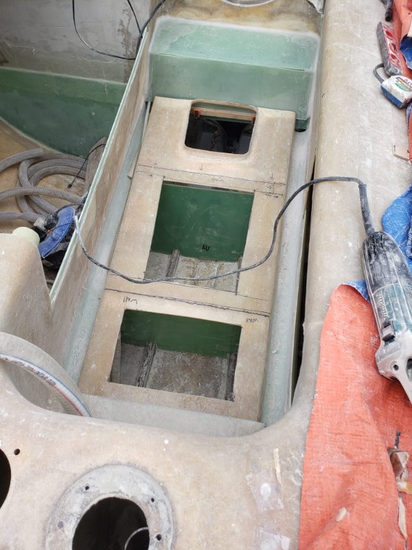

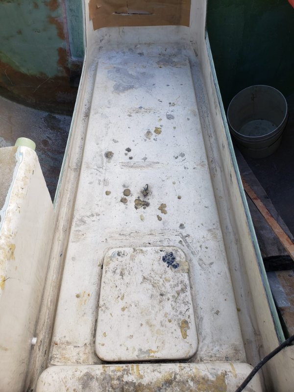

    in my quest to maximize storage and ergonomics i decided i needed to lower the cockpit floor. i will build a rigid bimini and ideally i want to have standing head room. at 5' 7" its not that difficult to achieve.
    so i had to cut the whole cockpit floor piece
    this was a rough fit at 70mm below the original height. this ended up to be number i was looking for as it always enable me to keep tha majority of the under cockpit unclaimed space.
    templating the partitions for the under cockpit storage lockers
    not the 2 side dray channels, laminated from an oval shape, created by taping 2 pvc pipes, 2 inch diameter and then cut to a J profile shape
    fallguy and Will Gilmore like this.

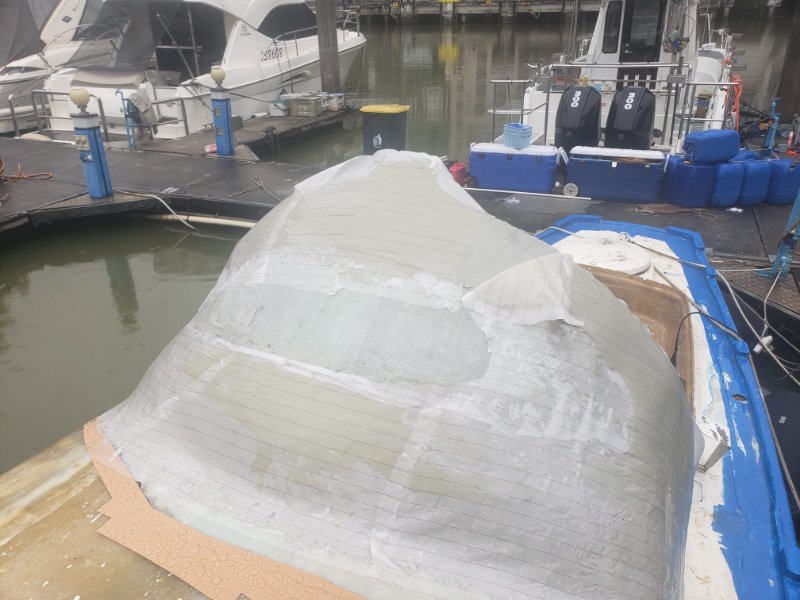

    solid dodger build
    to build it i first needed to peel the whole cabin top
    trying to have a first feel for the volume and shape involved in the making of the dodger
    very first anchoring laminations
    another step towards the intended shape
    laminating a couple of biax layers to have some structure to it
    demoulded
    refitted
    fairing it and applying peel ply to iron out the surface
    and thats it guys, the is pretty much where i am presently
    nexts steps are to sand the fairing down, tune it some more, laminate from the inside, fair, sand and tune the inside, then strip plank with G10 strips, and laminate until im happy with its strenght, when it doubt laminate some more!
    the cloth im using it biax, 400 gr/m2, 45/45 angle. im also going to use some CSM to help getting some meat on.
    Will Gilmore and Flotation like this.

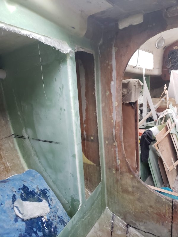

    got around to continue to refit
    main bulkhead works
    before filling some cavities
    after
    laminating central and portside sections
    in the mean time i also received the SS metal pieces i had designed as the reinforcement pieces to counter the mast´s compression force.
    its all 6 mm SS , polished in the visible side
    there is a visible slant on the fwd piece, and also in the aft one, but its quite noticeable in the fwd one. im not going to fix it.
    just going to bridge the gaps with G10 sheets, cloth and thickneed epoxy, which, by squeezing out will make for a flat surfaces, making both surfaces match
    Will Gilmore likes this.

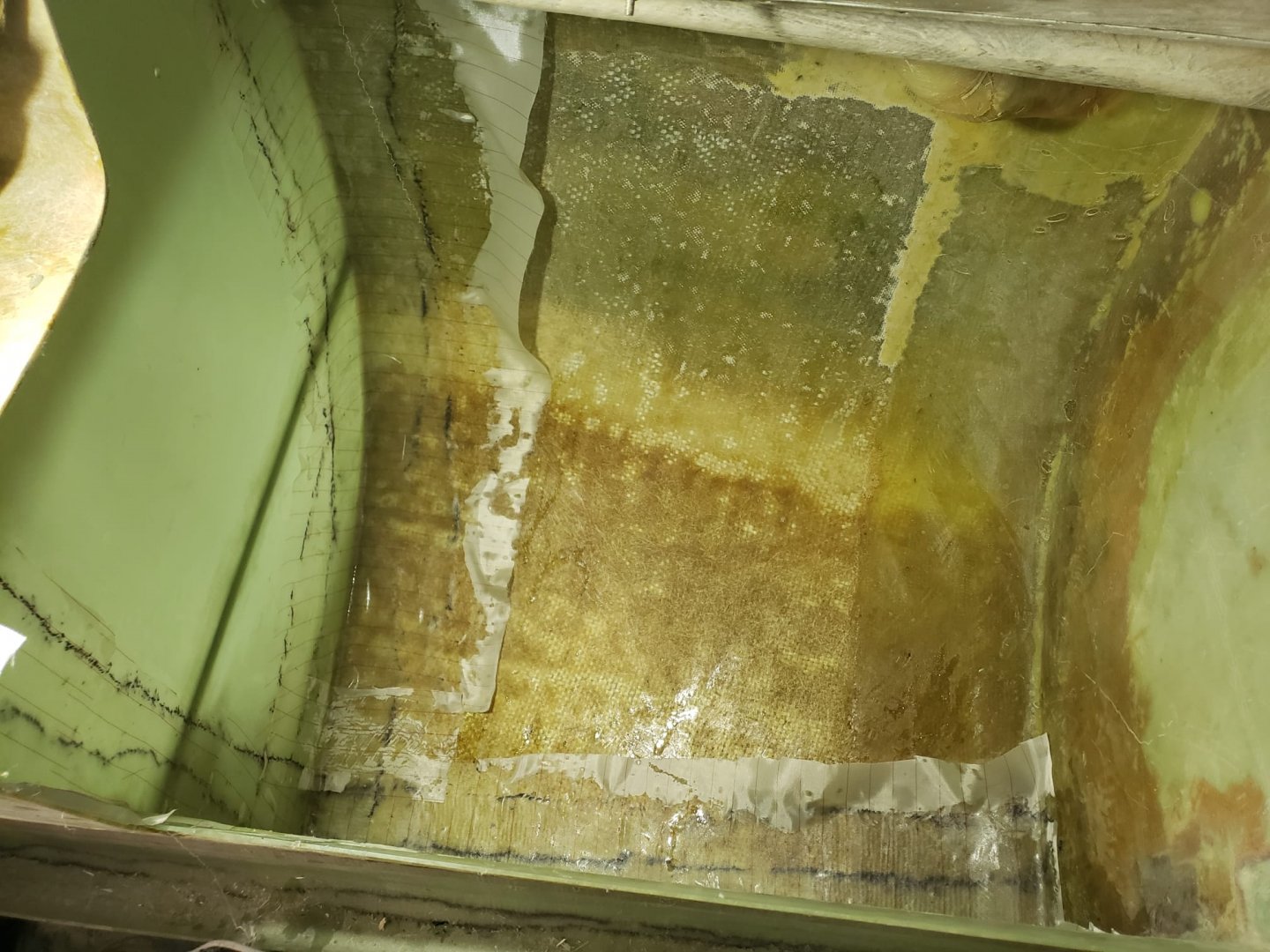

  9. voodoochile
    Joined: Nov 2009
    Posts: 57
    Likes: 53, Points: 18, Legacy Rep: 10
    Location: Macau SAR
    voodoochile Junior Member
    integral water tank works

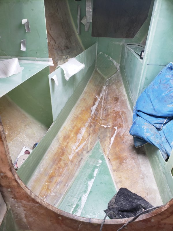

    got some pvc pipe to route the cabling from the batteries to the windlass, and to the main switch board.
    i think its a good solution, makes for shorter runs and also hides the cabling
    dry fit and after hole sawing the hole
    after glassing it in.
    had 3 layers of cloth glassed so far but im going for more. dont want this thing coming apart, having water all over the place and worst: having to build it again!
    glassed some lips where the top lid will be set upon
    everything is filleted and then 2 layers of biax cloth. might be overkill but i try to make stuff that would be load bearing in case a heavy load was dropped (me falling into it for instance)
    glassed the aft wall and the inside of the longitudinal wall

    "final" look with the lids cut out
