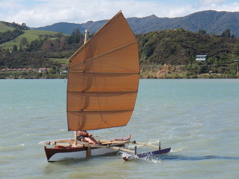

    I'm interested in anything on cruising trimarans converted to an unstayed mast with a junk rig. So far I've found only one converted to a junk rig, and it's a 3 meter Marples. There several cats with two masts, and they are quite elegant flying wing and wing. Junk rig appeals to me for a number of reasons. Unstayed mast / no standing rigging, balance area on the sail, light sail loadings and sheet loadings, instant reefing, and.....

    Heads up, even James Wharram decided junk sail weren't good for multihulls because of the increased turbulence caused by higher speeds and closer apparent wind angles. The unsupported luffs tend to shake a lot.

    The junk rig has come a very long way since Wharram reached that conclusion. The technology has not been standing still by any means, but people are slow to change their conclusions and prejudices. The flat junk sails used by Blondie Hasler, and JK Mcleod are pretty much a thing of the past except for those who don't feel the effort of making properly cambered sails worth the effort. Modern cambered panel junk sails and especially split junk rig sails are capable of taking on a very efficient airfoil shape, and driving upwind with the best Bermuda rigs, and far better downwind, and on a beam or broad reach.
    In my case, the junk rig is a non-negotiable must have as a solo sailor who insists on simple and reliable. Shredding hundred dollar bills while taking a cold salt water shower is not my idea of fun ;-)
    I intend to at least try it.......... If I can't make a junk rig work on a trimaran, then I guess it's a monohull for me!

    I'll stay with Richard on this one but it's nice to see someone trying something. Those pictures certainly look corrugated with vertical camber between battens and double horizontal camber induced by the mast. This makes things less efficient for a given amount of sail area, low area with easily driven hulls means less work sailing.
    My suggestion for the junk rig would be to go with wishbone battens and sail cloth on both sides of the mast for a true foil shape with the advantages of junk rig control.
    Freestanding masts in tris are nothing new. Newick designed cruisers that way using a rotating lungstrom rig.
    The advantage there is the sail can roll up on the mast for reefing and being a double sail it allows you to open it up to double the off wind area.
    Far less expensive to get that donor monohull though, plus with that displacement wave train you'll seem just as fast as the conventional rig in a breeze. Light air sails are a bit of a head scratcher with a junk but I imagine something with a free luff could be hoisted to the masthead.
